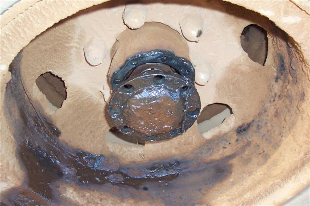

After about 30 loads of dirt, it stoped moving. I had just finished loading it and my dad said it wont go anywhere. The driveshaft looked good, but for me to take a look under it while he put it in gear. Right off, I noticed the rear axle. This has leaked since day one, and two gaskets later, it still leakes. It's one of those things that I've been meaning to get to, but since it works, but makes a mess, I let it go. Now I have to deal with it.
Anybody know anything about rear axles?

The bolts are missing. The axle splines slide into the spider gears which are inside the carrier which is bolted to the ring gear which the pinion gear turns, and that's bolted to the drive shaft. Follow me? Put the truck in neutral, first block a tire so it won't move, wiggle/slide the axle back into the carrier, put some bolts in, and drive it to your garage. To get the axle splines back in, you will probably have to push down on the axle flange to raise the shaft up to where it needs to go. You probably have a broken bolt and maybe a stripped one or two. The axle is what turns the brake drum, that's why no movement. You can steal some bolts from the other side to get you home.

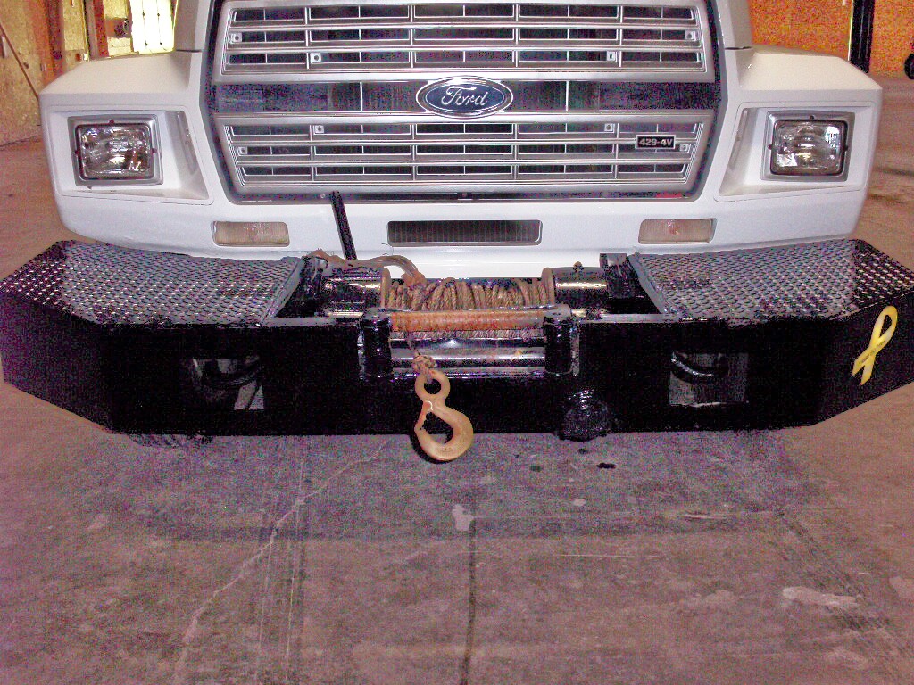

How would you like this front bumper for your Ford?

Do'nt make the mistake of using silicone instead of a gasket on the axle flange . A gasket on an axle not only seals it but also acts like a clutch plate to transmit the drive from the axle flange to the hub . When the oil gets between the flange and the hub it looses the friction component and applies all the torque to the studs which breaks/loosens them . If you can imagine how a pressure plate forces the clutch disc against a flywheel to make it grip , this is how the studs force the flange and gasket against the hub face to make it grip . Using the Silicone does the same thing as the oil , (looses the friction component) .
