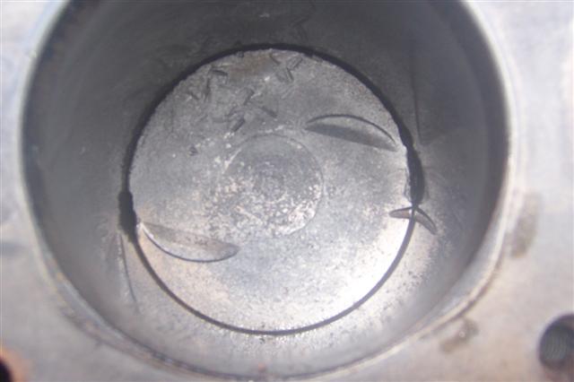

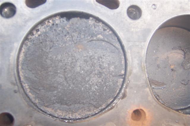

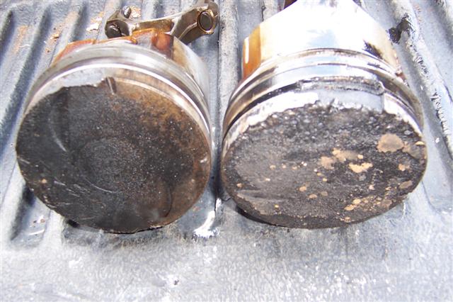

This morning we got on the engine and taking it apart. I was very curious as to what the problem was and if I needed to really rebuild the entire engine, or if it was just the top end.
Turns out pulling the engine was the right choice!!!
It would appear that at one time, something go into a few of the cylinders. Dad thinks it was the wrong spark plugs. Maybe too long. I don't have a clue.
These pictures are of the worse two pistons. They are total junk. The taper on the cylinders isn't too bad, but it's there.
I droped the block, heads, crank and pistons off at the same machine shop who did my dozer head. He will bore out the block to the next level and grind the crank down to the next level too. The bearings had plenty of wear on them too, so that will be taken care of. Basically everything will be new.

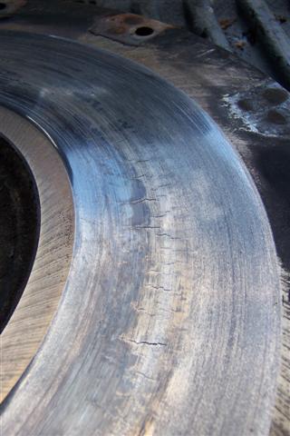

The clutch was slipping some, so that was another good reaso to take the engine out. The disk itself was worn and glazed, but not down to the rivits. It didn't have much life left in it, but a little.
The preasure plate looked ok too, but wa probably the source of my problem that I'm getting to.
The throw out bearing has allot of play and is just about shot.
The surface of the flywheel is where the real damage is. It's smooth, but full of small cracks. I've done a few clutches and engine rebuilds, but never saw this before. The owner of the machine shop looked it over and said I had plenty of material left and it would be easy for him to resurface it.
The picture shows the worse of the little cracks.

Those cracks are from heating the flywheel surface and are normal in HD equipment as well as in very high HP applications. You see that often when the operator rides the clutch, especially with a load. While the rig is down, you may want to check the clutch peddle pivot points for wear as well as the linkage. If it has hydraulic actuation, flush the system out and put in new fluid.
As far as the rebuild being cheaper....maybe. Around here you can still get BB ford engines for $200 (not often) to $500 fairly often. May be a pig in a poke, but you can pull the plugs and exhaust manifolds and tell about all you need to know.
