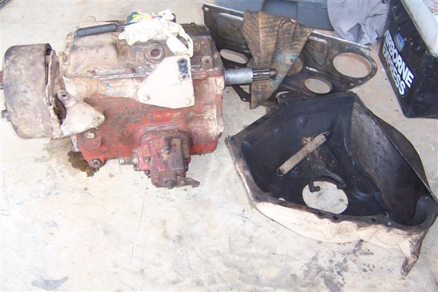

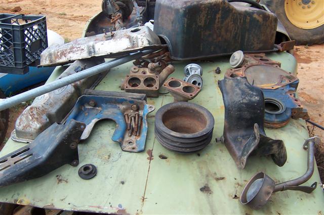

I've been cleaning a few parts a day. I don't like cleaning parts, so it's not something I stick with.
When I get the block, I'll clean them again real quick, but that wont take much. Then I'll paint it all at once.
Eddie
