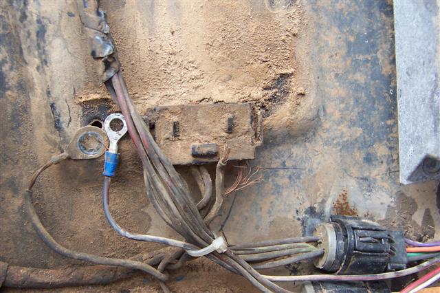

Make sure the voltage regulator is plugged in, if that is what I am seeing mounted on the right inner fender.

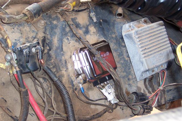

You guys got it right. Since I hadn't touched the voltage regulator, it was last on my list of things go look at. I had the wires marked for the alternator when I put it back on, but it didn't work, so my Dad changed them to a few other places without any results.
We may have ruined it by moving wires around, or it might have been bad already. I just put a new battery in it, but the problem might have been the regulator all along.
The first picture is of the plug that goes into the voltage regulator. The wires for the alternotor are the two on the right. As you can see, one just fell off and the other is pretty frayed.
I changed the ends and tried it on the old regulator again, but it didn't work.
The second picture shows the new regulator installed and working perfectly. All is good!!!

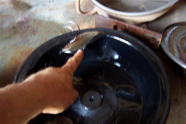

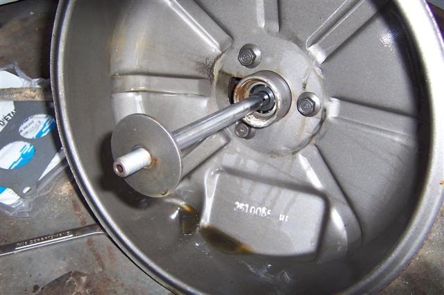

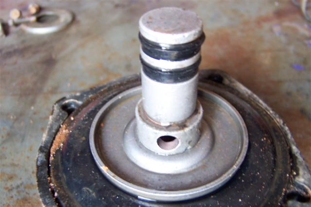

This little problem with the brakes is turning into a $300 bigger problem.
There was a cover missing off of the control valve assembly, but that really doesn't seem to do anything. Kind of a dust cover. There is also a piston that goes into the master cylinder from teh control valve that leaked brake oil. I replaced the o-rings, solved the leak, but did nothing to stop the problem.
The manual says the engine dying is because of a vacume leak in the lines or inside the vacuum brake booster. That's what this thing is called.
I took it off and opened up the shell to see what the diaphram looked like. YIKES. It's tore with a massive hole. OK, that explains why the engine dies when the brakes are applied.
Inside the shell there was allot of brake oil. It should be dry.
I took it to Tyler to get a new one, but Napa doesn't carry them. After looking around, there was only one store in town that can get one. $290 plus shipping.
This seems a bit excessive, but than again, I might not have any choice. I've been looking online, but haven't found anybody that sells them.
It's made by Bendix, and is called a Vacuum Brake Booster, Single Diaphragm, Frame Mounted for a F-600 gas truck.

Second picture is of the vent opening that came off.
Third pic shows the piston that was leaking, but isn't anymore.

Fifth pic shows a little of the oil inside the shell.

So how did it run with this big hole before??
This would potentially explain the severe were you encountered inside the engine, as it would have been dumping a lot of unfiltered air into the intake manifold.
