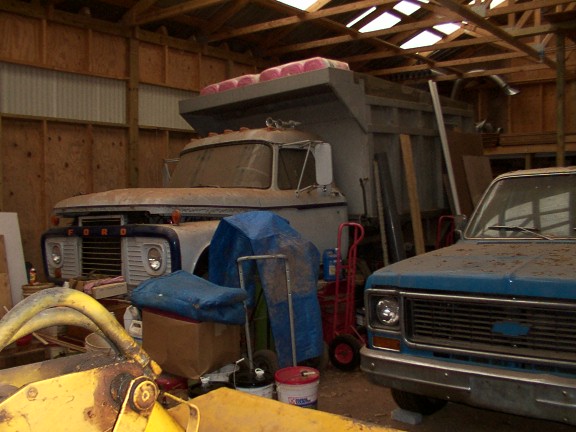

Eddie, here's pic of my 1966 Ford F800, with the Aluminum dump body, and a fresh rebuilt 391, 0.040" over bore, and a custom ground stump puller cam, 4bbl holley 650 CFM, 10 speed. Many people think it's a diesel engine due to the way it runs. Your work looks great!:)

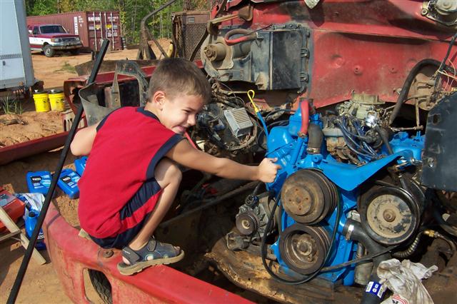

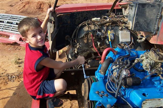

The day started out with the exhaust fiasco. Lots of prying, adjusting, cutting and bending, but after awhile it finally came together. The truck now has it's old exhaut pipes and muffler. I never would have believed it would have been this dificult.
I had a helper with the alternator as you can see in the pictures. He lives for this sort of stuff!!!!
Then the rest of it came together real easy.
I had my Dad turn it over for awhile to get oil presure, then on the first try, it fired right up!!!!!!!! I set the timing to top dead center when I put in the distributor, but the timing light showed it at 30 BTDC. I changed it to 6 BTDC and the idle went way down. I adjusted the carb, checked the fluids and figured it was time for a test drive.
The first big mistake jumped out at me when I tried to use the clutch. It didn't work.
Dad had put it together, so my panic alarm was going off in my brain, but after looking it over, he just didn't adjust it. The combination of the milled flywheel and new clutch added up to quite a diference from original.
When I drove it, one of the biggest difference I noticed was how little fuel I gave it to get it to go. It just goes on it's own!!!! It's quiet, smooth and powerful. Rumer has it I have a new engine, it's like having a new truck!!!
The alternator isn't charging and we haven't figured out why. It must be a wire issue, or it could be a bad alternator. Odds tell me it should be fine. It worked before, so it should work now. The wires were removed, so my thinking is it's the wires.
