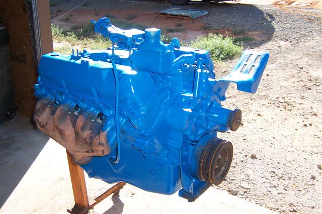

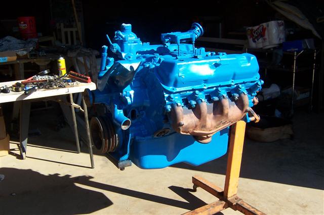

Got the block back and it's about re-assembled. Tomorrow morning it should go into the dump truck.
Cost for machine work and materials came to $1,600. That included 8 new exhaust valves at $40 each, which nobody expected. The block had to have a sleeve put into one cylinder and it was all bored .040 over. New cam, timing gears, bearings, freeze plugs, pistons, oil pump, gaskets and resurfacing the fly wheel, exhaust manifolds, plus all the labor was part of that price. I also had six exhaust bolts break off that needed drilling and tapping, boiling and cleaning the intake manifold plust they assembled the lower end. They gave me a six month gurantee if they assemble it. No gurantee otherwise. I'm probably forgetting something, but that's the basics of it.
The replacement block was $250.
Clutch, fluids, hoses, bolts, filters, belts and who knows what else was another $300.
I wonder if it would have been better to find a 460 block and put that in instead? Too late now, but in hindsite, I think that might have been the smarter move. Parts for the 370 are just too expensive.

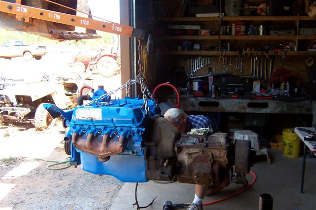

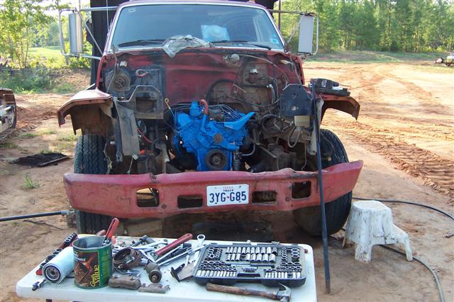

While putting the engine together, I noticed that I can see and touch the timing chain throught the mechanical fuel pump opening. Not sure if this helps, but if I'd have known this, I'd have pulled the fuel pump just to check the condition of the timing chain. I had my doubts about it, bu never imagined it would have been as bad as it was!!!
Derek,
Thanks for the tip on the 460, but I'm still breaking off bolts. Had to have the machine shop remove them from the head because almost half of them broke off removing the exhaust mainifolds.
Then while putting the exhaust manifolds on, my dad had the head come off a brand new grade 8 bolt. It went in so far nice and easy, then it just broke off. That bolt came from Napa, which suprised me. I drilled it and got it out with an easy out, but it's a pain in the butt to have to do.
Then while putting the clutch on, I had the same thing happen to me. Brand new Grade 8 bolt lost it's head while tightening it up with the impact. I wasn't tight and those threads go all the way through the flywheel. An hour later of mental anguish, and I had it out. I tapped it and it was fine after that.
The surfaces of the exhaust manifolds were so pitted that I had to have them welded up and then machined smooth. This in turn changed my angle that they sit and align with the exhaust pipes. There is no way to get them on. Since the muffler is old and rusted real bad, I've decided to put on duel exhaust. It will be easy to fit the angle of the manifolds and I'll get a good seal this way. Before the rebuild, it leaked real bad around there anyway, so it's never been a good setup to begin with.
To put the transmission back on the engine, I first picked up the engine with my tractor cherry picker. Getting it level was hit and miss. hahaha Then I lined up the tranny on my floor jack and adjusted the height. After that, it just about slid together on it's own!!!
An hour later, it was in the truck on it's mounts. That also went pretty smoothly.
Of course, Murphy showed up when it came to bolting it all down. There are two motor mounts at the front of the engine that went in easy. The transmission mounts were another story. It sits of a rubber pad that is on an angle. I had to jack up the tranny to get it to line up, but when I lowered it, the angle made it slide, which pushed the top of the rubber plate of from the bottom part. It was one of those nightmares that lasted a few hours to get one bolt in, but in the end, it finally happened.
