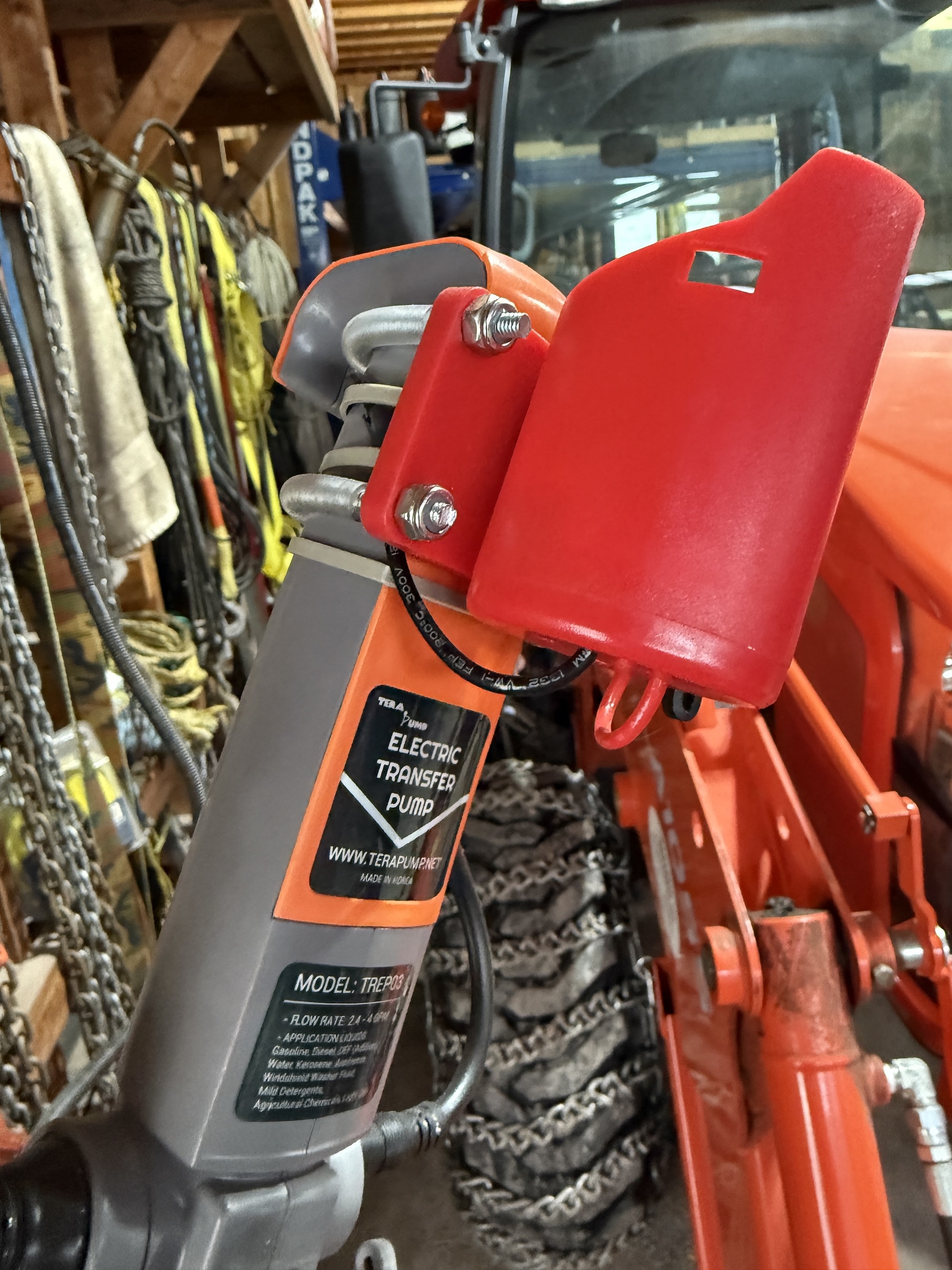

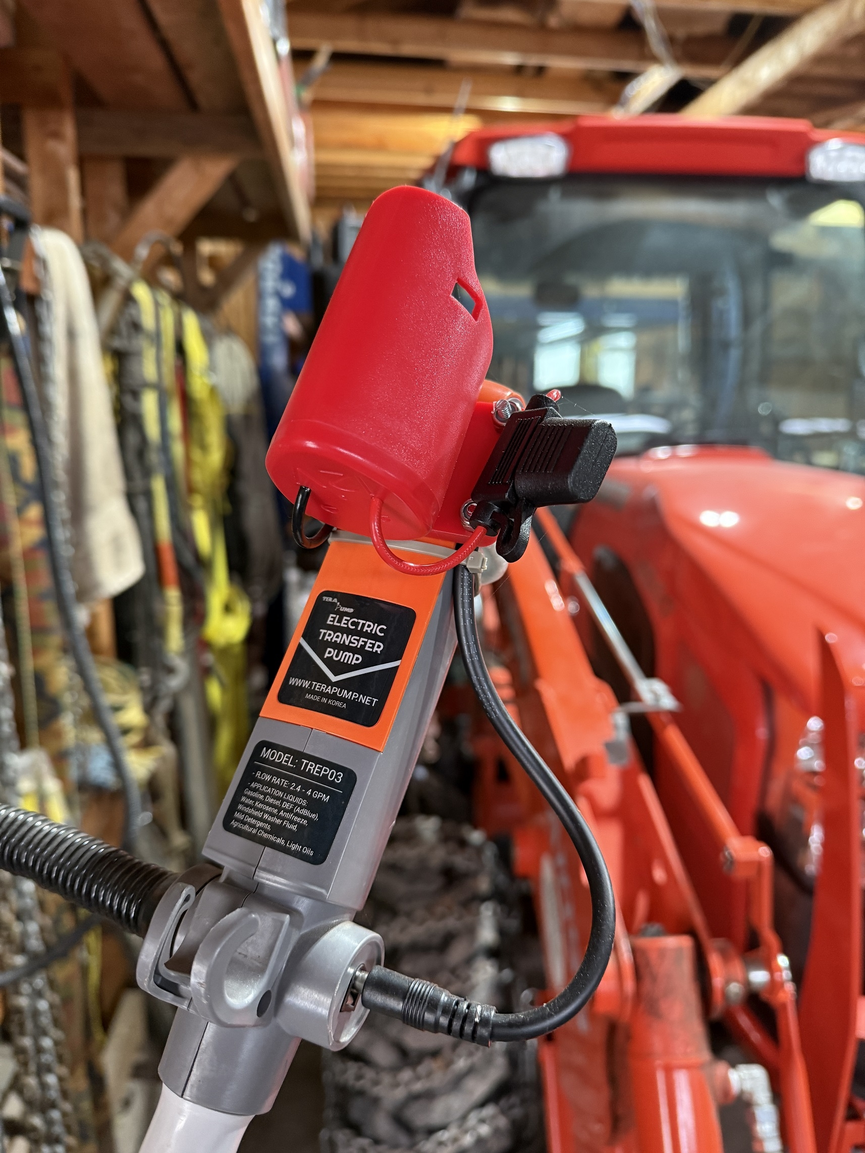

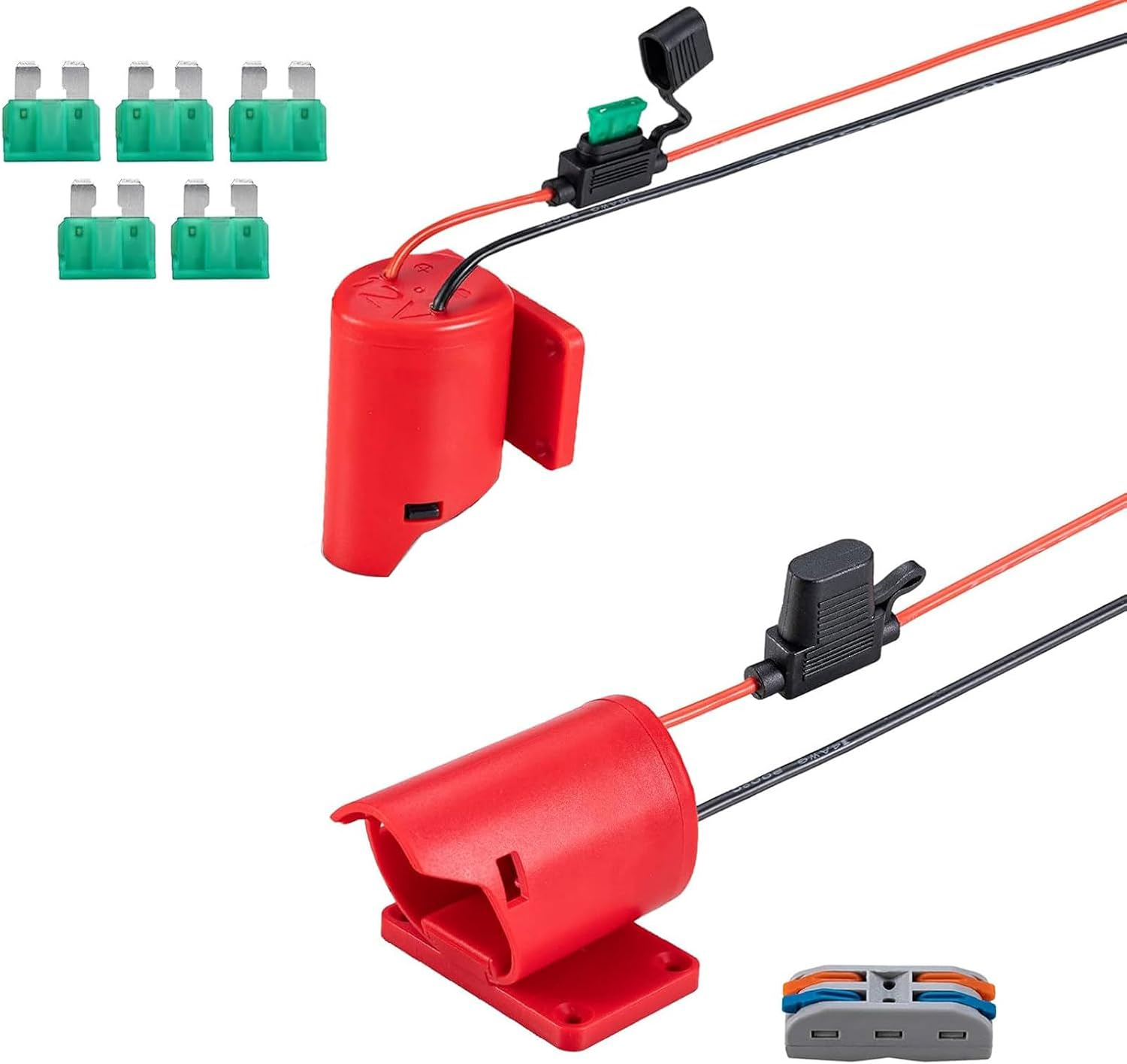

I bit the bullet and bought one of the $60 pumps. Like you, I wasn't happy with the D cell batteries so I used this adapter:
It lets me use my supply of Milwaukee M12 batteries which are always on charge.
I clamped it to the pump with a couple of U bolts:
That way, the pump is just another cordless tool.

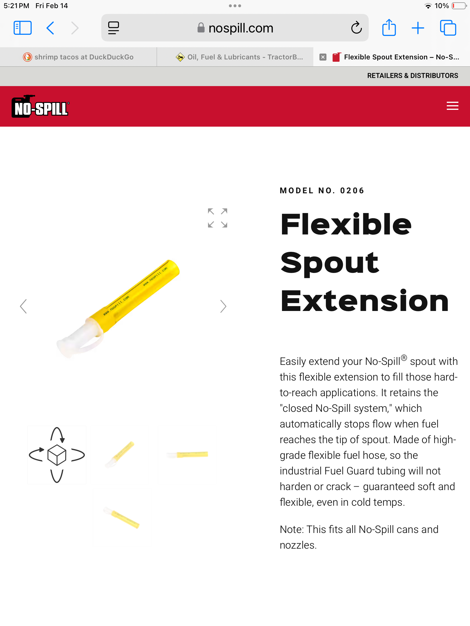

The only good fuel can that I’ve found, out of these newer designs, is No Spill brand. Just ask Jill! The rest of the new style cans have spouts that just don’t work for me.
As to speed, they’re almost on par with my late-1990’s old school spout cans having the always-too-tiny breather holes, but not as fast as 1970’s cans.
