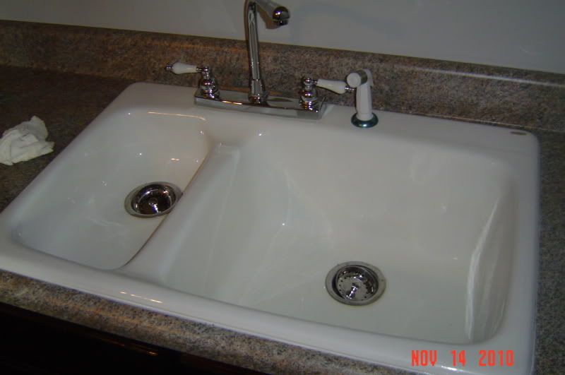

Sink with new faucet and spray. Traps installed and plumbed.

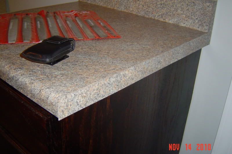

End cap for countertops installed and trimed.
You use an iron set to 300 degrees and it heat activates the glue. Once in place
you use files to trim down the edges on the top.

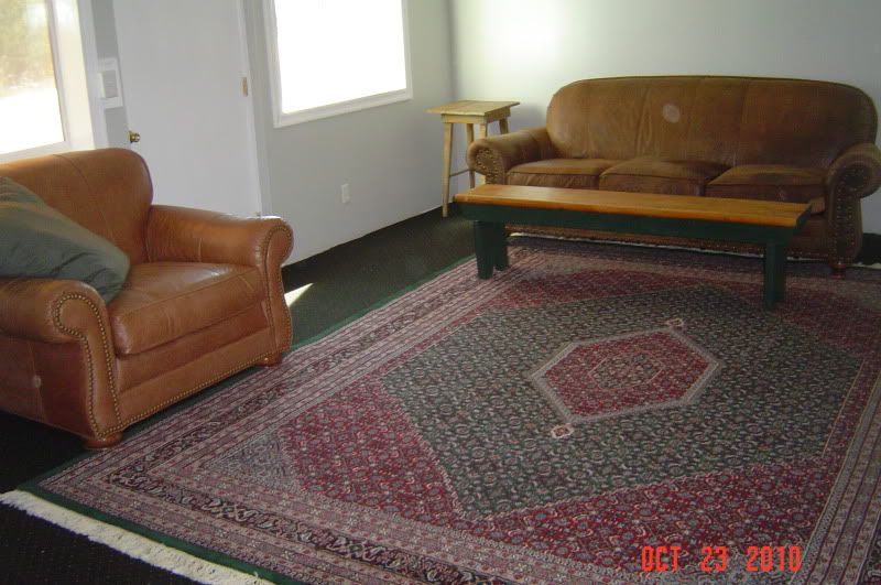

I am starting to steal some furniture from my wife. I was told the rug is leaving. It might be a little much for a man cave.

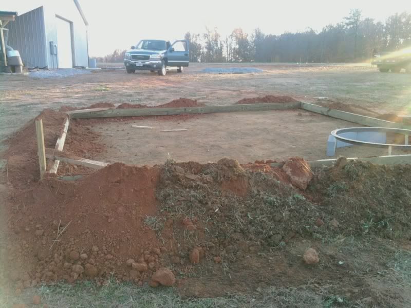

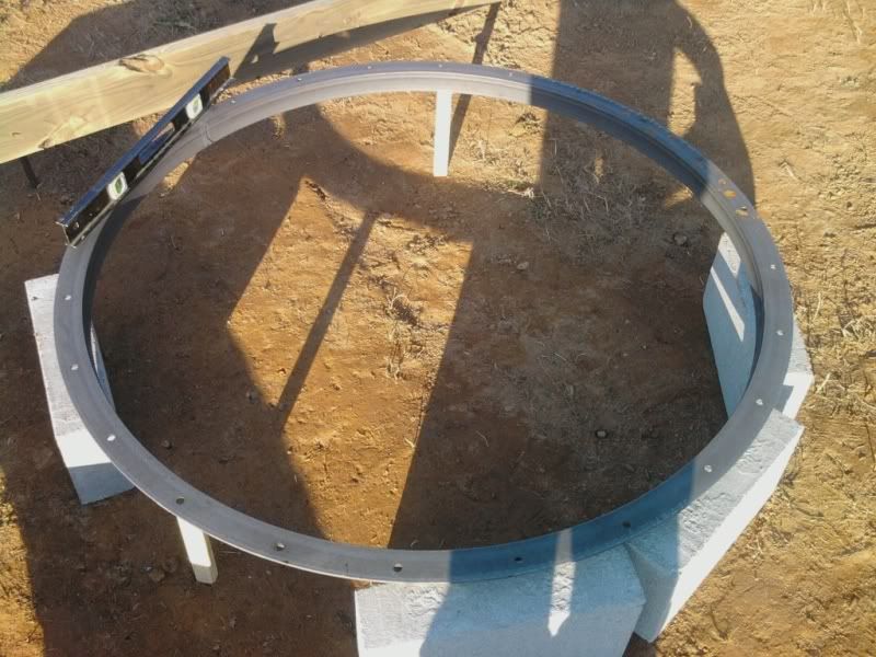

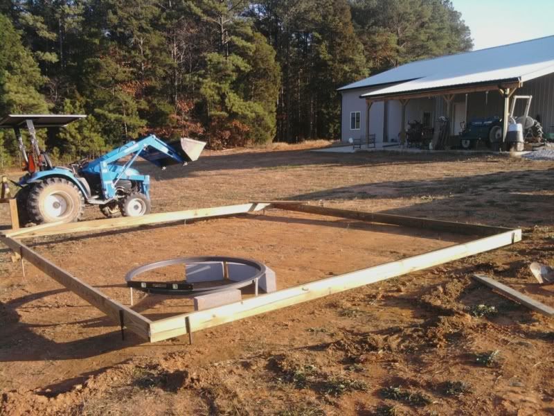

Started on the fire pit today since the clay is dry and the weather was spectacular!
I had a customer roll a ring. 4' using 1.5" angle. I am just laying the blocks to see how they would fit.
The overall size is 16' x 16'. When it is done you should only see the top of the ring level with the concrete pad.

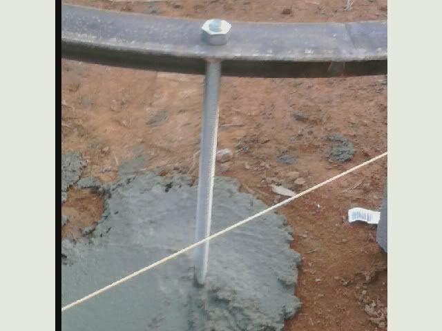

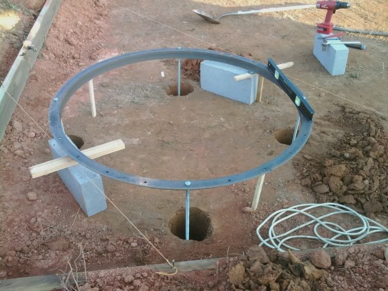

I needed a sky hook to hold my fire pit ring in place level while I try to frame out for concrete. This came pretty close to doing the job.
It will take about 5 yards.
Once this sets, I will work on figuring out how I am going to form the hole in the pit.
