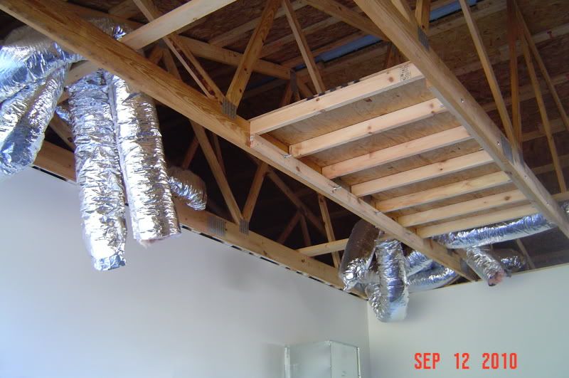

#181
Finished installing Metal Duct Work and Flex Duct. HDG is wrapped with a R-6 bubble wrap/foil. I had a HVAC shop size the duct with my 2 ton Heat Pump and Air Handler.
They need to know the area footage and room ceiling heights.
They charged $520 for the materials they fabricated. I had to cut out the holes for the flex duct adapters and hook the hard lengths together using S-hooks and drive cleats shaped like a C. The Z shaped rail or S-hooks, hooks the flat sides together on the top and bottom. The drive cleats lock the sides together and keep it from coming apart. Once you see it, it is easy to understand.
The flex duct adapters have a rubber adhesive gasket, but you use sheet metal screws to tighten the gaps and hold them in place.
12' up in the air, climbing up and down, working by yourself is a grind. It took about 2.5 days to get it all right. A helper would have been nice.
Flex duct are fairly short runs so flow should be pretty good. Unit is somewhat oversized for the conditioned area in the garage.
I am now into the AC/Heat to the tune of about $2200 and a little more to go.
Next step is the R-36 blown insulation.

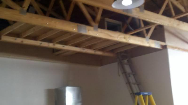

#184
Only duct work left is for the Air Supply Side. I installed a 20 x 20 lined supply box with filter screen. I am going to come out with an 18" collar and flex duct back into the air handler. I have one of my customers fabricating a box 24 x 48 x 10 with a matching 18" collar. I will have to make the cut for the box into the air handler.
18" fittings look really big in person.
You can see the supply side of the air handler that I have to connect to sitting up top.

#186
Finishing up the duct work. I had a shop build an insulated box 2' x 4' x 10" with a 18" connector for the incoming supply air. Then I matched the unit and cut a hole 9" x 20". It ends up be a giant 90 degree turn.
I had a tight fit because of the trusses. You can see what little room I had to work with.

#187
R-36 blown in.
You can see how it covers almost all of the flex duct and even the hard duct line.
The hard line is a giant T feeding off the Air Handler.
I have a small electric oil filled heater. I cycle it on and off 4 times per day. The High and Low Temps inside the 800 square feet insulated hold between 40 and 50 degrees. Outside temps really have not made it vary much. Inside the uninsulated garage the High and Low Temps have been running from 19 to 54 degrees.
