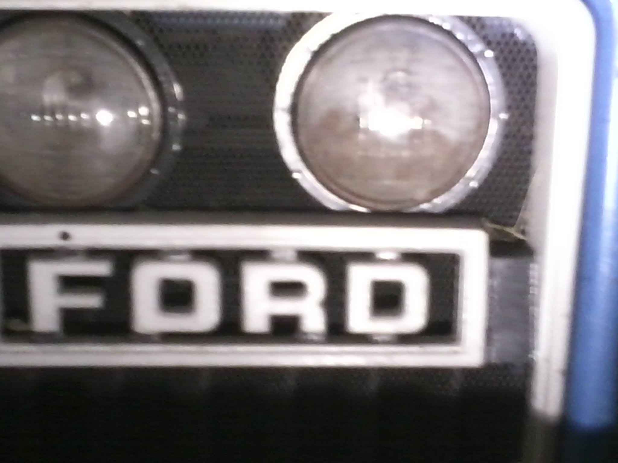

The battery box was totally rotted out, so I had to rebuild that. The front, bottom edge of the hood was also badly rotted, and must be repaired. The steel mesh in the grill was pretty rusty, so I decided to take the grill apart to clean it up. Unfortunately, the headlights are also all rotted out, and I broke three of the six mounting studs for the headlight bodies. There just is not too much left to try to patch together. New headlights are still available, but are $126 each! Does anyone know of a suitable replacement light?

Thanks for the reply. My issue isn't with the bulbs, it is that the chrome rings, and the actual base, which are rotted through. Between years of me not covering the grill opening totally with the canvas, which let the weather in, and the acid fumes from the battery, the lights are pretty much toast. I need some type of flat mount lights to fill in the holes in the grills.

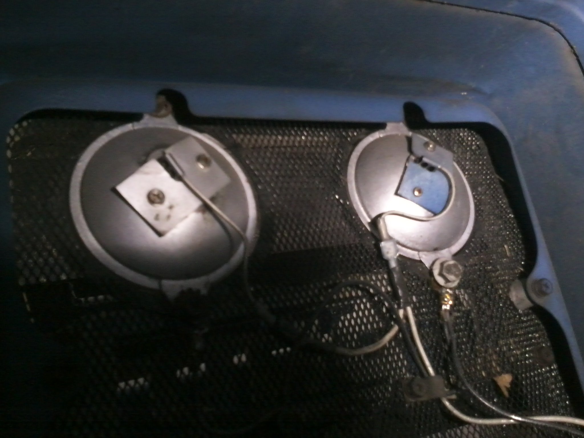

No I did not do anything quite that creative. I also restore old motorbikes so you can imagine some of the things I have to fabricate. I bought cheap sockets that were a little bigger than the hole in the reflector, put in the halogen bulbs and used small sheet metal screws to attach homemade base plate holders to the reflector. I think I might have used beer cans for that. I'll get a couple of pics in the morning. I do know that I rewired all the lights with 14ga stranded and soldered every spade.
   / New Guy with a Ford 1700 #39

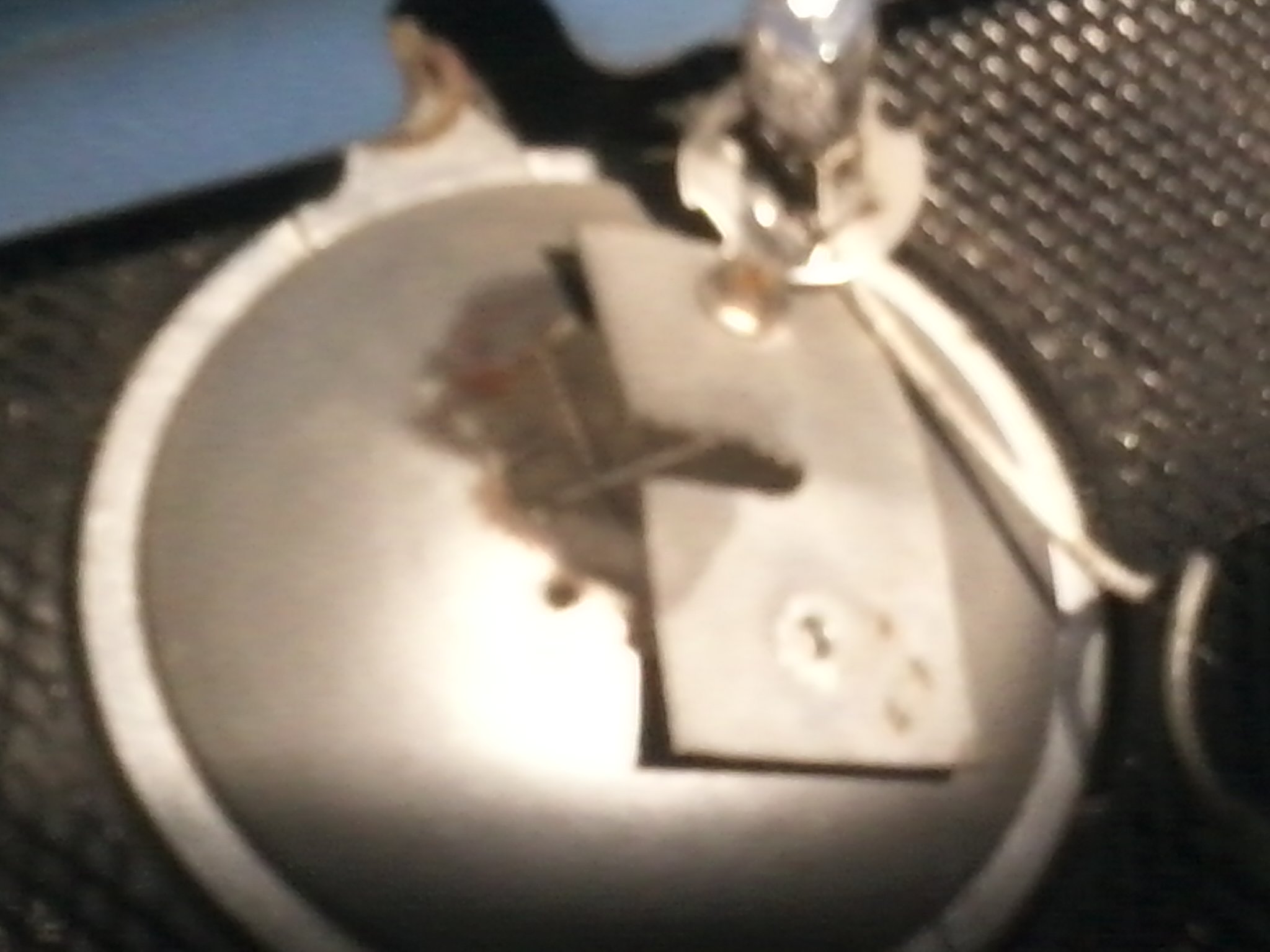

Here is what I did. Not beer cans but close. Pieces of scrap 1/16 aluminum and self-tapping computer case bolts:
The bulb is one sold at AutoZone that has a spade already attached and a large chromed base:
If you look closely you can see my reflectors are quite rusty:

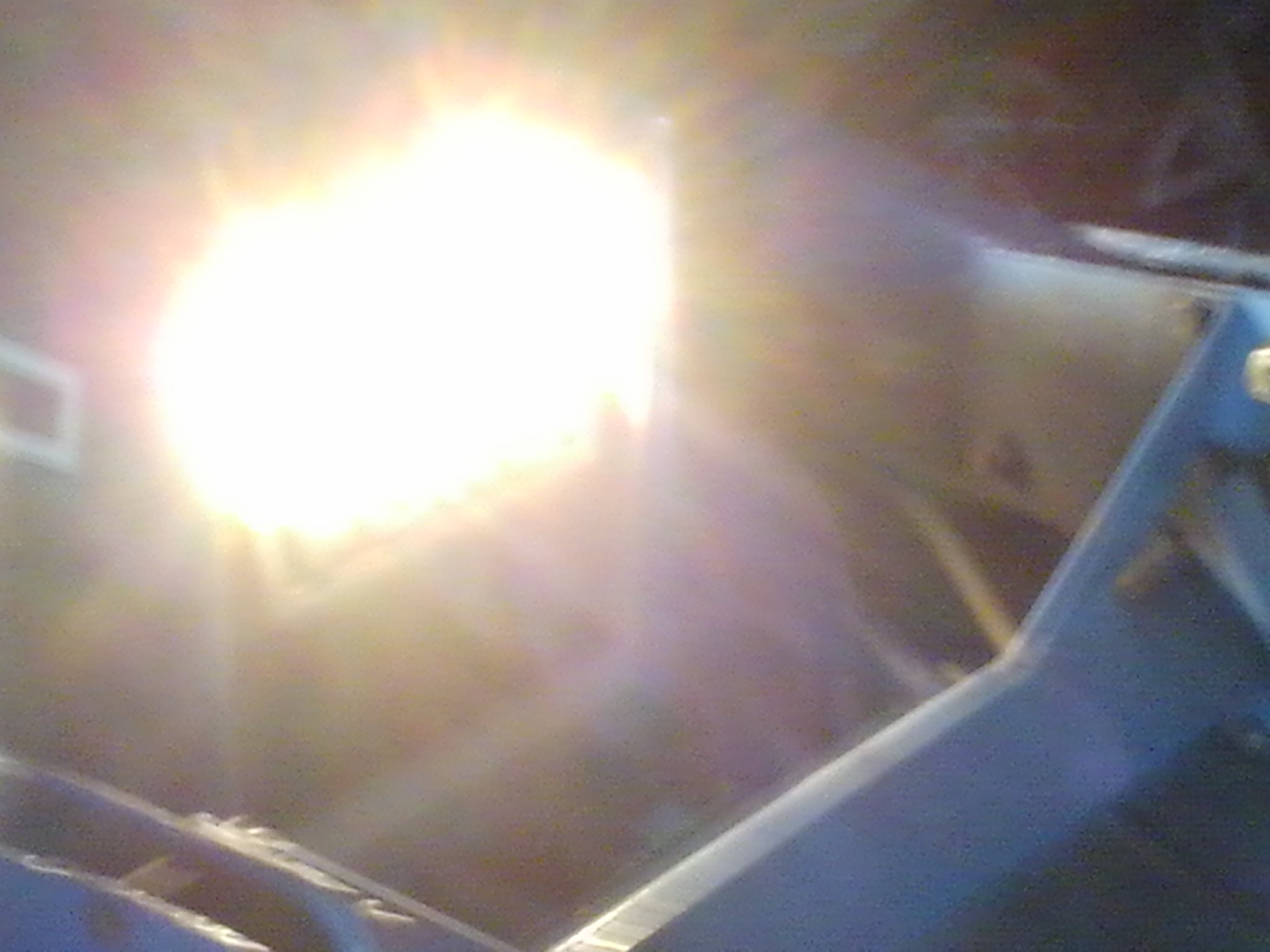

The halogen bulbs more than make up for the rusty reflectors- brighter than when new:
