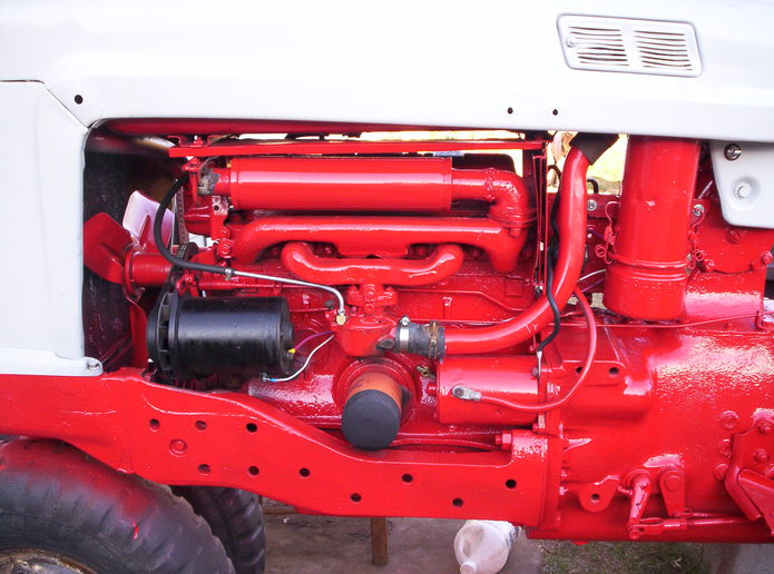

it's probably vacume, rather than pressure.. though could be pressure if you don't have heat shields in place and are getting some boil.
hunting is generally 1 of 2 thigs.. 1, fuel obstruction / starvation... if tuggin ghte choke helps the hunt.. then it's starving.. a vacume in the tank will do this.. loosen the cap..e tc.. otherwise.. it's a misadjusted gov spring / linkage.. or worn gov.
for the gas cap.. drill a hole thru it, then install a pop rivit in the hole.. make it wher ethe pop rivit is loose and can jiggle.. but not fall out.. that will let air go in and out.. but keep a 'sploosh' of gas in when sloshing.. ;)
do make sur ethe heat shields are in place

I don't believe I have a heat shield on it. Nothing but tank above the muffler...And just the front and back tank supports...:(

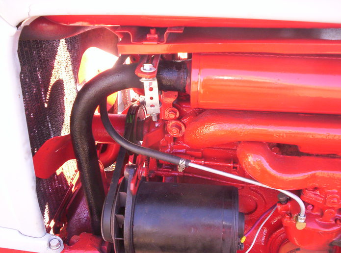

yep.. there is a flat panel that goes above the muffler.. ther eis also a side flap that should be ont he fuel tank support..
   / New here w/ Ford 861 #79
ps.. you can make that above muffler shield from roof tin, if needbe.. I have....
look these pics over.
I made 1 of the shields.
notic e the panel atop the muffler, and behind the elbow.. can make out baffles byt hte elbow if you look hard.
one of I made.. the other 2 are originals..

That's funny, I was just out looking over some roofing tin...
Maybe boiling fuel was the cause of the surging/sputtering I had after 90 minutes of mowing last week??? That would be fortuitous---simple fix...
