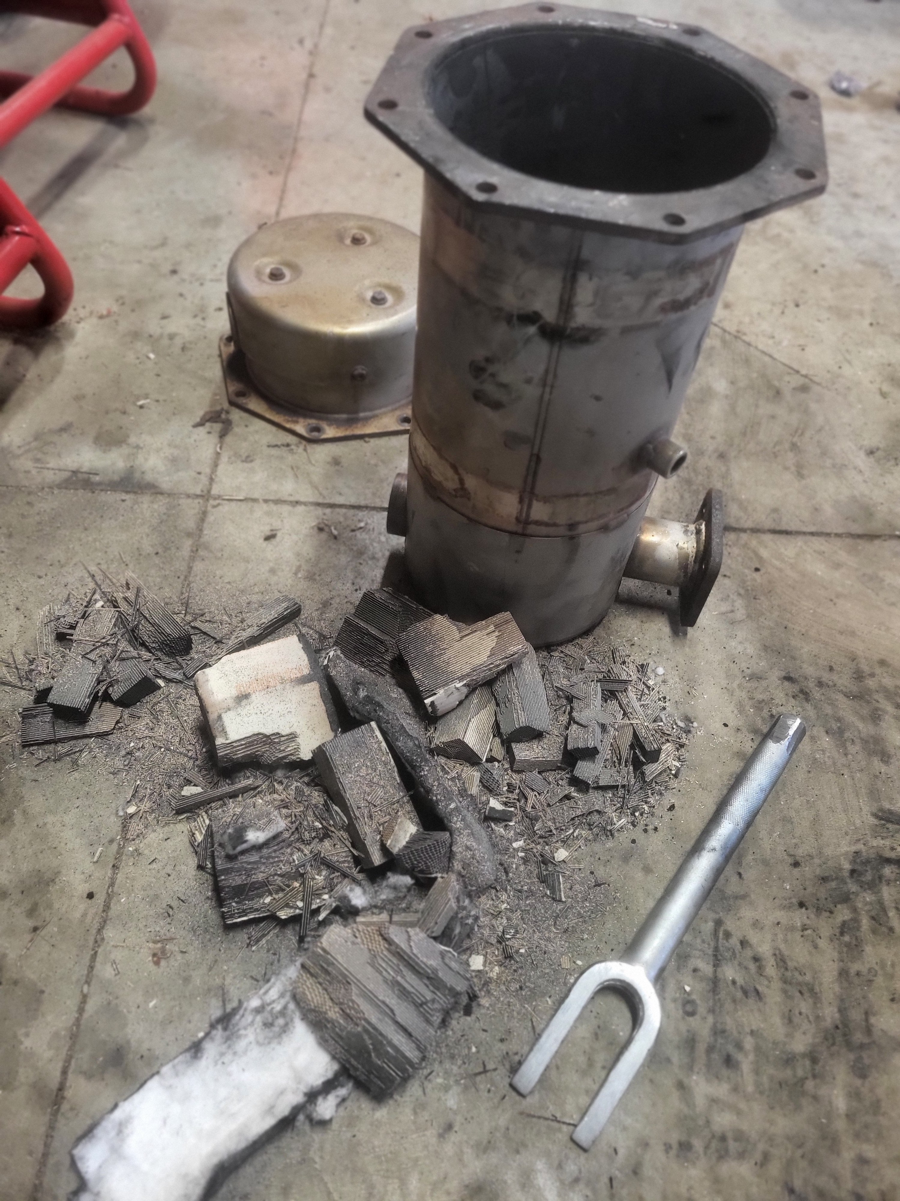

Thanks for the replies. I discovered that a pickle fork and mini sledge guts the rear can in less than a minute . Havnt hooked up the new throttle/ governor cable yet but I did fire it up. Someone mentioned earlier that once the glow plugs are warm and turning the key to crank it it won't turn over. That is correct . The key needs to be turned/ recycled into the OFF position first and then turned again directly to start position. It fires right up and what a enormous cloud of black soot blew out . Wow. The motor went directly to max rpm since I havnt touched the governor yet . That's predictable. Once I get the cable on I'll post an update. So far this is promising.

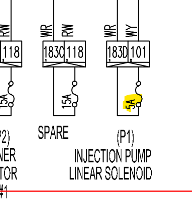

Quick question guys. I been following this thread and am about to gut the can. Is the constant 12v going to the newly hotwired/bypassed solenoid from my ignition switch going to cause problems? I'm seeing in posts a 5v source is required . So I'm confused. I don't want it getting fried and suddenly getting stuck open or closed. Thank you
Nope, that's a 12v circuit. May want a 5 amp fuse, since that's what was originally done. The 5v circuit is the rack position sensor, the 3 wire harness coming out of the solenoid.
"1. The 5 amp injection pump linear solenoid fuse sends current to the injection pump linear solenoid. When the
solenoid receives current, the solenoid opens and allows fuel to flow to the injection pump."
*boomer 47*

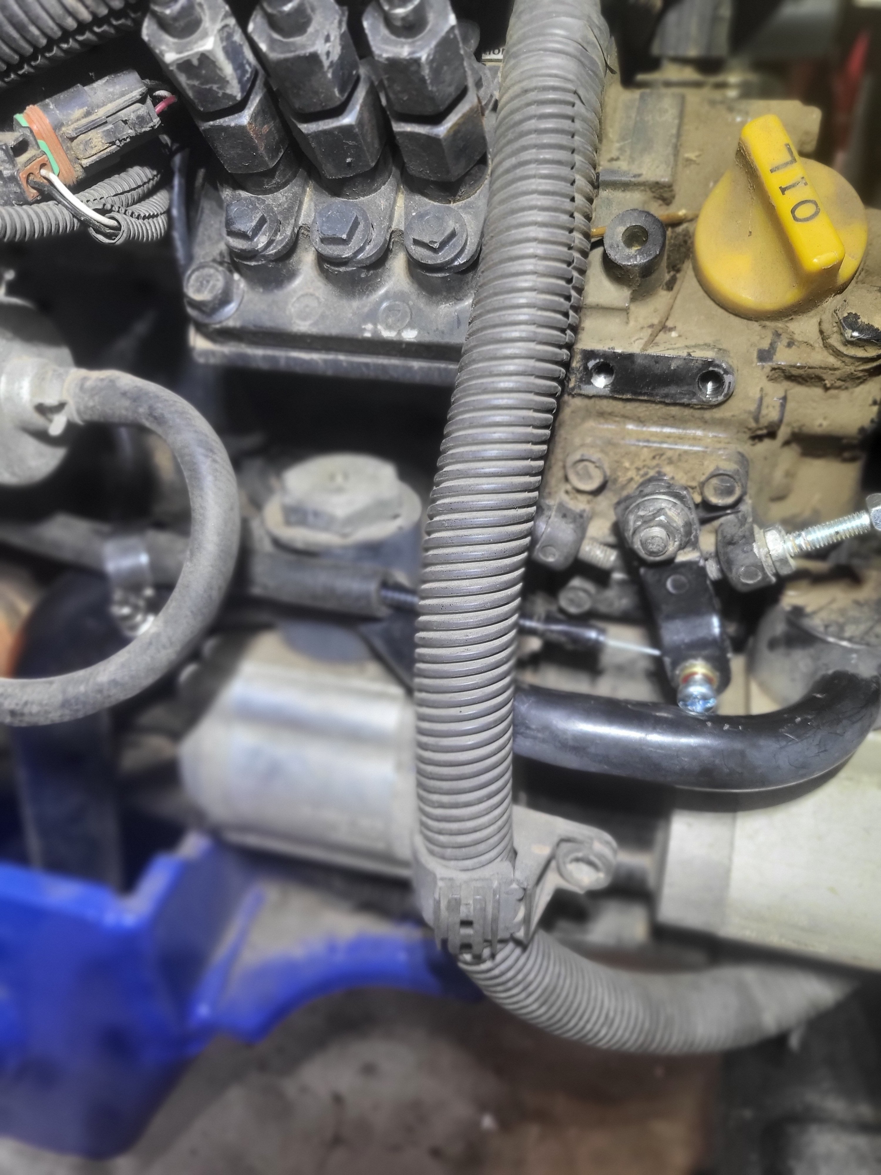

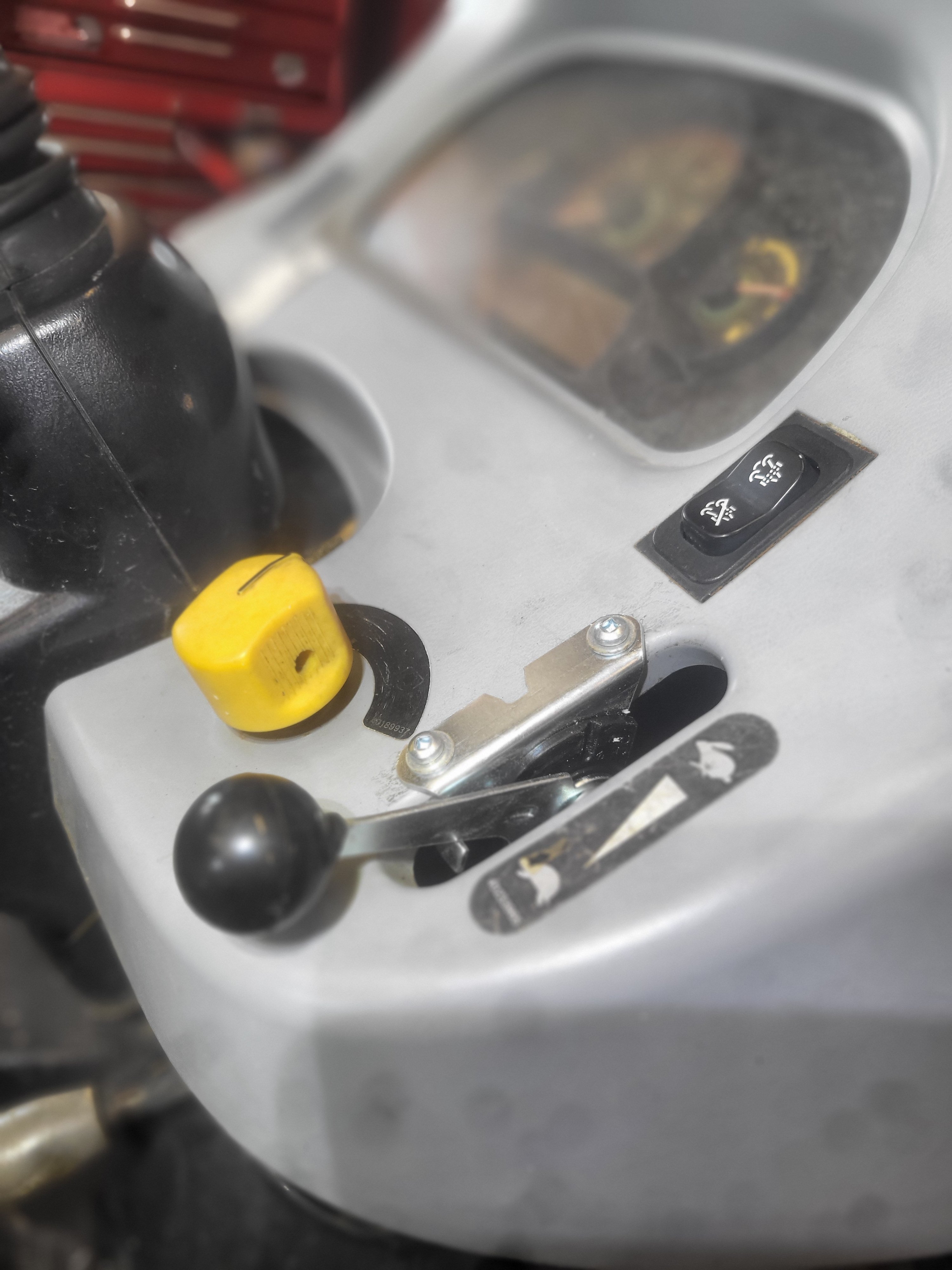

Here's the update as of today. Tractor runs great. I ran the new throttle cable from the rear facing side of the governor. So it pulls, not pushes. I slid a rubber fuel line over the cable housing where I clamped it down on the black pipe.. This protects the cable and easy to adjust. High rpm adjustment screw was not touched. Only low screw . I set idle at 1000rpm. . I gave the tractor a good run across the farm and did some work . Power is excellent. Dpf and service warning lights naturally still on. That's not a concern..
