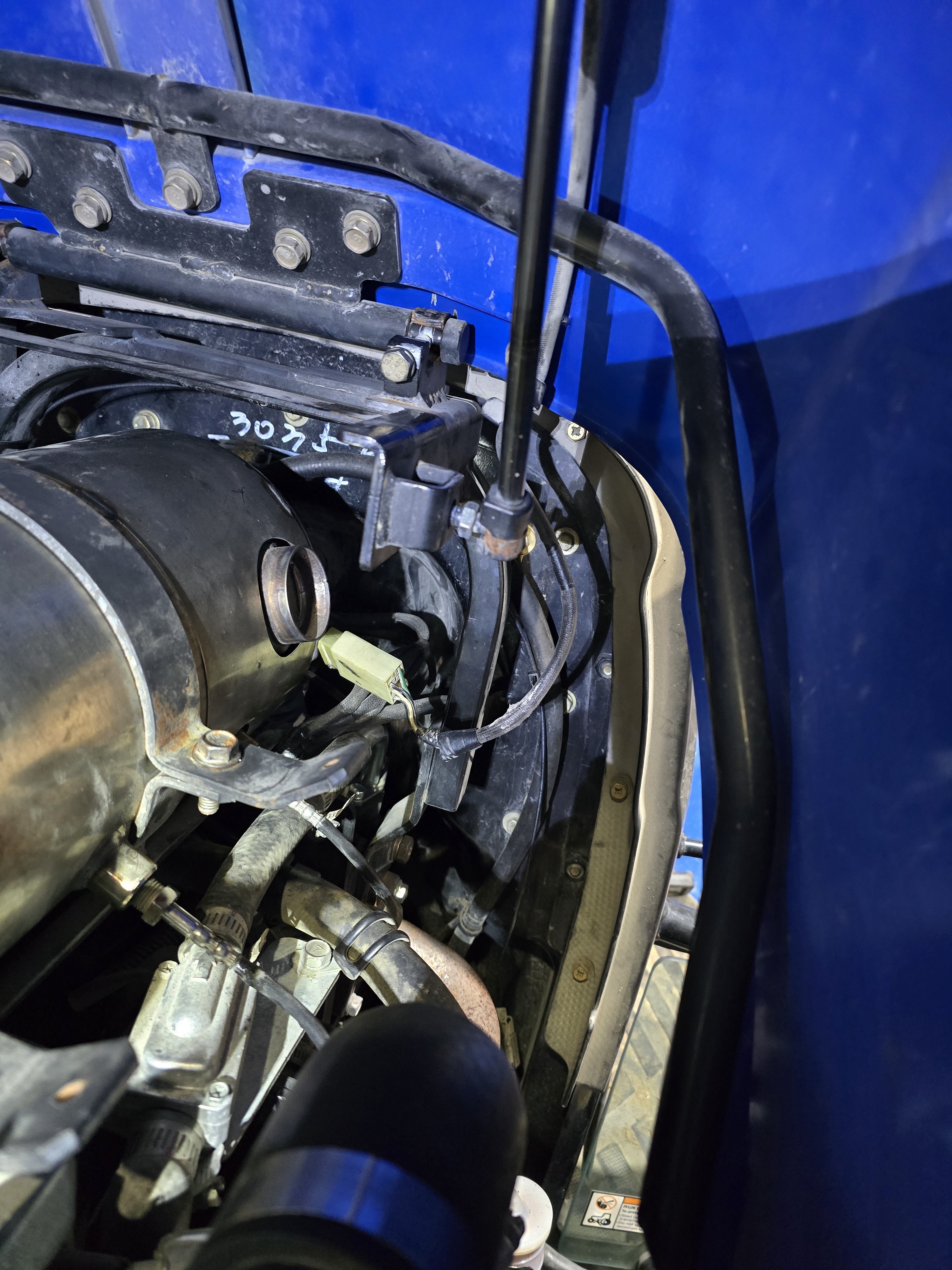

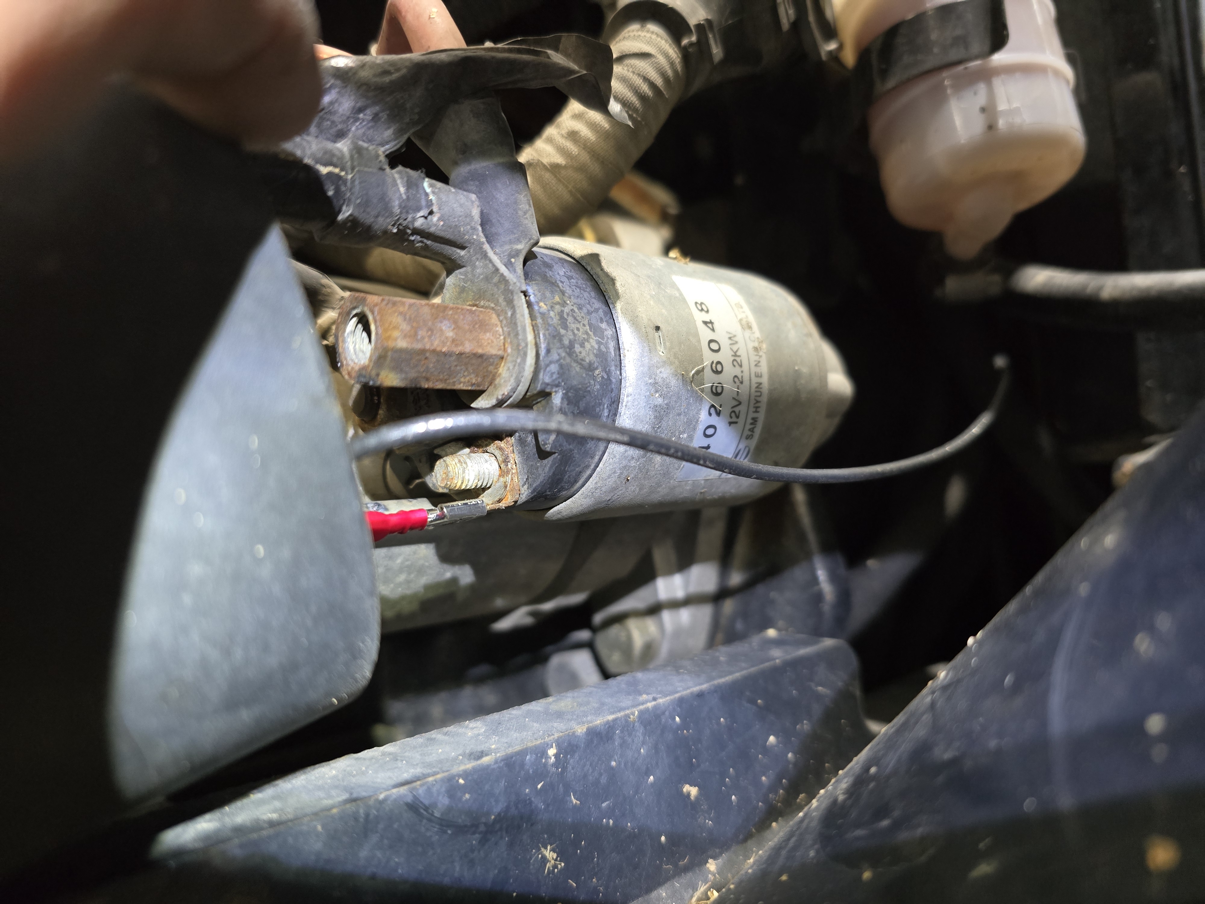

Did the delete today but unfortunately it won't even attempt to crank when turning the key in the ignition. Planning to check fuses in the morning but not sure where else the problem might be stemming from. Anyone else have that issue when first doing the delete? I'm hoping it's something simple I'm missing - did everything that was shown in the youtube video.
   / New Holland Boomer 37 in DPF Shutdown Mode #107
All your safeties in the right position?
   / New Holland Boomer 37 in DPF Shutdown Mode #108
Read through the service manual and checked the safety switches. Unable to find a blown fuse or faulty relay but it would start and run fine when circumventing the factory harness on the starter. Just elected to run my own wire from the start position on the starter to the start lug on the ignition switch. Used a couple zip ties to run it up and over right in front of the firewall and in through the same hole that the new fuel solenoid wire and mechanical throttle cable went through.
So if anyone else runs into the issue where it simply doesn't crank, there's your fix.
