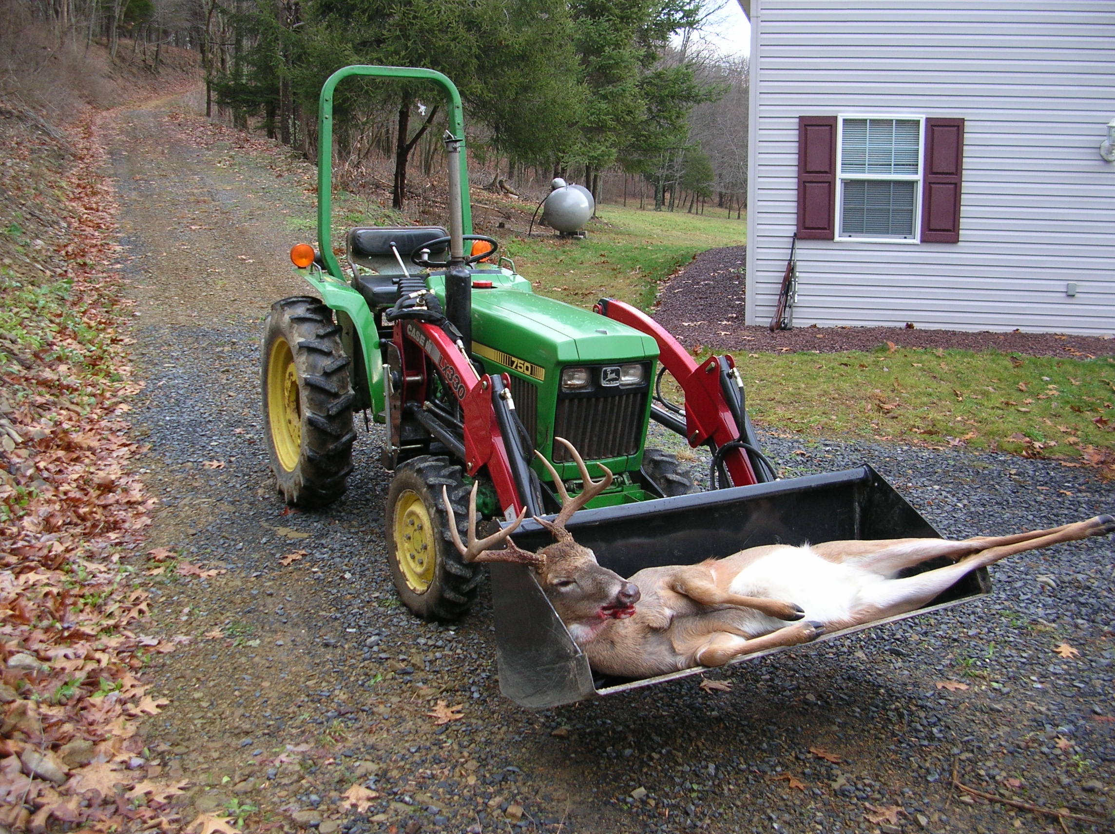

Here is a picture of the Buck that I shot during rifle season at the cabin last year. I would love to get one like that with the bow, maybe someday.

Hey! That's a nice whitetail! What did he dress? 160? 170? :confused: Nice looking set of horns. When I see ones like that while bow hunting (not very many) I seem to lose all ability to "focus, draw, anchor..."!!:D
There's nothing like it. You get so close to them before you shoot. You can really "feel" the thrill of the hunt a lot more. I've had them walk so close to me they were almost too close to shoot!
My son's already bugging me to go hunting. He's only 9 and weighs 100 lbs already:eek:. I'm gonna teach that boy to hunt bear with a club if he keeps growing like this! :D
