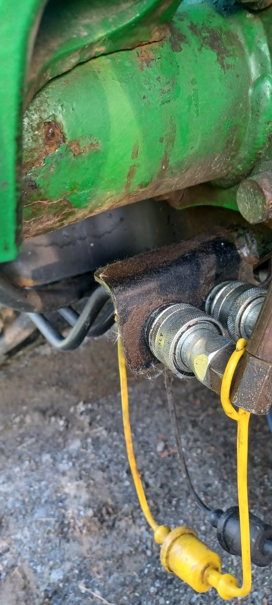

I'm thinking this is a quality problem. I'm not trying to brag up a different brand, but here is a photo I took two minutes ago of the bucket fittings of my tractor. It's a 2016 tractor that was used only for salt spreading and snow removal before I bought it two years ago. Severe duty! You can see the rust on the green painted parts, but please note two things: 1) The black painted steel hoses to the bottom left... They were dealer replaced just before I bought it as they were severely rusted, and 2) The lack of corrosion on the original, stock, plated hydraulic hose fittings.

Yes, the condensation on the painted steel is indicative of salt residue that collects moisture depending on the dew point. Even in a heated garage condensation can form on surfaces if the dew point is not in your favor. We like to blame failures on imports, are those same products suffering failures in their home countries? As potential owners we are tasked to obtain the provenance of goods purchased. Are we buying from reputable individuals?
Try parking indoors in a heated garage
Look at the condensation on your painted steel...this is an owner issue, not a K issues the condensation on the painted steel

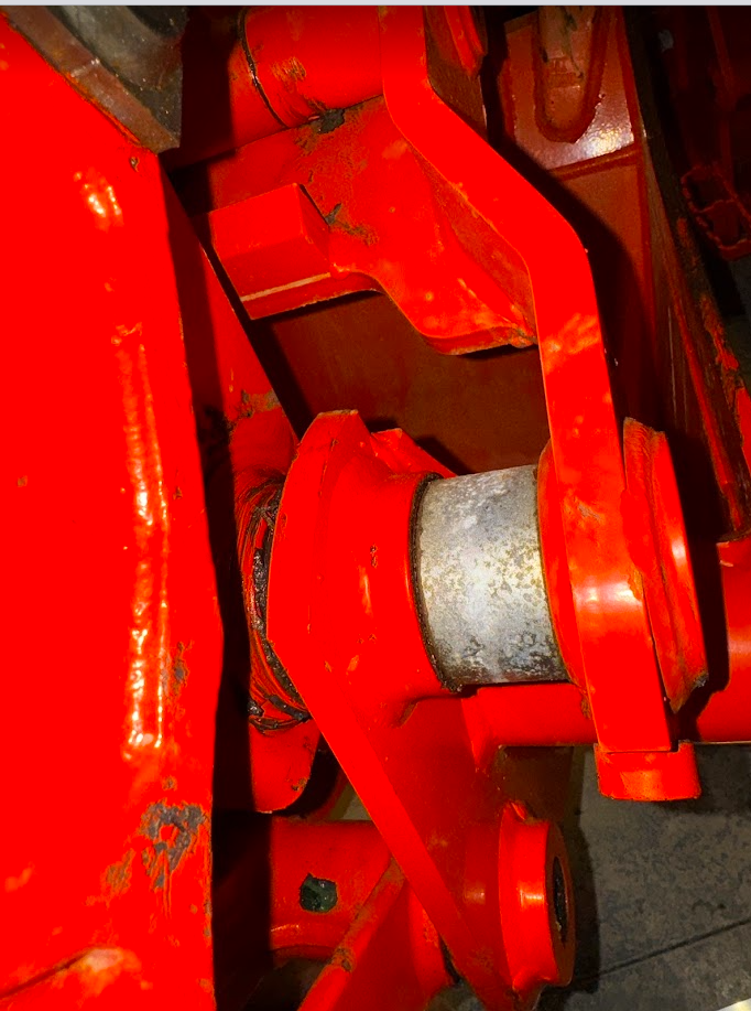

Wow, a lot of posts, thanks for input!
I do not use anything on the tractor other than filtered house water and car wash soap... I shouldn't have too, it's brand new and doesn't see livestock, road salt or anything corrosive. No caustic degreasers or special solvents. I've litterlly washed it maybe three or four times. In the original photos I took, that was and oddly warm humid morning in the beginning of May, everything had condesation on it. The barn I stored it in over the winter gets quite good airflow as one side on bottom level and one on the second story is open.
To reiterate, I have a bunch of other equipment in the same space that does not exhibit this corrosion.
The corrosion is the worst on the hydraulic parts. Most of the zinc plated parts on the bucket and backhoe only show slight white oxidation marks. Under the cab and by the FEL connections are the worst. Under the cab, I don't think the dealer installed a painted 3rd function valve, there isn't a spot of paint on it. I'll be asking them to fix that along with the FEL connections.
I don't think this is galvanic corrosion, or at least not yet. It really looks like the tractor was exposed to something that didn't wash off, in combination with poor plating. I will update the post when I hear back from the dealer. Thanks again.
