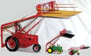

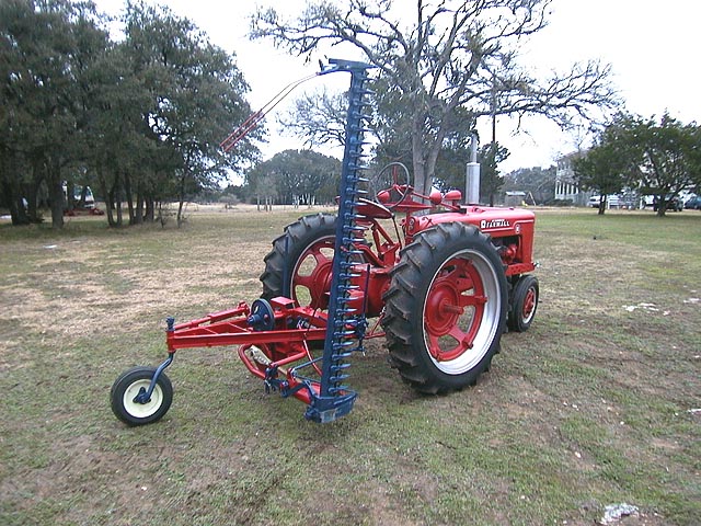

Haying for a few acres may be easier than you think. Just revert back to some methods used prior to baling. One method would require a sickle bar mower, side delivery rake [ tedder if required] and your tractor with a set of forks made for the loader. Cut, rake into windrows, pickup with the tractor and dump in the storage area. The storage should be covered. Tarps will do as long as there is a little air space between the tarp and hay.
Prior to bales this was a pretty common method only the tractor had a different type of loader that would lift higher. Stacks were made in the field and then a stack mover was used to bring in the entire stack of hay. Picture of tractor and farmhand attached. Note: for haying a wider and longer set of forks were used.
A lot less work this way than the small bales. In many cases the stacks were made a little smaller, loaded onto a feeding wagon that had a sickle bar to cut off slices of the stack as the farmer drove along the feeding area.
Note: my haying experience is limited to to fairly dry weather conditions so things may be different in your area. [I did get to spend many hours on a horse pulled dump rake during haying season.
