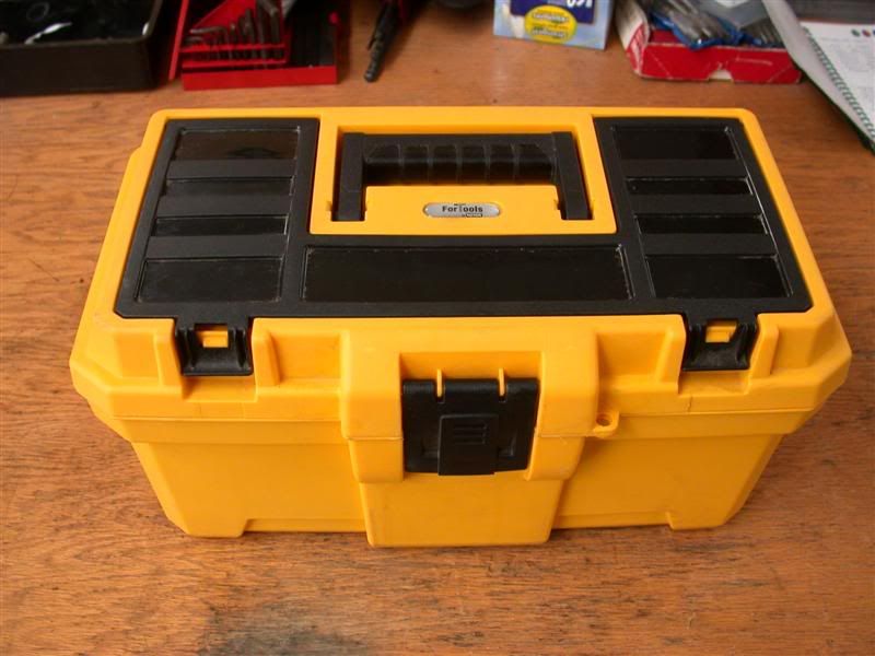

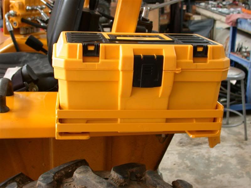

But I did get to making a mounting bracket and putting a tool box together for Loretta.
There's a little bit of everything in there including one of my trusty Zippo lighters.
Below shows the bracket and how the tool box fits.
Believe me, it's not easy making a "girlie" looking basket that can hold 300lbs.:)
It actually came out looking pretty good, I think.
Loretta liked it.

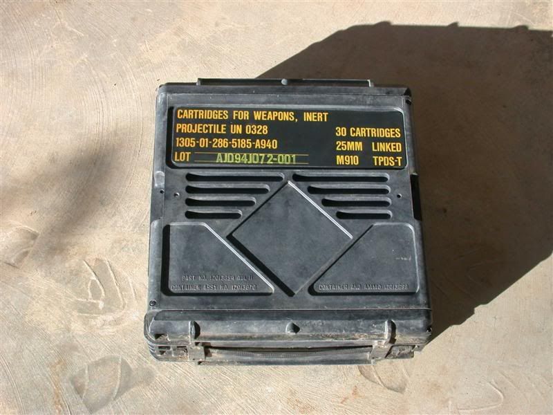

Well, today I finished up mounting the Chain holder tool box.
This was very important to me since Larry gave me these so long ago. They are excellent 25mm Bushlink Chain Cannon ammo boxes, for like what my son used to shoot in Marine Corps. He was a gunner on an LAV.
The ammo box has 2 lids which are water proof. They open form the top and bottom.

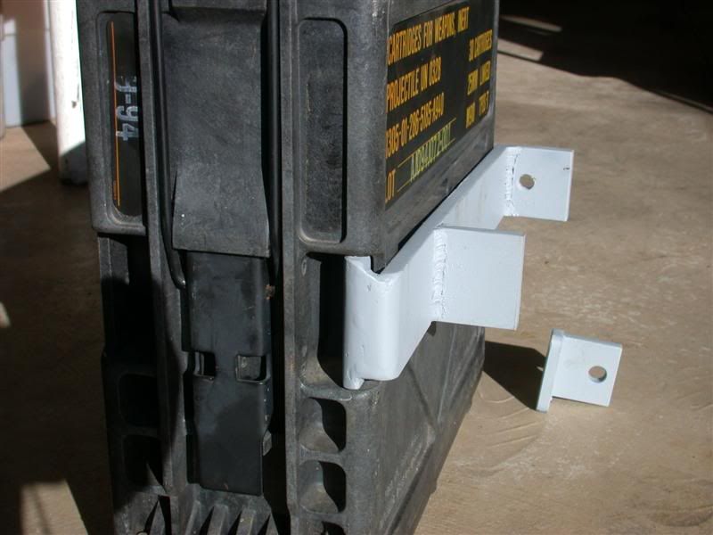

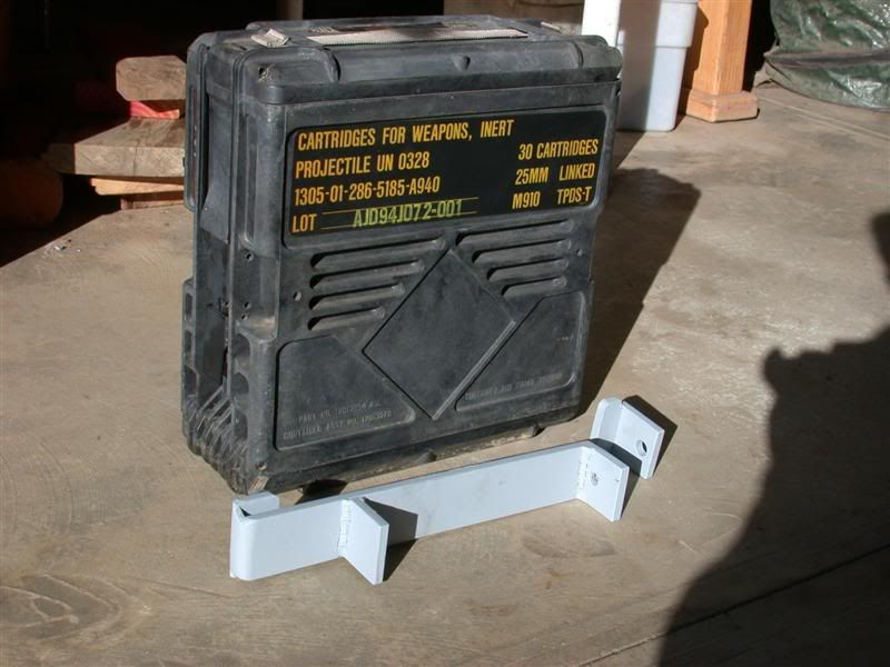

The mounting bracket I made was pretty cool I thought.
Larry would be proud of me so I'm going to share a little how they work.
I used the 2 pieces of steel Larry sent with them to clasp the ends. They fit into a recess on each end of the heavy duty box. My bracket suspends the box away from the FEL upright mount to clear the FEL disconnect pin. The bracket is made of 2 pieces. You slide the box onto the fixed end of the mounting bracket and bolt the other clasp on. I made the bar 1/16" shorter so that when the bolt is tightened, it squeezes the heavy wall plastic and holds it very tight.
