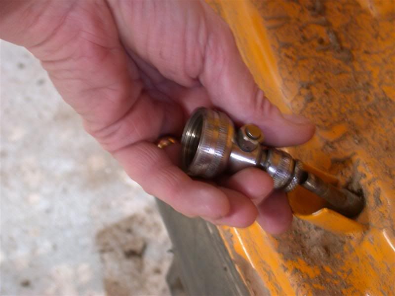

Rob, You said fill the tires, with what. I know some use calcium and others use water. Richard

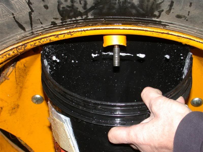

Hi Richard,
Glad you asked. Most guys are using either windshield wiper fluid or Rimgaurd, which is a beet juice.
Those are environmentally friendly filling agents. Since our tires are tubed tires it doesn't hurt to use calcium like it might with tubeless tires. I think, depending on the concentrate, calcium would give the the heaviest per gallon.
We used anti-freeze...one gallon in each rear and a half in each front.
Since it doesn't get super cold here too often, we could probably use straight water. Loretta did this herself in about an hour for all for tires. Then she helped me fill the fronts on my Kama which I never did yet since putting on the new tires.
We got a filling tool at Napa and also a plastic connector which fits on the end of a gallon jug.
The other end screws into the hose connector. After jacking up the tractor, below, you can see her removing the Schraeder valve and screwing the Napa filling adapter onto her valve stem. Be sure to let all the air out or hold on firmly otherwise the valve will go flying. The last 2 photos shows her pouring the anti-freeze in using that plastic adapter. It makes it easier and there's less spilling.
Here are some pictures.
The last two photos shows hooking up the hose and filling the rest of the tire with water.
That Napa adapter has a bleeder valve to let the air out when pressure starts to build up. The last photo shows her siphoning off the fluid until it's at the top of the rim. When air starts coming out instead of fluid, you know it's below the top of the rim. She did that to have an equal amount in each tire. Then you reinstall the Schraeder valve and inflate the tire to your preferred psi.
