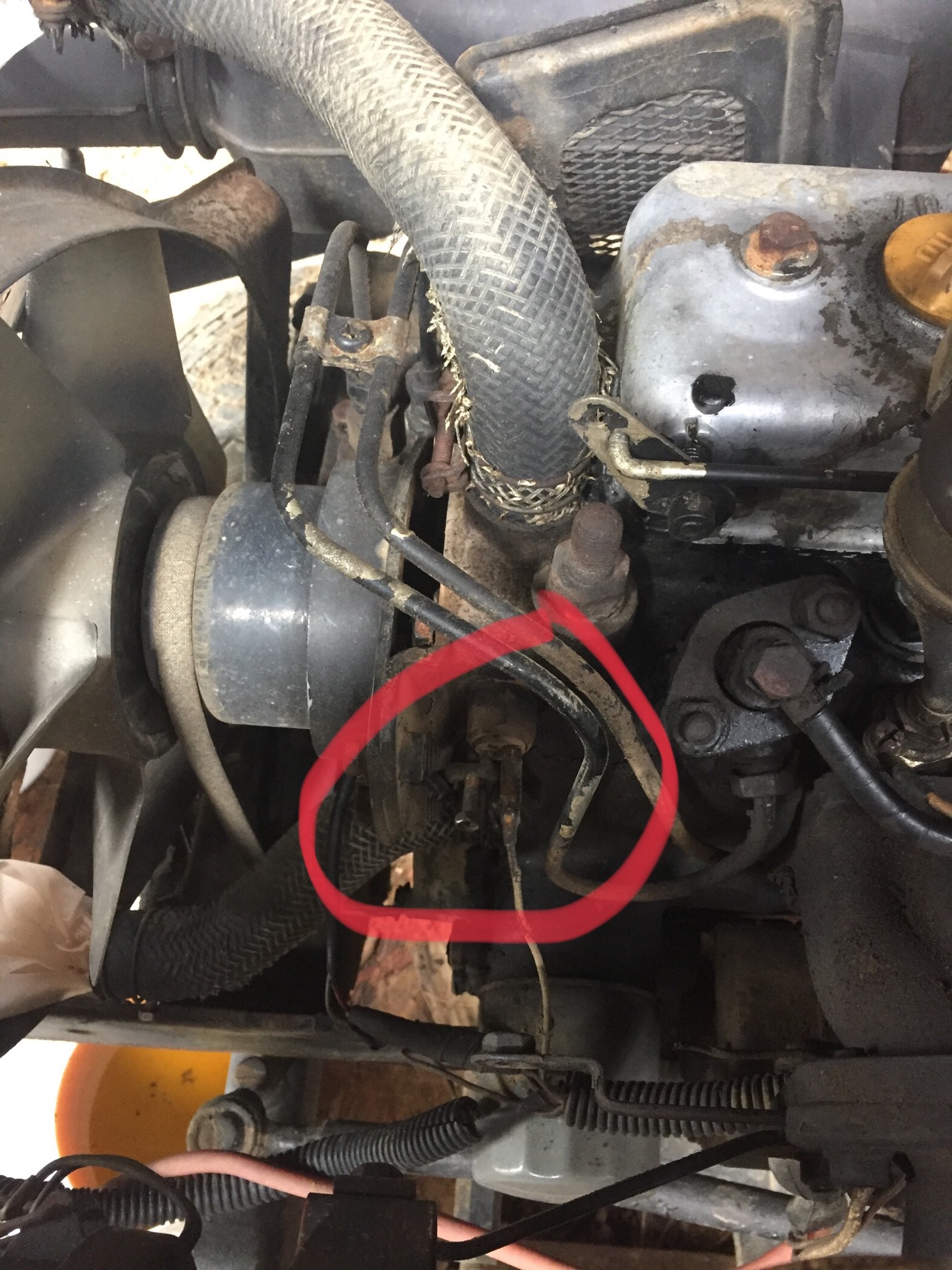

#50
Can anyone confirm if this fitting is where I will install the probe end of a mechanical temperature gauge? I tried to follow the temperature warning light wire back from the dash but the warning light was unplugged so I can’t.
