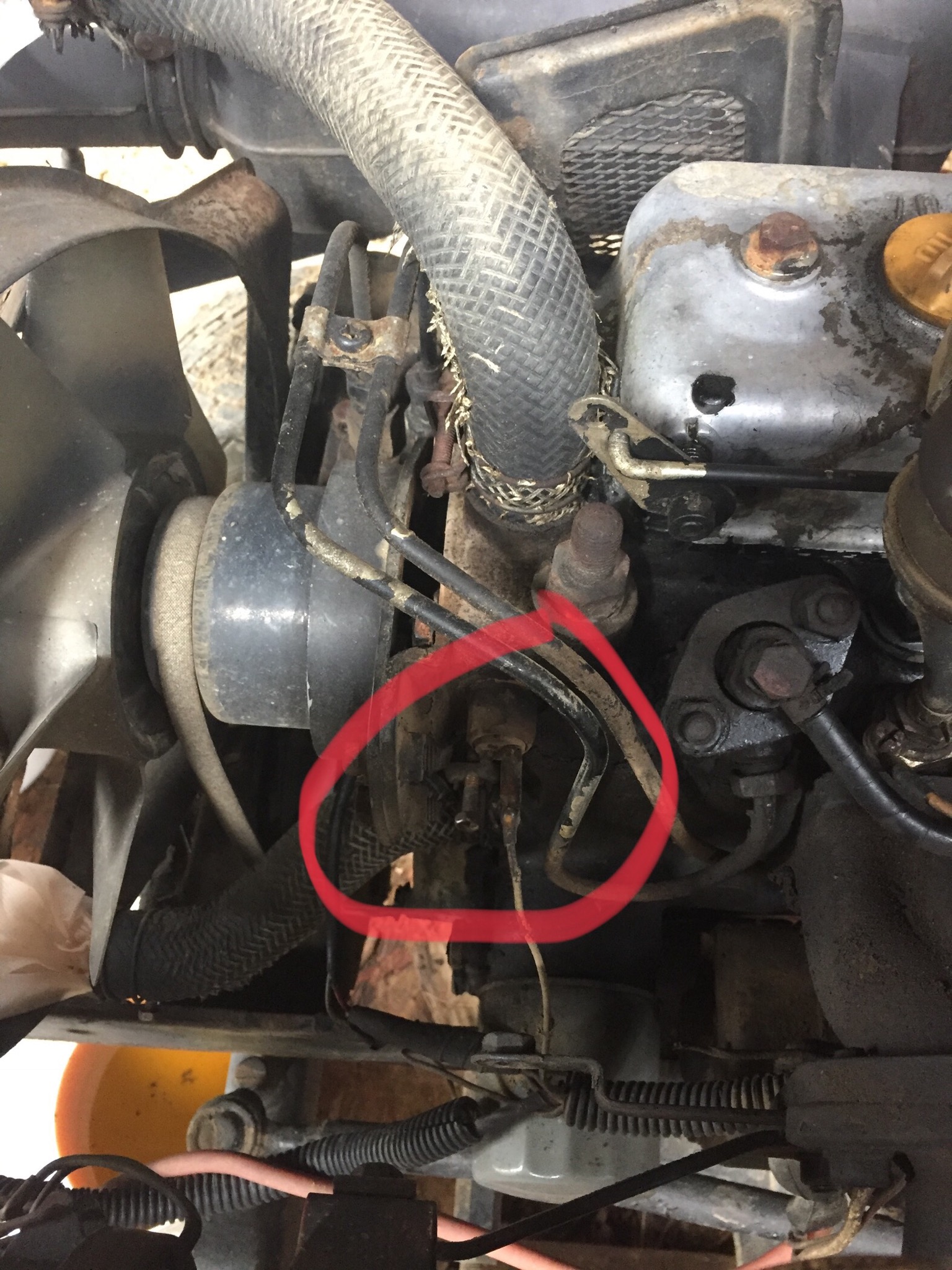

Just to clarify. The fitting is located on the left side/driver side of the tractor (if you are sitting on the seat facing forward).

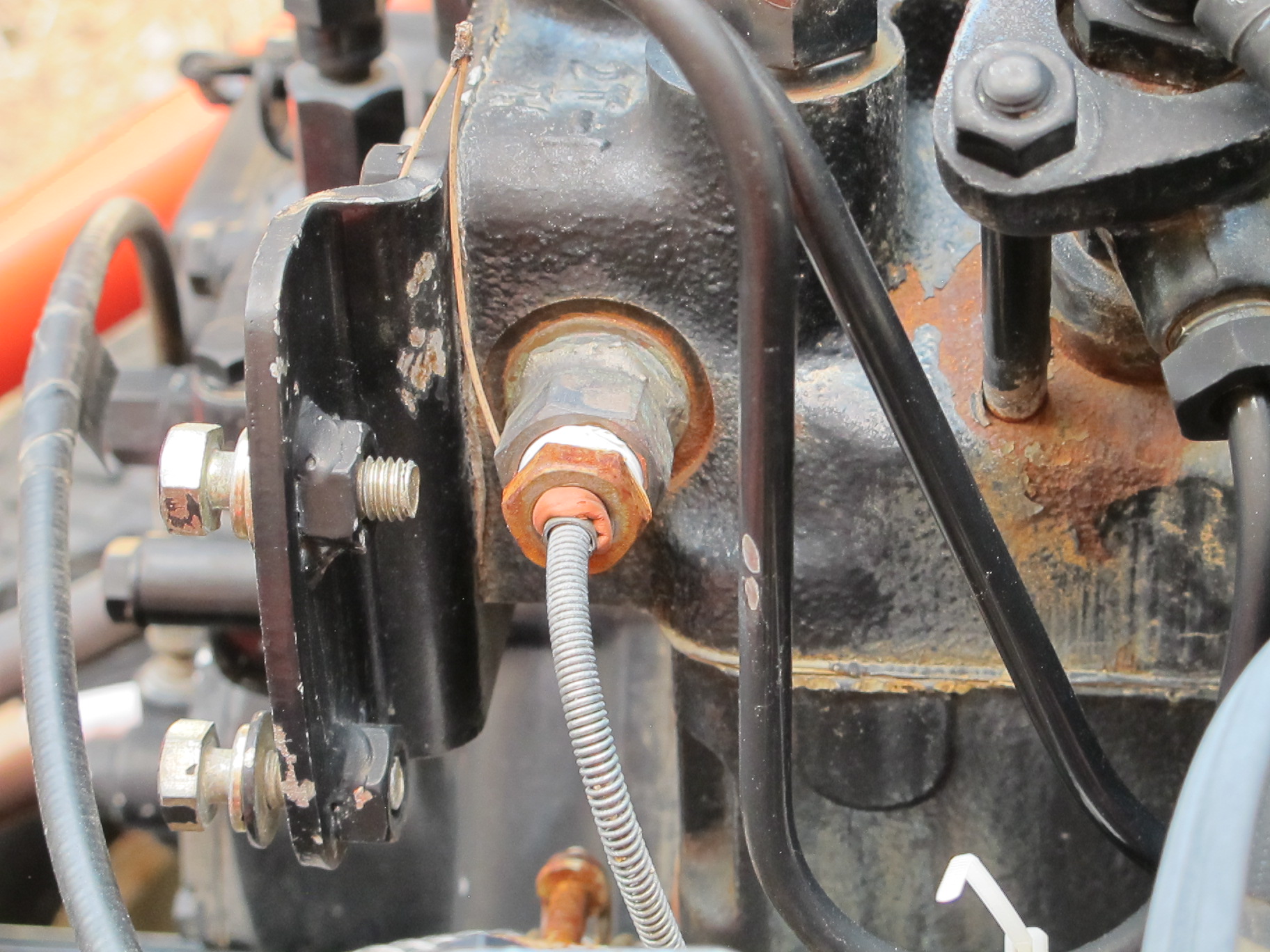

Can anyone confirm if this fitting is where I will install the probe end of a mechanical temperature gauge? I tried to follow the temperature warning light wire back from the dash but the warning light was unplugged so I can稚.
Yes, that is the sending switch which you have to replace.

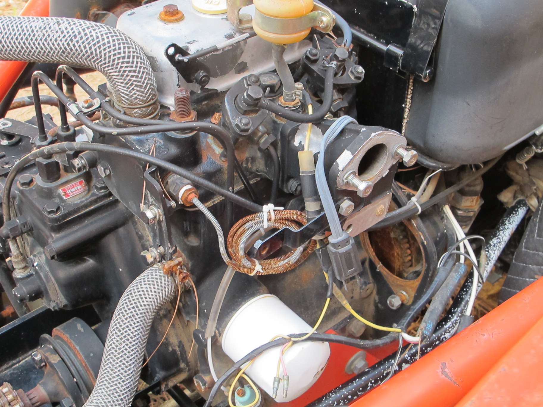

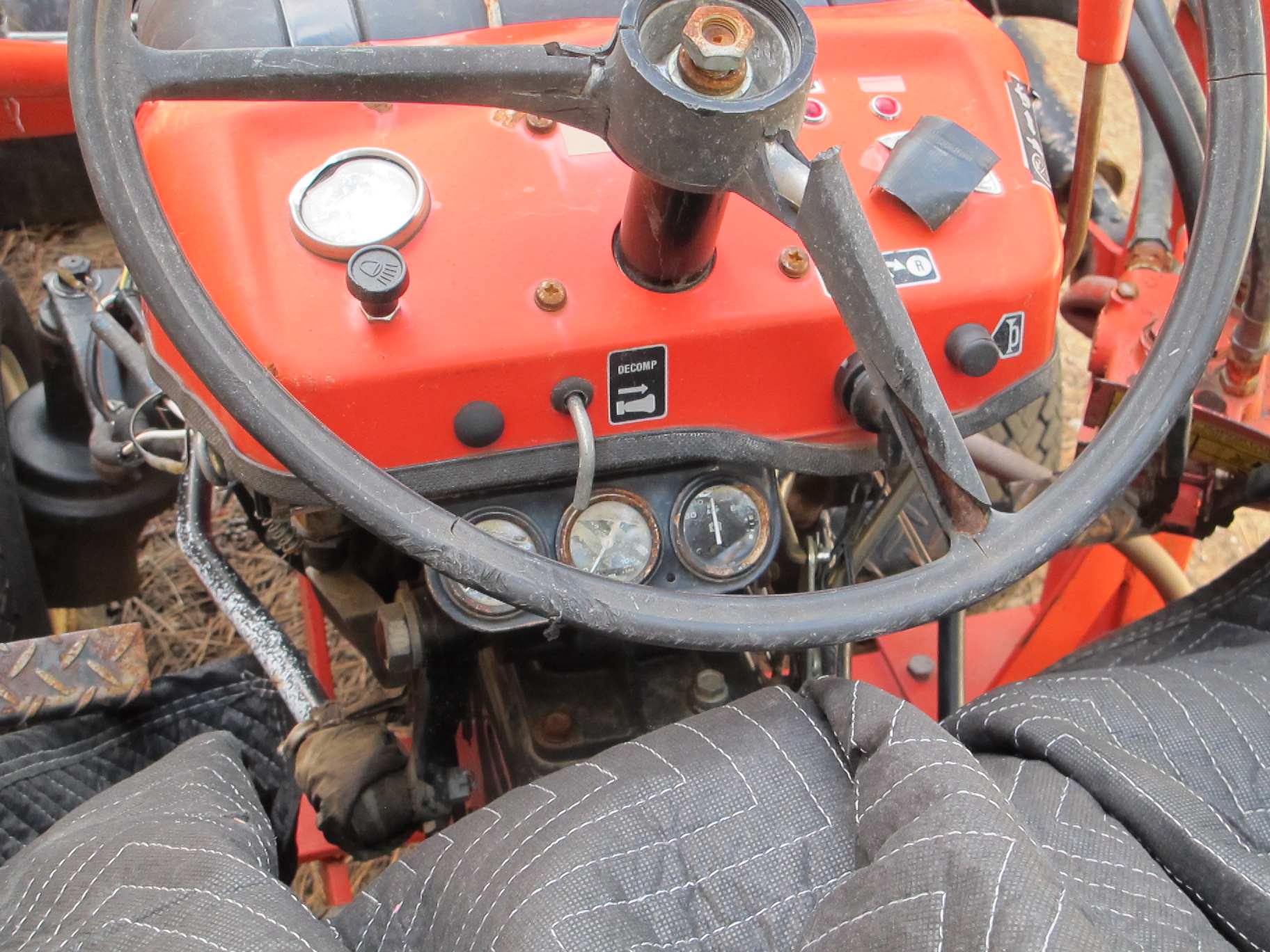

Yes, that is the right place to put any temperature sender. Here are some photos of mine.
IMPORTANT: Please pardon me for beating on this point, but like all tapered pipe threads in all vintage Yanmars, this fitting is BSPT thread (British Standard Pipe Tapered). Yanmar did not use the the common US tapered pipe thread (NPT). It isn't NPT even though it seems to be.
If you try to screw a standard NPT pipe threaded fitting into the cast Yanmar block it will screw in OK because the number of threads/inch is the same in both standards. But the pitch of the threads is different, and you will just end up ruining the threads in the block and it will always leak. That goes for where the block heater screws in as well. It is true on all the vintage Yanmars and a lot of other Japanese machinery from that era - especially cars.
You can buy a simple part to adapt from British taper to US taper adapter at most hardware shops and especially anywhere that services vintage Japanese sports cars. You can see the part in the photo below.
How the Japanese (and several other metric countries) came to use a British tapered pipe thread has got to be a good story, but I think we've posted it here before. I know we did on the Yahoo tractor site that preceeded TBN.
When I re-do the gauges on my own YM165D, I am going to put in a high resolution temperature gauge. None of the 2" stuff you see in the photo. The YM165 thermosiphon cooling system is very sensitive to slight changes in radiator efficiency and slopes.
