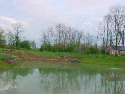

Oh, ok, since you asked /w3tcompact/icons/wink.gif, here's what it looks like now . . .

That is a dam, correct?

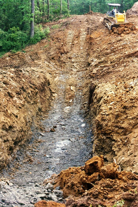

Actually, that picture is across the dam where they carved down a hillside to provide a watershed for the pond and scalped clay which they used to build up the dam and line the pond. Here is a picture of the dam keyway being dug; the grey is where the keyway is going through the stratum which passes for bedrock around here.
