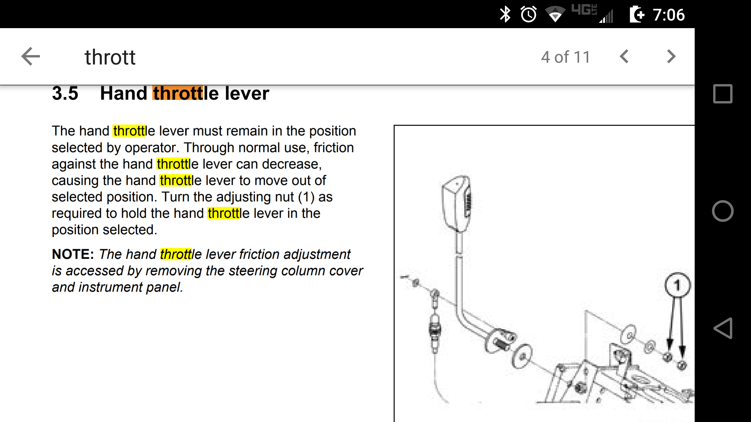

If the prices ( other than the very $ seat ) are a simple and reasonable $, this would honestly cure almost all the issues I have found my unit. Other than the engine speed lever which I find is very stiff, and if they cured the "loosness" and "wobble of the seat".

Hey Mad Hatter there is an adjustment you can make for the tension I believe on the throttle lever
Thanks for this! I had it in the dealer for warranty work just after I got it and they told me there is nothing they could do. :thumbdown:
