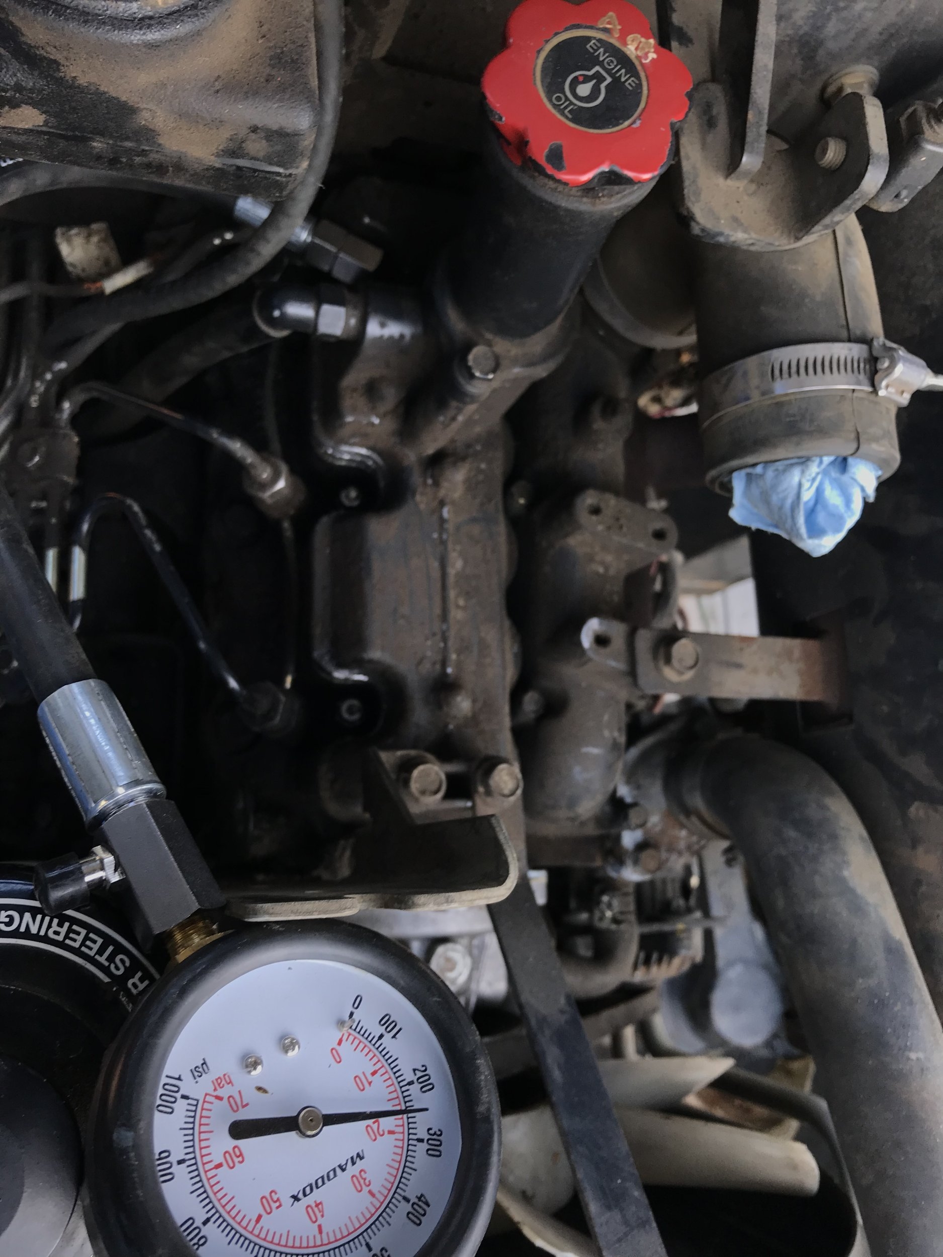

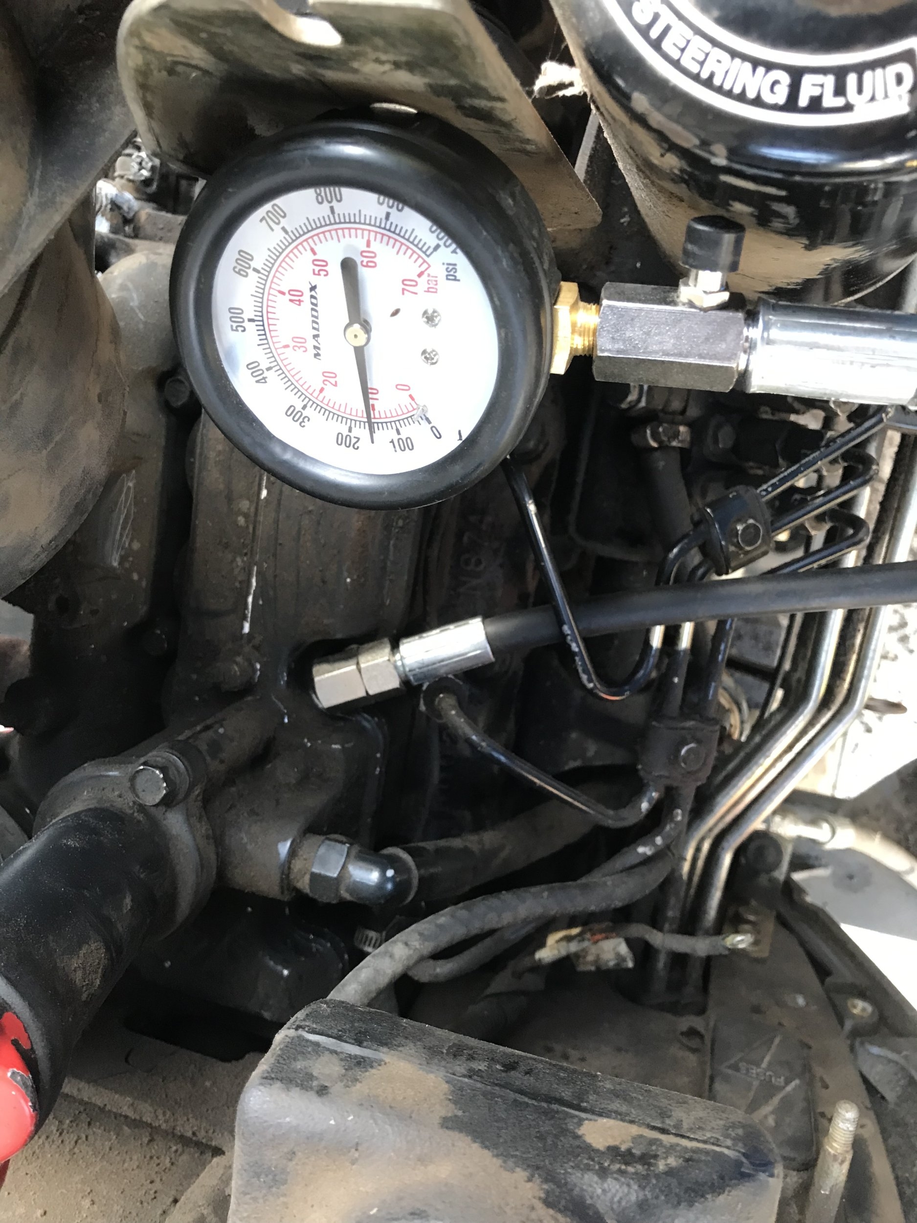

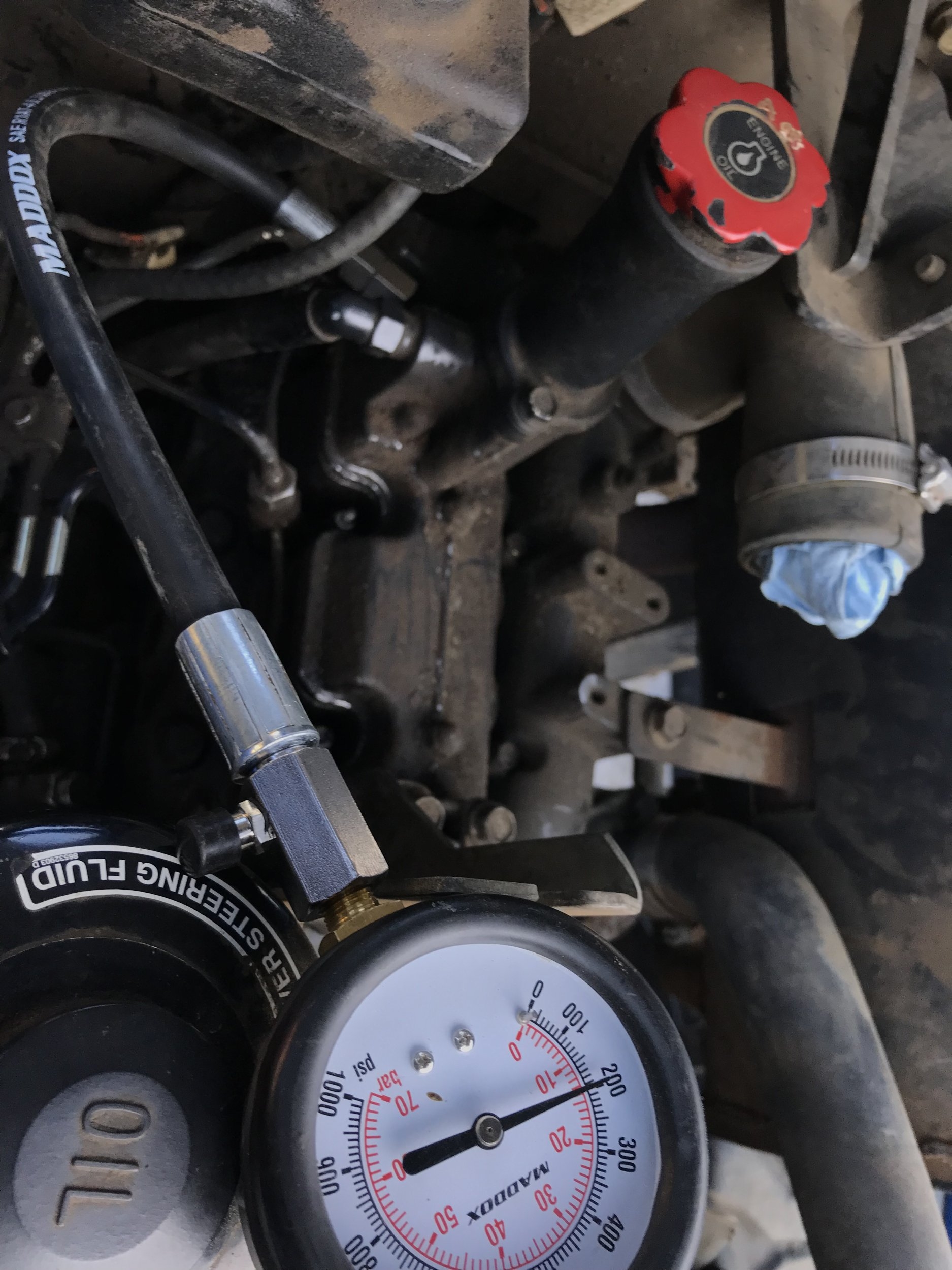

Have you checked the valve lash by chance ? Wonder if someone adjusted the valves as maintenance and set them a touch to tight. I know you said smoke from the oil fill but that could be some blow by from sitting/ dry rings. Adding oil to the cylinders could help boost the pressure if they are only a few tenths - thou open. This would make sense why all cylinders are low but about equal pressure. Very easy to check.
   / New to me TC29D cranks & won’t start #82
1100 hours, something just isn't adding up (although the hours may not be real).
If you need a ridge reamer and new rings, then you likely will also need new pistons, and honing or boring the cylinders. A big top end job. I'm not saying that isn't the answer, but I wouldn't jump right to that conclusion.
If you go down that path, eventually you'll need to remove the head, and inspect the head, head gasket, valves, and cylinders.
On some vehicles, faults are also noted under the valve cover (tight tappets, bad valves, lifters, etc).
Agreed. Thinking likely ether-blown rings and possibly piston lands
Very low compression that improves with oil in cylinders means rings are bad and the repair involves pulling the head and pistons. Doesn't rule out a valves not closing problem or a head gasket blown out between both set of cylinders problem but does rule in a ring/piston problem -still need to pull the head.
Borescope can determine if cylinder walls are scored or pistons are obviously damaged -still need to pull the head
Leakdown test can determine how bad rings/possibly valves are -still need to pull the head.
Valve lash adjustment is probably worth testing first because if someone incompetent set it grossly off it's possible the valves are never closing during compression stroke. It's also possible but less likely that someone pulled the cam and didn't retime it to the crank correctly or it somehow skipped time causing valves to be open during compression stroke. Valve not closing problem with lash in ballpark -still need to pull the head.
Head gasket blown between all 3 cylinders -still need to pull the head.
So if the compression tests +/- oil are giving valid results and there's not a gross valve adjustment problem or gross crank/cam timing problem, the head needs to come off in my view regardless of the source of the problem.
Some quick and dirty tests here:
Put a socket on the crank bolt and manually turn the engine -do you feel much in the way of compression resistance? Do you feel air blowing out the crankcase breather (valve cover on)? This will help validate your compression tester results.
With the valve cover off, use the socket on the crank to turn the engine until a given valve is pressed down by the rocker arm to it's maximum travel, then make sure you can move/rattle the other rocker arm for that cylinder. Repeat for all 6 valves. This will determine if your valve lash is set in the ballpark or if it's grossly off.
Cam/crank relation timing can be ballpark tested by looking for a crank rotation period where both valves are closed (up and rockers rattle) and seeing if you can feel the top of the piston with a long screwdriver probe through the glow plug hole. This is unlikely though and I wouldn't think necessary unless it's obvious someone has recently taken the front cover off.

I definitely agree that something isn’t adding up. Three sets of rings failing at the same time, with similar test results? What is the expected number 300ish, probably close enough to get it to puff.
I'm with you here. 3 things don't fail all at the same time like this and re ringing a engine isnt a quick and easy job. I would be checking alot of other things before I just go ripping and tearing at the engine.
Theres plenty of other cheap/free checks and adjustments you can do before you just start throwing parts at something.
   / New to me TC29D cranks & won’t start #89
I am a firm believer in leak down testing.
Where air escapes provides great info as to where compression is lost.
You could have several locations loosing compression, but focus on only 1 and major frustration when reassembled.
Check for air escaping between head and block—bad gasket.
Air escaping from intake—bad intake valve(s)
Air escaping from exhaust—bad exhaust valve(s)
Air escaping from oil pan/dip stick tube—bad rings
Air escaping from oil fill could be a couple of locations—rings, valve guides.
Once you know where air is escaping, you have narrowed down greatly what you need to investigate.

Since the OP said it had blow by when cranking that part of the leak down test is complete. Compression even with oil is too low. Time to disassemble and perform what can be done while apart to that degree. I have been building engines over 55 years. Checkout my Massey Ferguson MF 400 rebuild listed as another restoration on this site. I bought it not running like you did.

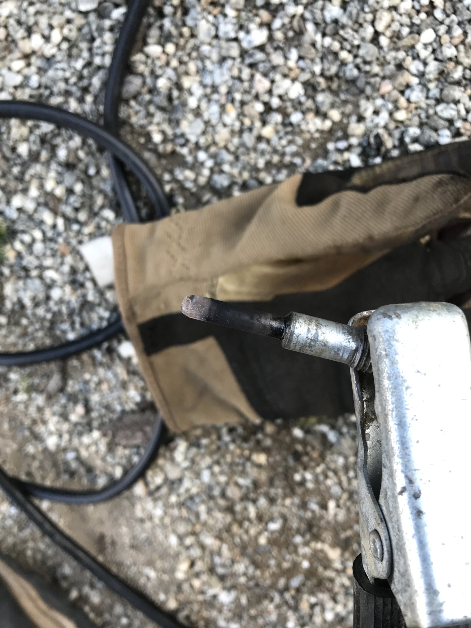

If you have working glo plugs, even a 'whiff' of either can destroy the motor to the point where you'll need a major rebuild and not just a top end job.

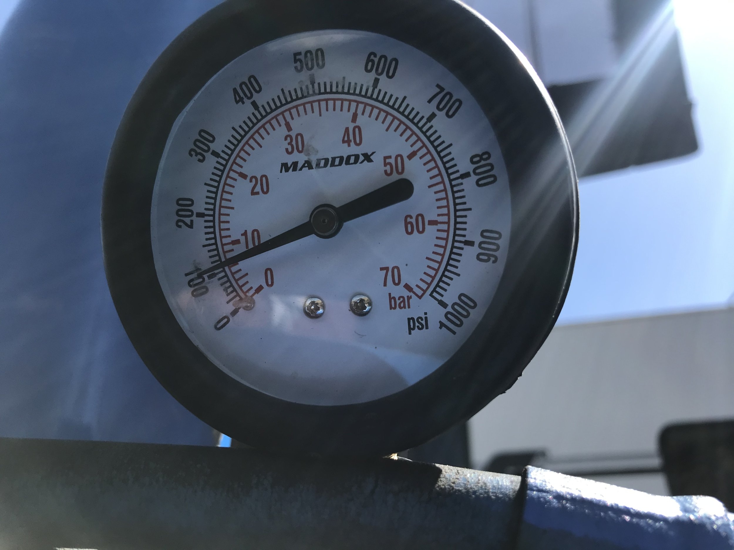

The thing is your taking a single compression test gauges readings. "Trust but verify" there nearly all equally low so I would throw a second gauge on there and re check.
Gauges do go bad. I have one that reads 20-30psi low.
   / New to me TC29D cranks & won’t start #100
Just connect the gauge to a known source like their air compressor. In this case he needs lot more than 30 psi.
