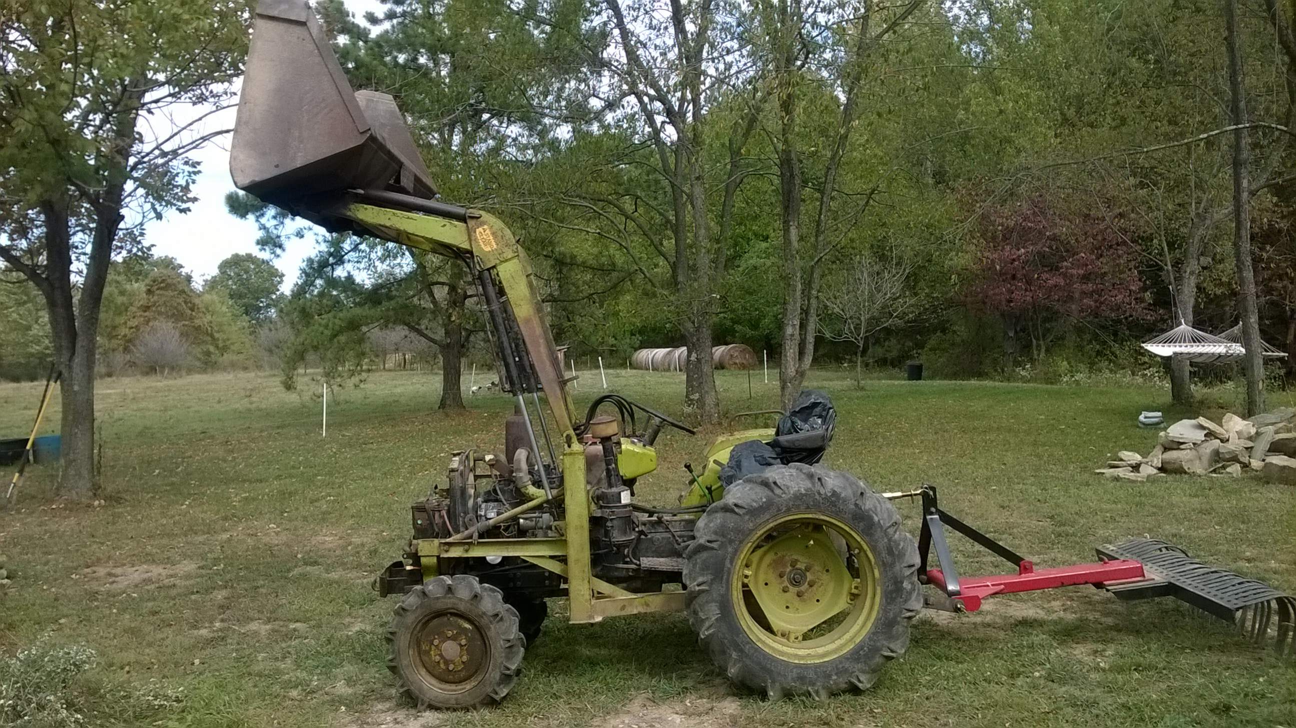

My Tractor is 2000BD with loader... I don't know why my tractor is doing this, but it doing the same thing yours is... Here's what I have found that works... When I need to lift something real heavy. I have to raise my 3 point all the way up to the top...If the 3 point is down just a little I don't have near as much lifting power with my loader...If the 3 point is up I can lift 1,000+ lbs... Now the curl... If the 3 point is all the way up to the top... My loader will NOT curl down or up...It is super slow... Now if I let the 3 point down just a little say 1 or 2 inches the curl is fast... Give it a try on your tractor and see what the experts have to say about a the fix... I know nothing about the hydraulics... My loader is hooked up off the pump with the Hoye Tractor Parts... HA-38 HYDRAULIC ADAPTER - ADD A LOADER / LOG SPLITTER Link here>>>Yanmar Tractor Parts HYDRAULIC ADAPTER - ADD A LOADER / LOG SPLITTER
So I tried what Djames55 suggested and found my setup behaves like his. With the loader arms fully extended (bucket at highest possible point) and the rear 3PT lever all the way forward (rear implement lowered as far as it can go so there's no weight on the 3PT) as in the attached photo, the bucket cylinders can roll the bucket toward me but it will NOT extend the cylinders. It just won't do it. Not slowly, not eventually, it just won't go. If I raise the 3PT hitch so that the rear implement is off the ground those same cylinders WILL extend. No idea what's going on but I think putting a gauge in the system will help identify things. When I do that I'll post the results.

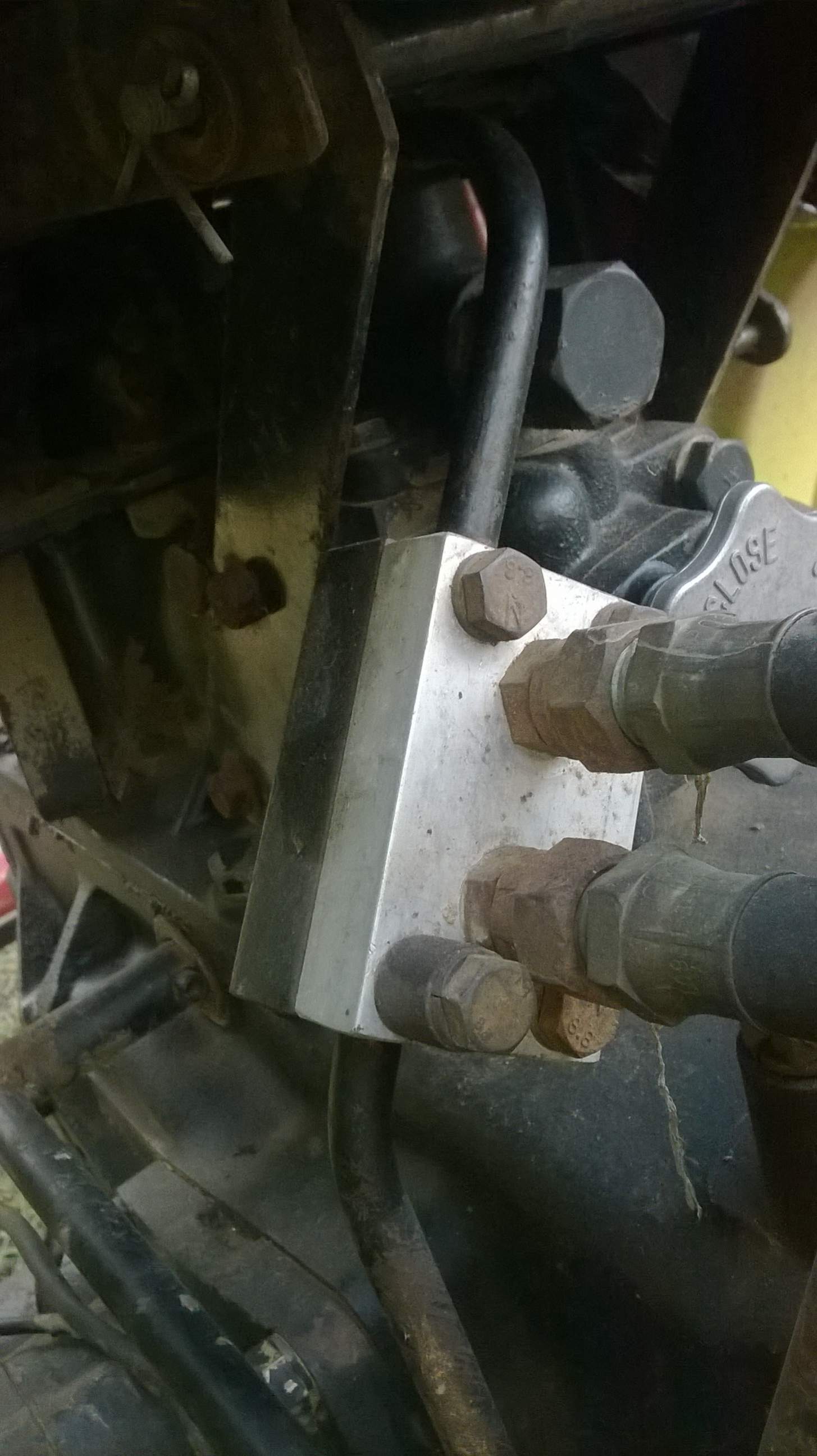

Aczlan, not on these. The operation manual for these US Yanmars advised to plumb a loader in series ahead of the 3-point, between the pump mounted on the side of the engine and the 3-point inlet. And the US Yanmars had a pre-installed diverter block that was straight-through to the 3-point with no loader, or changeable by adding (removing?) an internal plug to send fluid out to the loader, and back into the block's other port to continue on its way to the 3-point. See my photo of this block in post #142. I also posted a scan from the Operation Manual describing this, somewhere back in this thread.

I am wondering if WoolyAcres plug is out of his diverter block? I believe it should be in there for loader use. Wondering if his loader is depending on back presssure from the 3 point in order to work?
Pretty confident without an attachment such as a loader the flow goes right through the diverter block to the 3 point. When adding a loader the plug is installed causing the flow to go through the loader before getting to the 3 point. Probably all wet here but I would take a close look at the diverter valve and just how the fluid goes through it.

I'm not really sure how this should be plumbed. I looked back at California's post earlier in the thread to see how his compares to mine. Mine is below and it looks a bit different to me, but maybe the internals are the same? In my photo, the two flex lines run over to the loader control valve. The lower of the two feeds into the control valve IN port. The top appears to be the return from the loader valve. The solid line coming into that block at the bottom comes from the hydro pump at the front. You can see the solid pipe leaving the top of the block heads into the case just under the seat. This seems right but I have no idea what's going on inside this block or why that one bolt in the lower left on this block has a shim on it.
