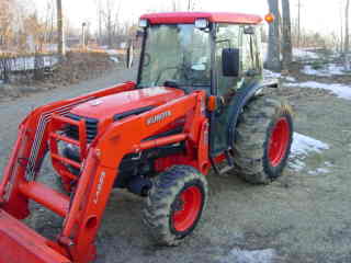

The fruits of our labour. So far it can pull 3 60 foot spruce or fir from the small end, in snow.
Haven't tryed to push it yet. Did use the winch to pull down a hung tree today too, that was handy.
   / New to us L5030HSTC #23
slowzuki, just make sure you push in low range and you can push till the tries loose traction. I lightened up your pic a bit, nice logs!
