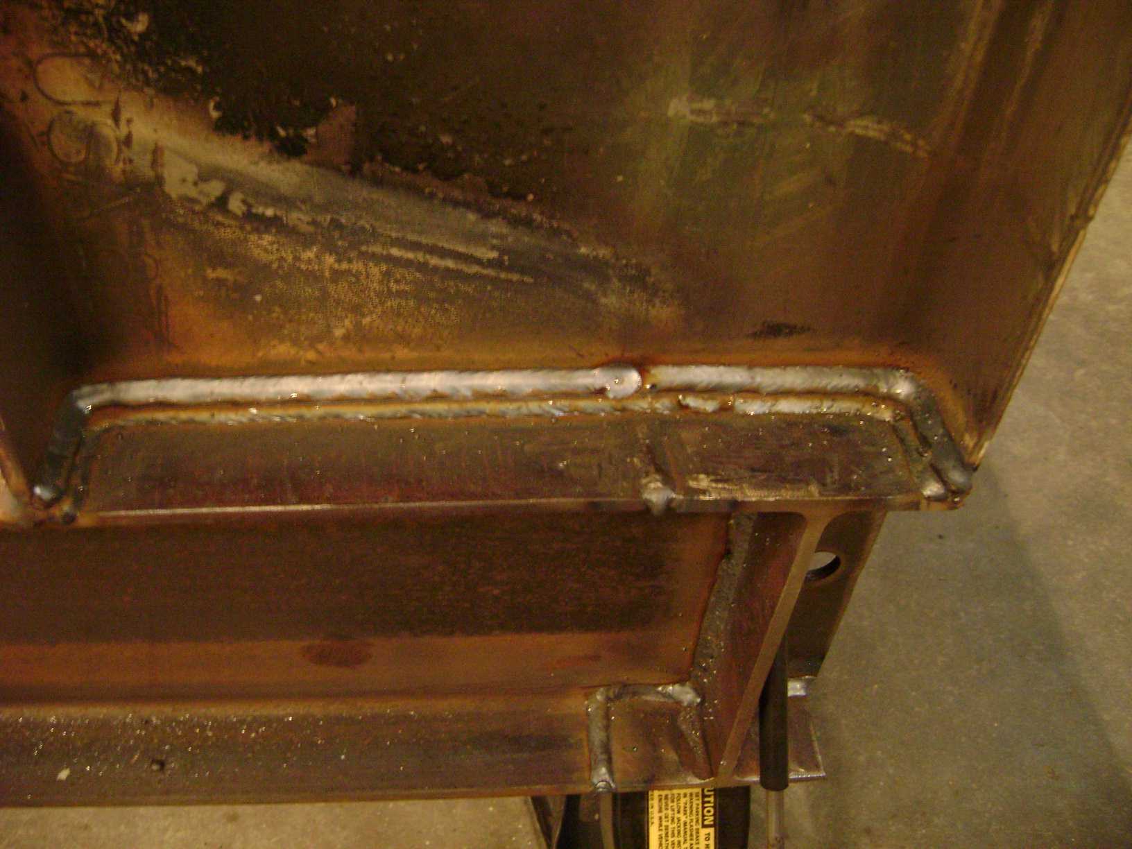

On 3/8" steel with 1/8 rod isn't it good to make a couple passes on a lap or fillet weld? If so since I'm learning 6011 can you do several stacked passes with it for something your repair or building?
   / New to welding #148
Yes you can.
In the 1970s I worked in a fab shop. Our number 1 contract was building nuclear waste tanks. The lifting ring, was 4-inch X 8-inch flatbar rolled to 8-feet in diameter. We had to make a 1 7/8-inch fillet weld top, and bottom of the lifting ring. I don't think there is a limit to how much you can stack welds!
This pictures is a 3-pass fillet weld, with Mig.

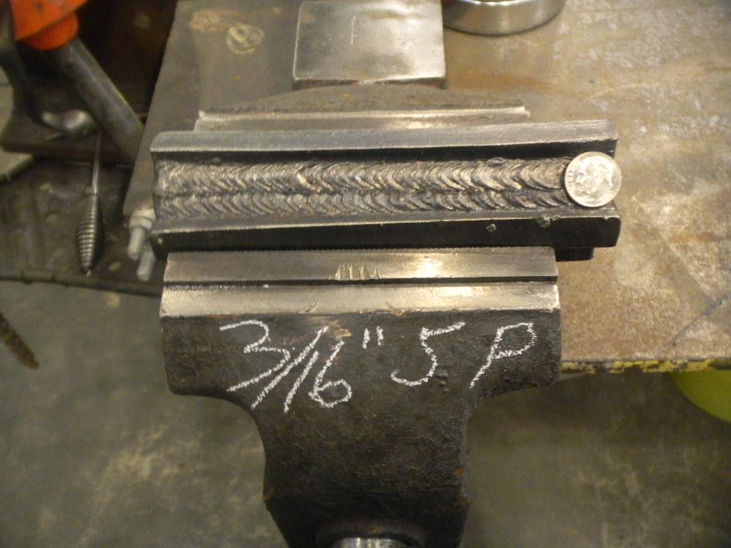

Guess I was meaning with 6011 for stacking on top of one another on multi pass situations. I know usually 7018 is what I see stacked.
   / New to welding #150
Here is a 6010 fillet weld. Stacked on top of each other. Pipe welders stack 6010 when welding pipe.
