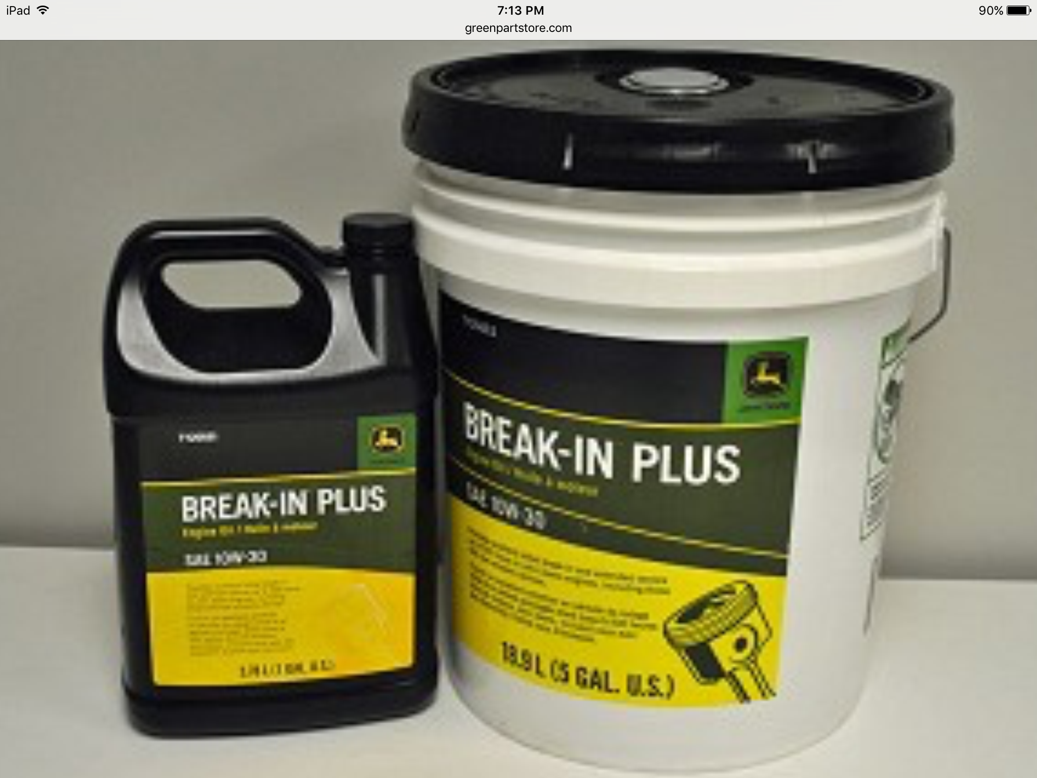

The thing that always caused me to do the 50 hour service was the fact, not only of small metal and sand particles but also solvents and lubes used in assembly. I had a larger Deere once that required the break-in oil to stay for the first 100 hours but I wanted to do a change at 50 hours. I just changed with fresh Deere break-in oil and went to regular oil at 100 hours. Worked for me.
   / New Tractor Break-in procedure #32
BTW, I haven't seen special "break-in oil" used in about the last 50 years. I do remember it before then. But today I would simply use the recommended oil.
rScotty
This is from the Operator's Manual of my John Deere 5205 which I bought new about 10 or 11 years ago:
"New engines are filled at the factory with John Deere ENGINE BREAK-IN OIL..... Continue to use ENGINE BREAK-IN OIL until 100 hours is reached." (those capital letters are from the original text)
It goes on to say to keep using break-in oil for 2 or 3 oil changes if the engine has been under light load.
   / New Tractor Break-in procedure #33
Part # YT26661. TY26663
Well, there you go... O).. I haven't bought a new JD in a long while. In fact the last 3 new tractors I bought were not JD* and they did not specify any special break-in oil. So I haven't had occasion to use it. But I agree it's hard to go wrong using the oil recommended in the manual...
rScotty
