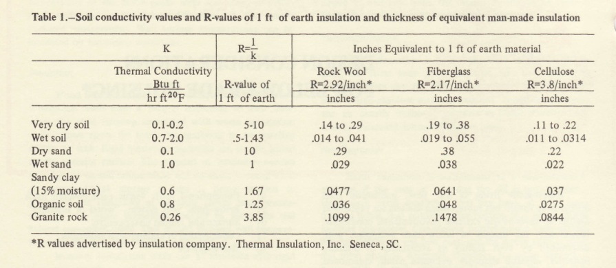

This should make it clear as mud!

I have no idea what the R value of dirt is. The 1" of styrofoam=1' of dirt I got from a construction foreman years ago.
The "R" number isn't important... what matters is knowing that it works.

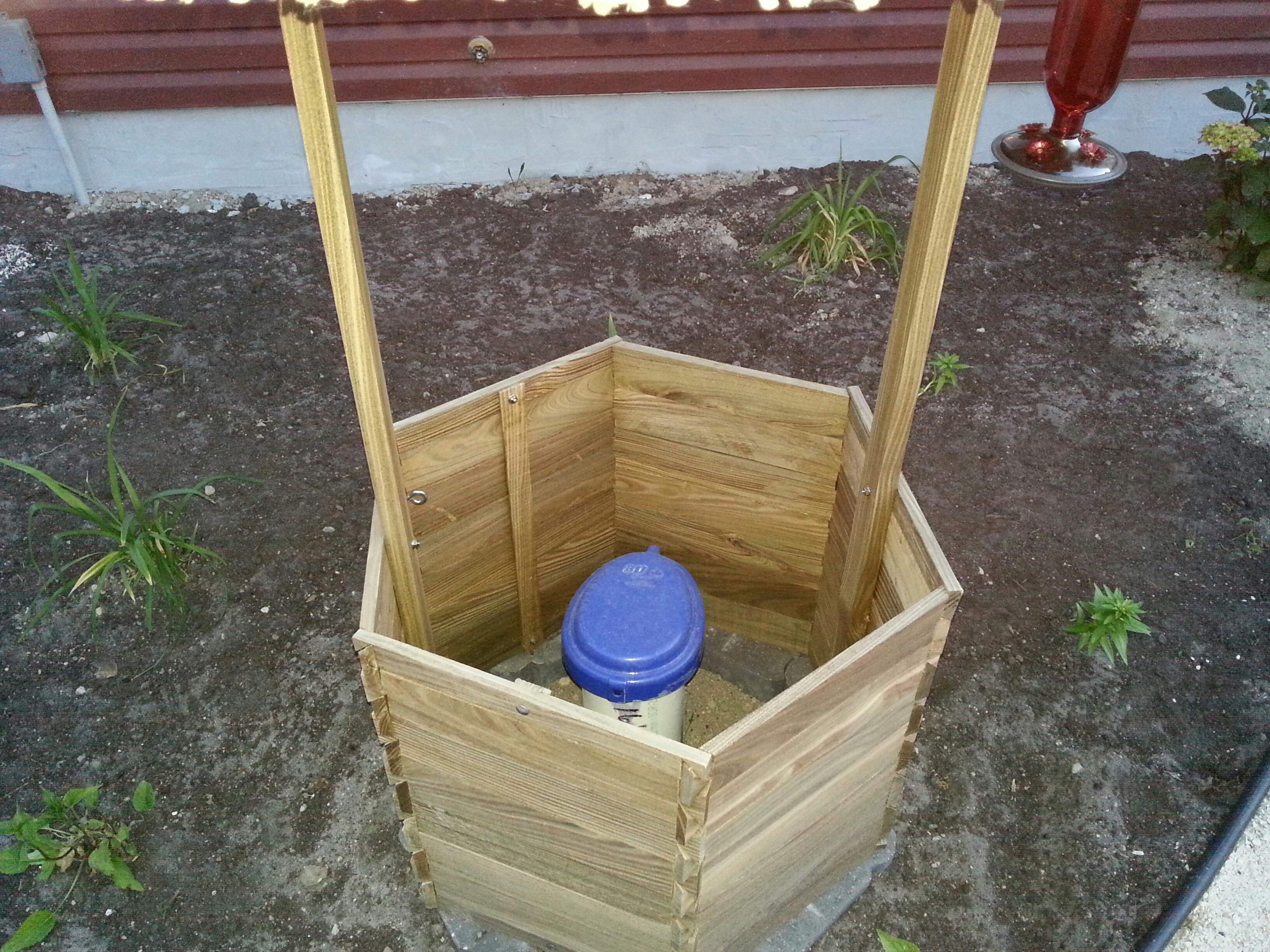

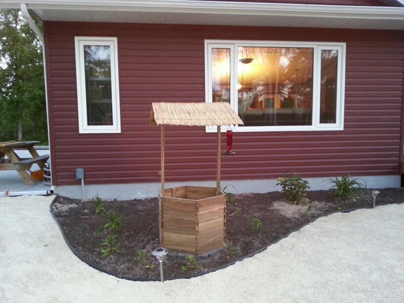

Got some landscaping in the front finished off, here's the wishing well cover I had mentioned, kudos goes to my FIL for this one. Still need to add a small bucket and rope, just for looks.
