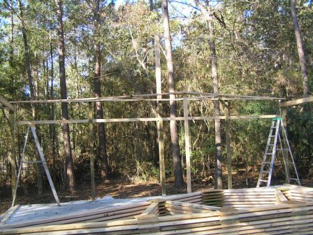

Nov. 5 Well they finished truss construction yesterday - - with that done they made great progress today. He had a 3rd worker on hand today to help with setting the trusses. They did it all by hand - - no crane or FEL. That surprised me.
Here's the 1st truss set on the girders.

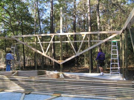

Next they rotate the truss up 90 degrees & prop it there. Look carefully - - the perspective makes it difficult to see it, but the truss is propped in a horizonal position in this photo.

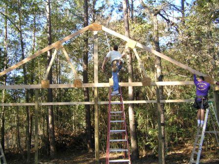

Finally, they rotate the truss upright by just working it up a bit at a time. The have a 10' ladder in the middle & 8' ladders on each end. It sounds pedestrian, but it works.

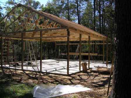

All eleven trusses in place by noon.
   / New workshop/garage
#29

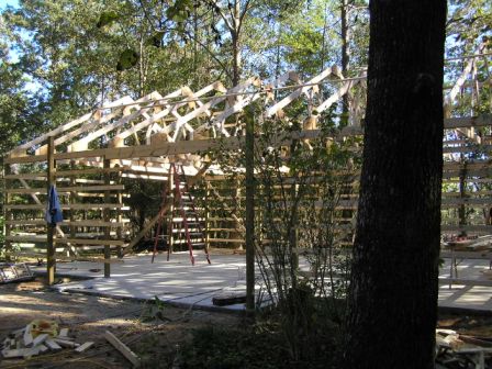

The rest of the day was spent installing nailing girts, shown here.
I expect they will have the metal roofing on by the middle of next week.
What I'm missing out on by not building this myself, I'm making up for in speed of construction. They are doing a good job & moving quickly.
