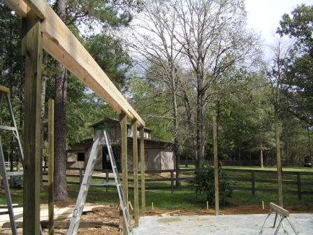

I hear you - - I'll talk to the contractor & see what the extra cost will be. However, I used t-111 when I built my barn, spring 1994. [see attachment] I think it still looks pretty good, 10 years later.
I appreciate the tip - - & I will talk to my builder, but my budget cannot stand much in the way of add ons. I could have gone cheaper with metal siding, I think. But, I wanted the workshop to, more-or-less, match the barn.

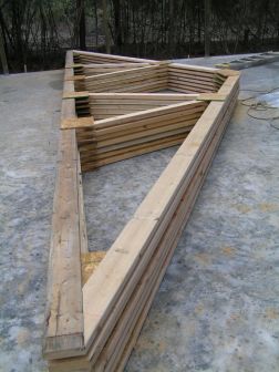

Nov. 5 Well they finished truss construction yesterday - - with that done they made great progress today. He had a 3rd worker on hand today to help with setting the trusses. They did it all by hand - - no crane or FEL. That surprised me.
Here's the 1st truss set on the girders.
