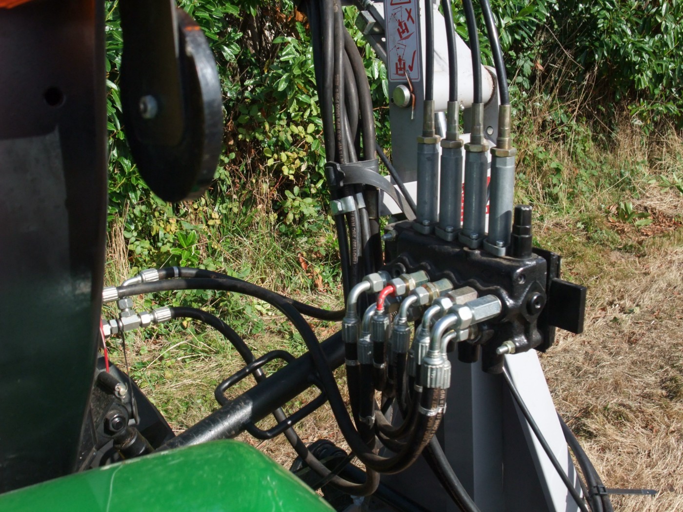

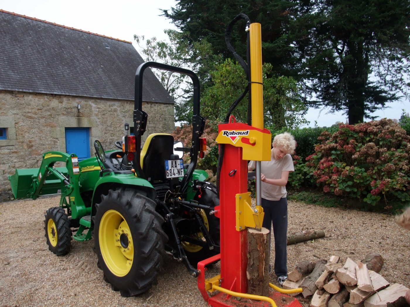

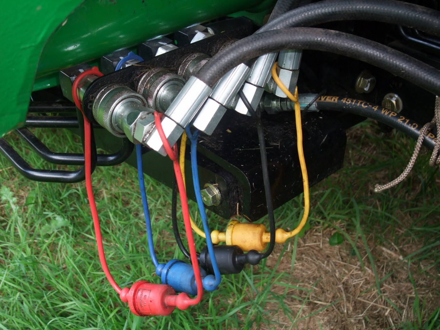

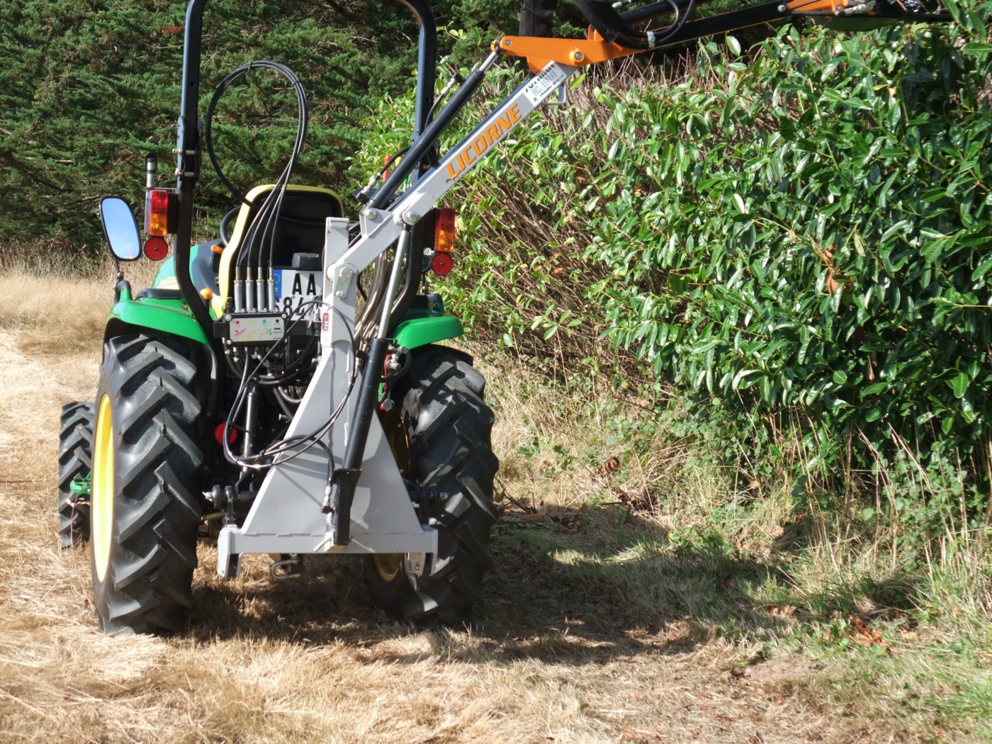

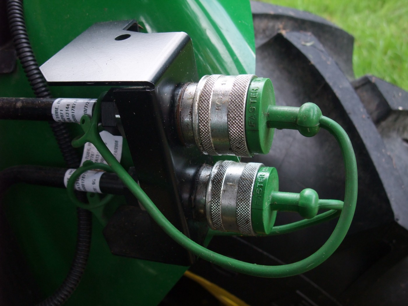

In my opinion, get as many OEM rear valves as you can. In my case Deere only provided one set and I have to make do with that for the moment. Then it's only a question of unplugging some quick couplers and plugging others, sometimes with rather long hoses, to operate a grapple from the rear remotes for example. Another example, the lift cylinder of my mower deck uses one of the FEL lines. The log splitter can be plugged into any of the rear remotes.
