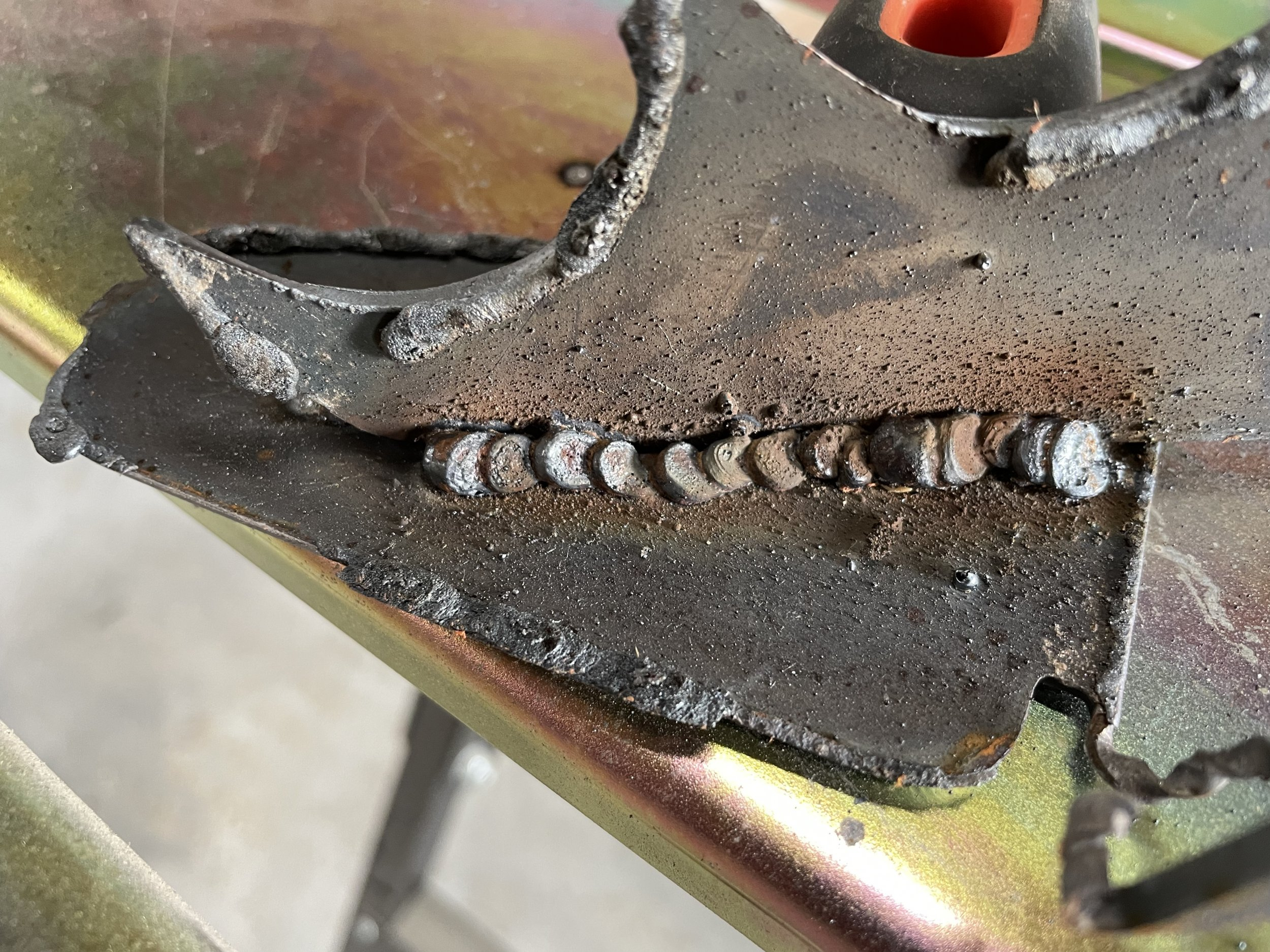

I have a couple of tractor projects I'm looking to do so I bought a 110 140V mig welder.
My budget and future needs dictated that welder so here we go....
I grabbed a pic of steel I had and started practicing going gasless. I really have little knowledge of settings.
My first try.
A few more lines. Started from the right/bottom. The surface started off brushed clean.
I'm looking for constructive criticism or advise.

Not enough heat. Is it cranked up all the way? Maybe too much wire feed too. It doesn't look like you're getting any penetration.
I can barely do 1/4" with my old Century 140 (110A). I bought it for sheet metal and it does well for that. For thicker stuff, I break out the old Craftsman Stick Welder.
/ Newbie looking for critique #3
It’s too cold. The surface prep isn’t good enough either. You need to use a grinder and take it down to new metal. A stick welder will burn through that level of rust but a wire welder isn’t very forgiving about dirt.

I did brush clean the thick steel with a wire wheel but it got dirt as i went along.
The first 90° is less than 1/8 thick and that weld actually tacked it to my metal table.
I will test more.

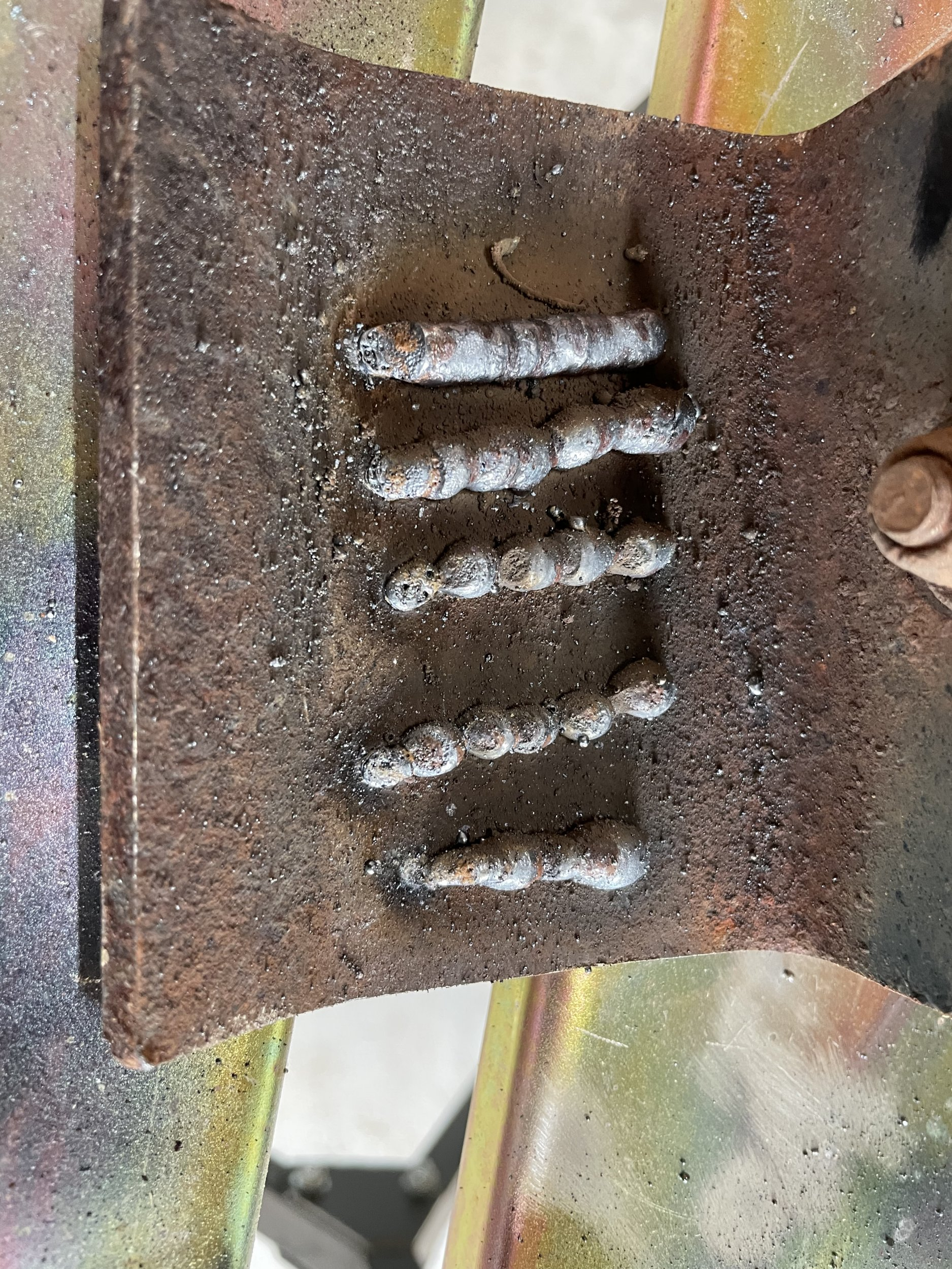

The latest. Started from top right. To me it looks like I'm pulling back too far but it doesn't seem like it when I'm welding.

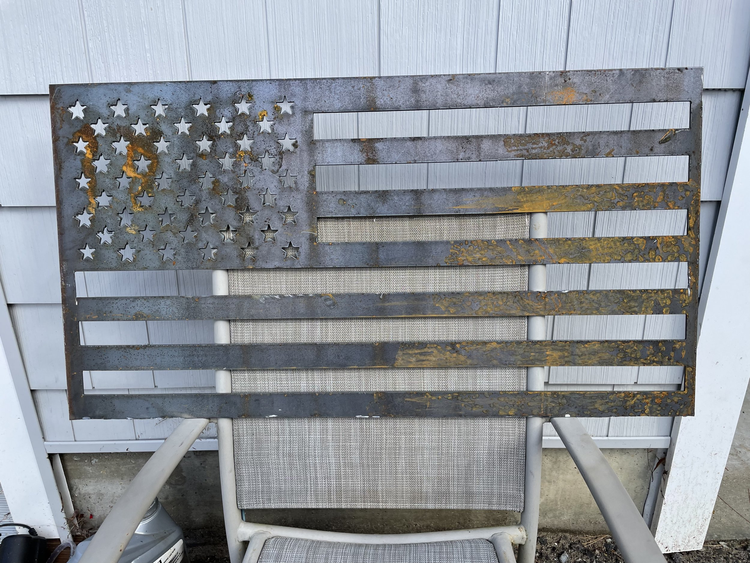

Any amount you fall short welding you more than make up for with your torch cuts. 👍

is the polarity set right? mig and flux core use opposite polarity.
/ Newbie looking for critique #8
Leaning the torch too far back? I do that to see the bead better and get the same look when I do. Better that I weld L to R than say toward me to keep my angle closer to 90 deg.
btw, If that's gas-less, why does it look like you didn't chip the slag or wire brush after welding? Inquiring rookies want to know.

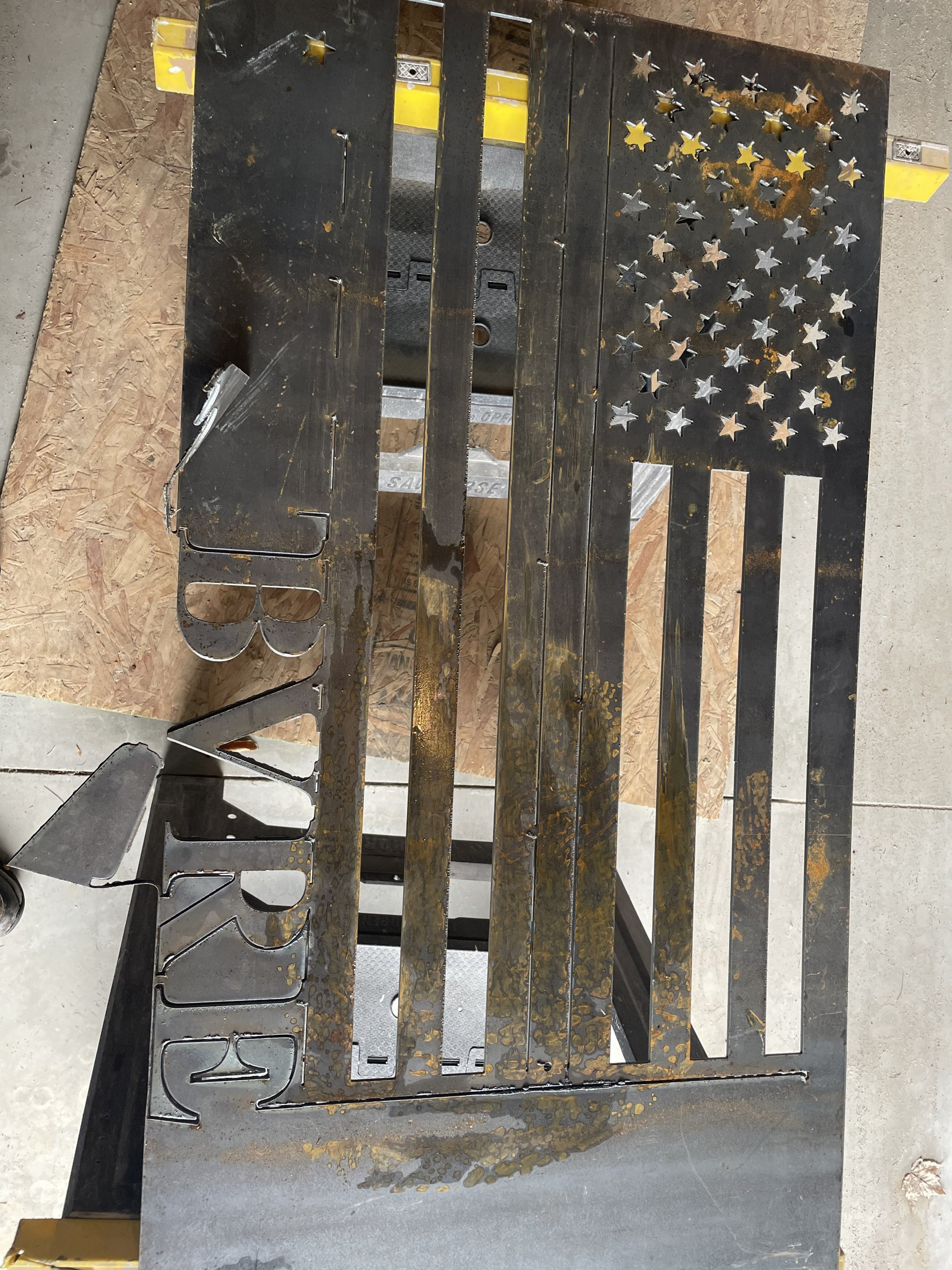

To be honest, the material came from the transfer station where it was scrapped. See the pics below. I'm assuming it was plasma cut.
I then cut off the lettering and got this.

Not sure how that works. More education is due.
Possibly.
I did not chip of slag or wire brush.

it also looks like theres a bunch of porosity. usually flux core is pretty forgiving on surface prep. what type and size wire are you using? what amperage and wire speed are you set at? what works well for me is moving like im drawing lower case cursive letter e's. I naturally have pretty shaky hands but it'll look something like this.
/ Newbie looking for critique #12
to change the polarity you have to physically swap the 2 big wires that are usually located inside the door that covers the wire compartment. there will usually be a settings chart in there showing which polarity to use for which type of welding

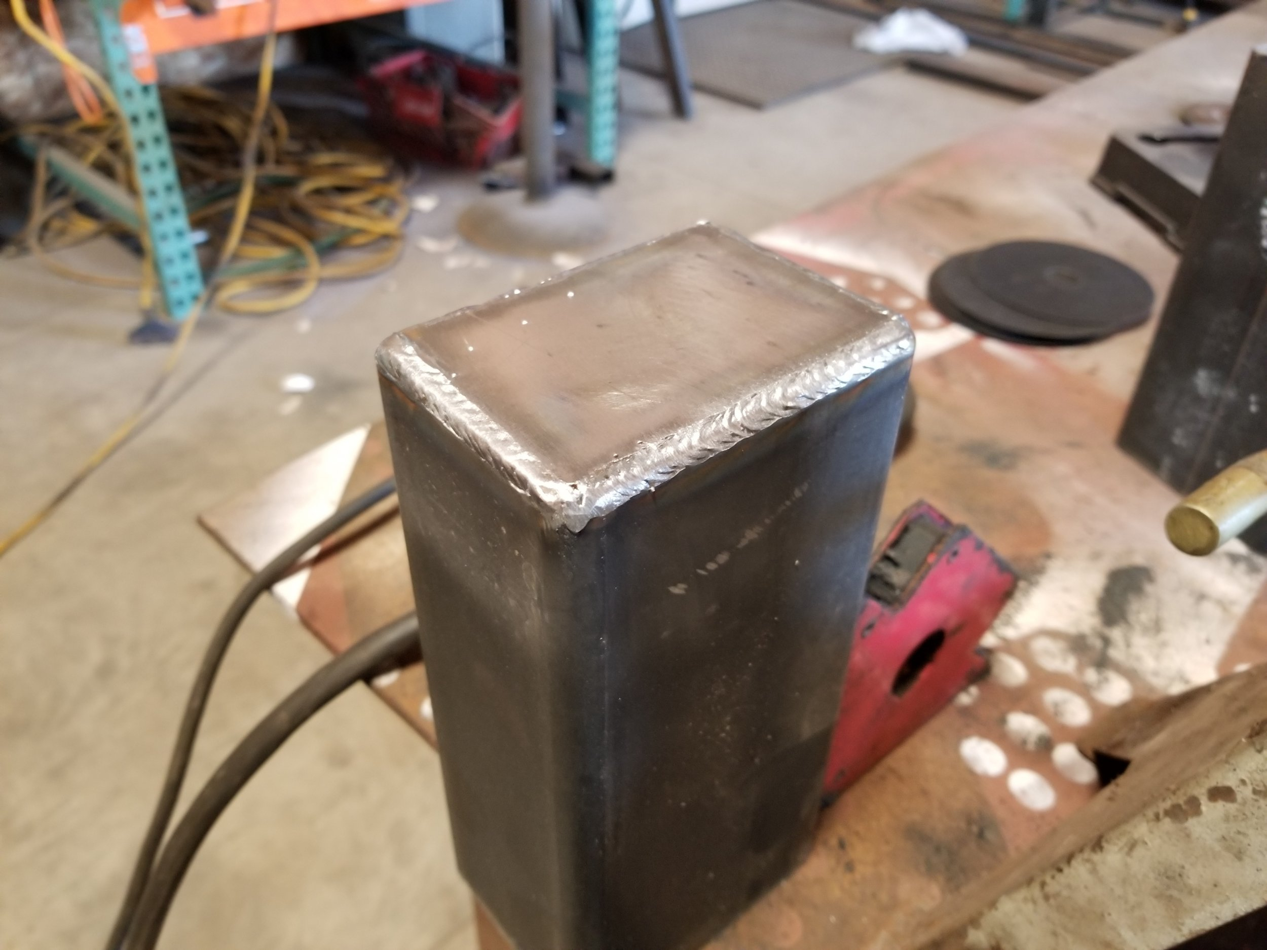

What brand welder is it? I have the Lincoln pro mig 140. The polarity wires are the wires on bottom left of wire compartment. Should be a diagram on the lid to indicate what wire goes where. And a chart to help get started on wire speed and voltage setting. The chart gets you close and you will have to fine tune the settings as you go. I have found that cheap flux core wire isn’t worth the plastic is wrapped in. As stated before get it set up for mig. Bottle rental in my area is 100 bucks a year plus the 24 bucks for the gas. A full bottle lasts me about 6 months depending on how much crap breaks. I’m no pro as you can see in the pic. This is with 75/25 gas. I too use letters. But I do the letter c. Working from one piece to the other. Plenty of vids on tube you to watch.
