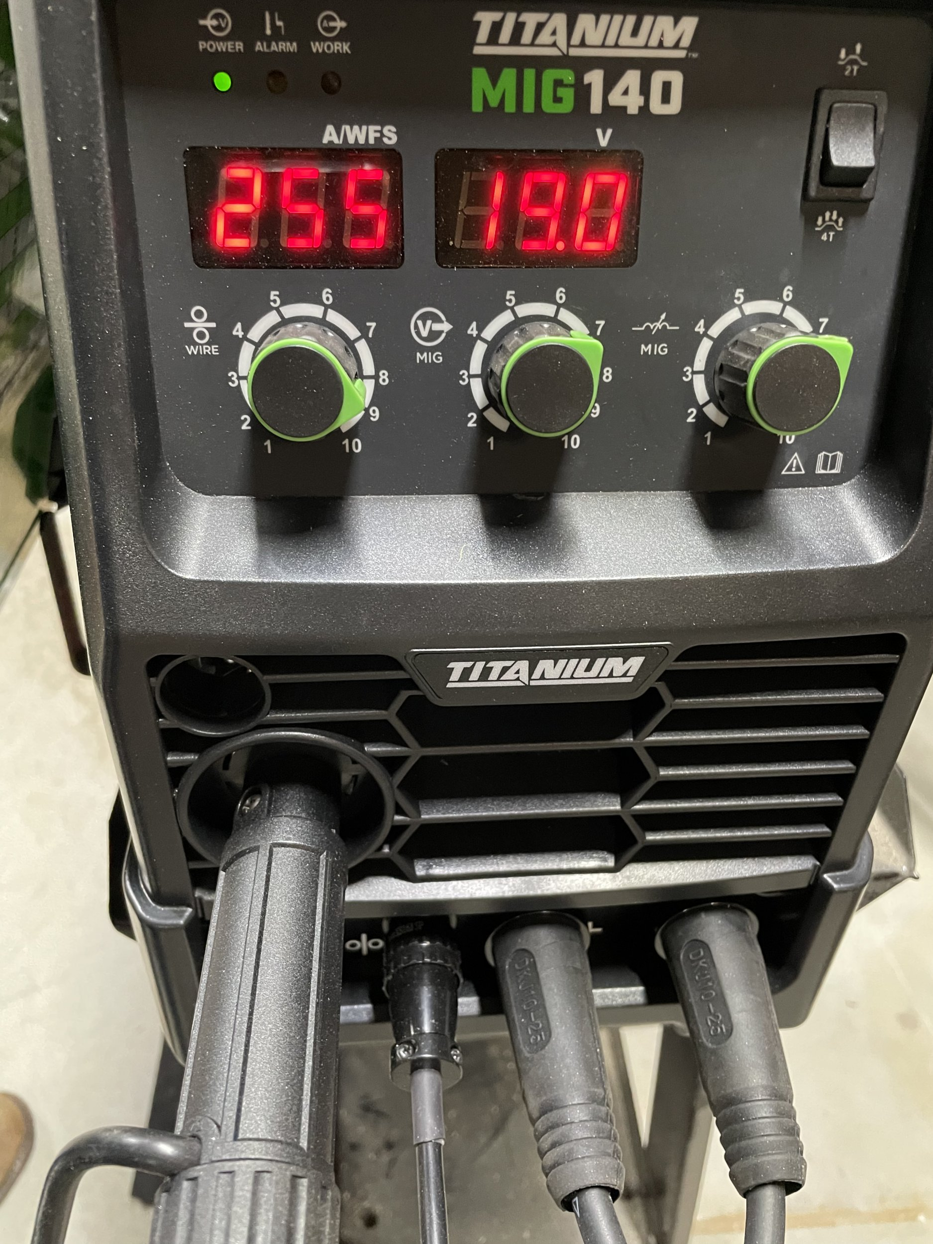

Ok, first, I could've sworn my wire was silver but instead it was gold. Bought Miller .30 flux wire today and at the settings you'll see, the results were worse. The photos below is with the newer wire.
Im open for more advise and curious what I'm screwing up
Ok, now change the polarity. That means swap the ground and hot leads.

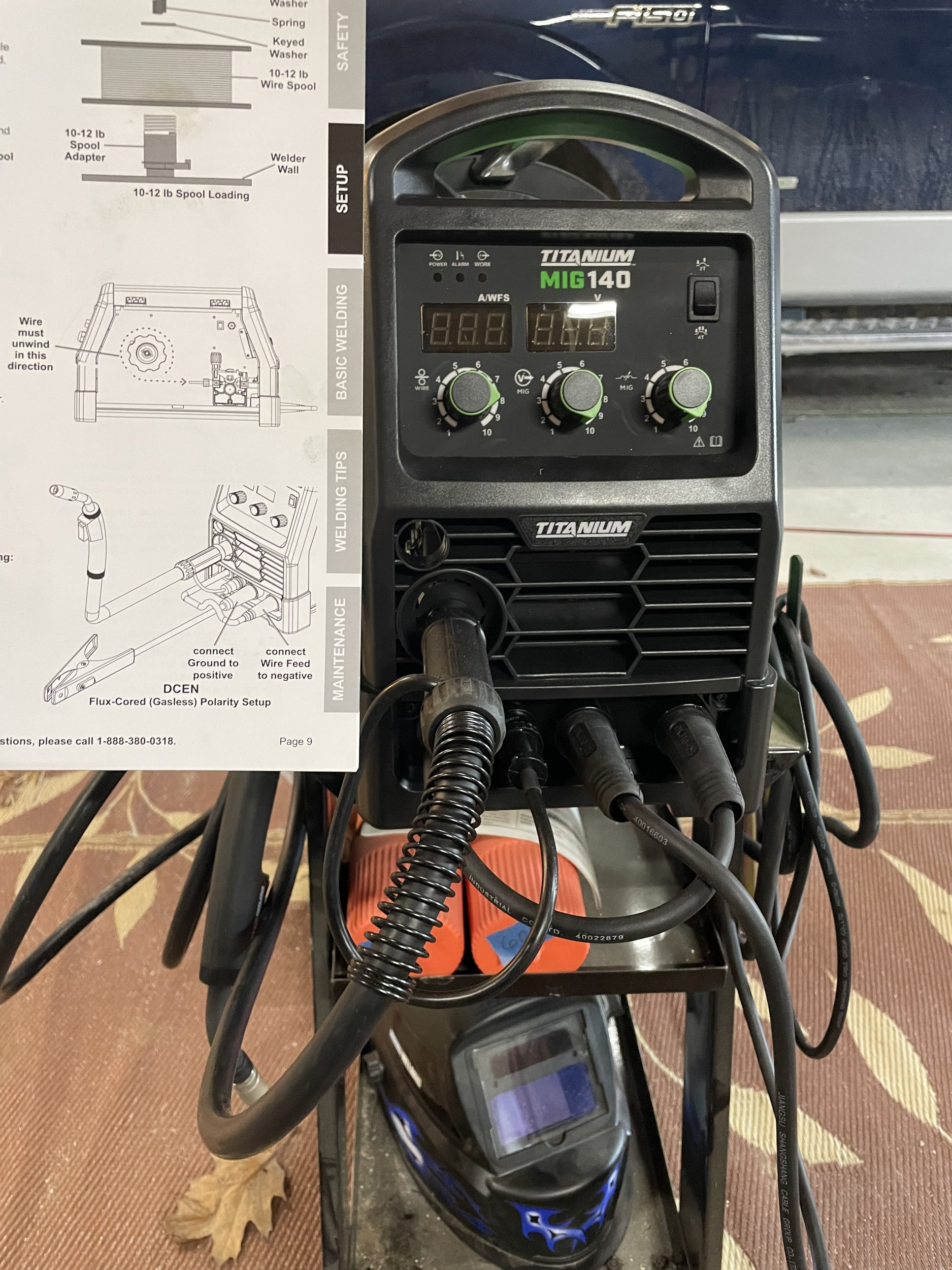

Even though i followed the instructions? Let me go take a pic of the page

Your polarity is correct for fluxcore... But don't understand why all your dials are maxed out.... Is there a chart on door the give you presets (ball park settings) for setting vs material..
thickness?...
And with flux core wire you always drag your bead...

I did not realize you had the polarity correct. Since you were running solid wire thinking it was flux core I thought you might have also have the incorrect polarity. You would be very well served to look on YouTube for flux core wire feed welding videos. Wire feed welding is pretty easy and you should be able to pick it up quickly. If, after watching a video or two, and with your machine set correctly, you are still unable to get even a half way decent weld I suggest going to the welding supplier where you bought the wire and asking them if they have a similar machine to yours that you can run a few beads with. Then you can compare your performance on a different machine.
