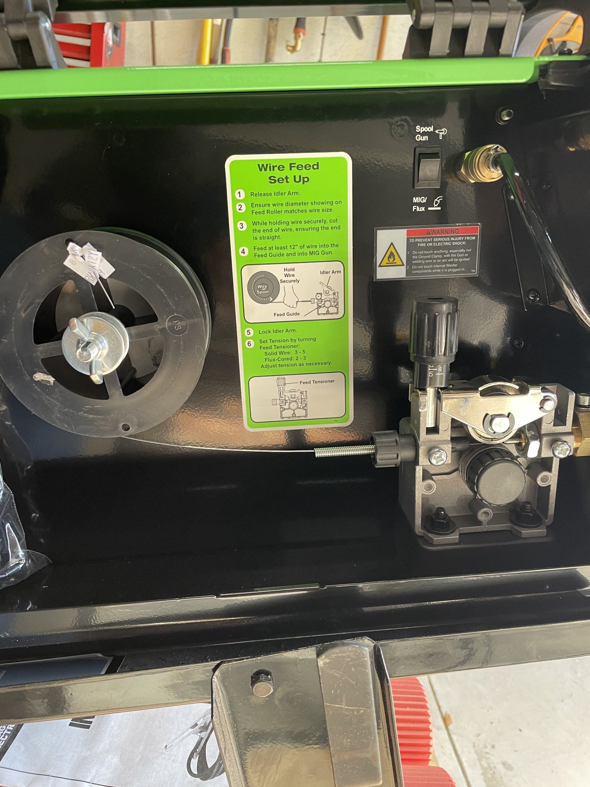

Ok, I'll check but I'm fairly confident the wires are correct and plug into the front of the machine. Where is a good source for a beginner to but good but not expensive wire?
Typically all welders have the work lead (ground) and whip (GUN) lead connected front of machine.... Typical the place where polarity of welding cable is internal in cabinet area with wire spool and feeder..... As for wire, Hobart, Forney, ESAB, Miller... Try to stay with known brand names....
Image below is for my Hobart welder, but its typical of most welders for changing polarity

The wire is the .30 that came with the welder. 2 wires? I only have the one .30.
Just out of curiosity, what color is your wire? Is it copper colored? Like it's been copper plated? Or is it kinda grey, or steel colored? I'm asking because you said the wire is .30. What you really meant was .030. Which is a very common size for solid wire. Which will be copper colored. And must be used with gas.

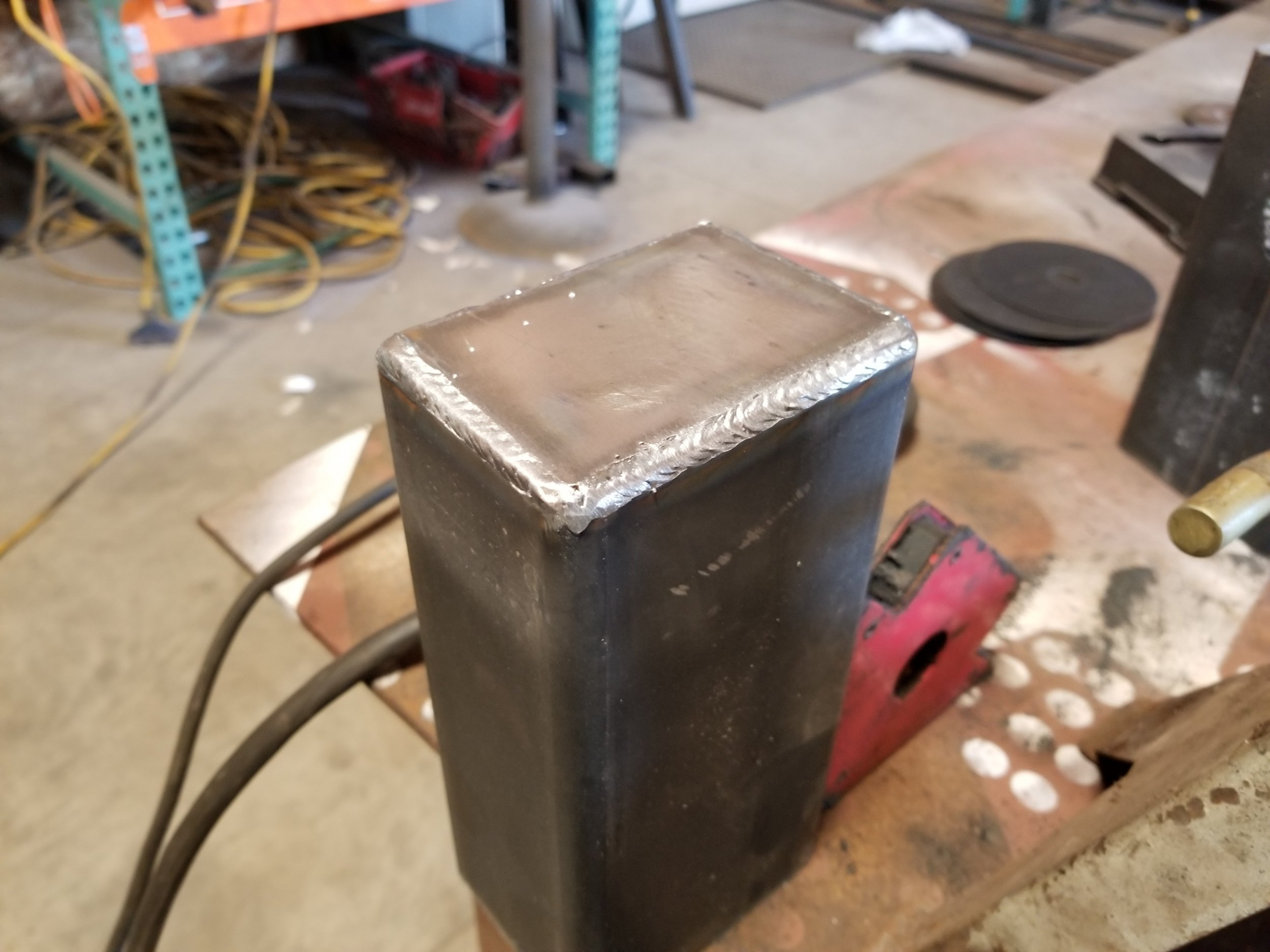

   / Newbie looking for critique #26
I'm not an expert welder by any means but I am an Engineer and it looks like you have porous welds with no slag so I'm thinking you aren't running gas or flux core wire in a MIG setup, correct? It also looks like as others noted that you aren't getting any penetration and are moving the torch too slow.
I've self taught welding and have the YouTube certificate but seriously, alot of it is just practice and try your best to get better. the easiest welds are fillet welds where two pieces come together at a 90° angle. Cast needs to be heated so as not to crack, and deep welds should be filled with multiple passes.
I would suggest looking at welding videos online to explain the different wires and speeds. your welders owners manual can be indispensable as well. I was lucky to start out with a Millermatic 211 so I just set the plate thickness and forget it. I get nice looking welds, try weaving/swirling the pool or just make continuous lines of tack welds.
   / Newbie looking for critique #27

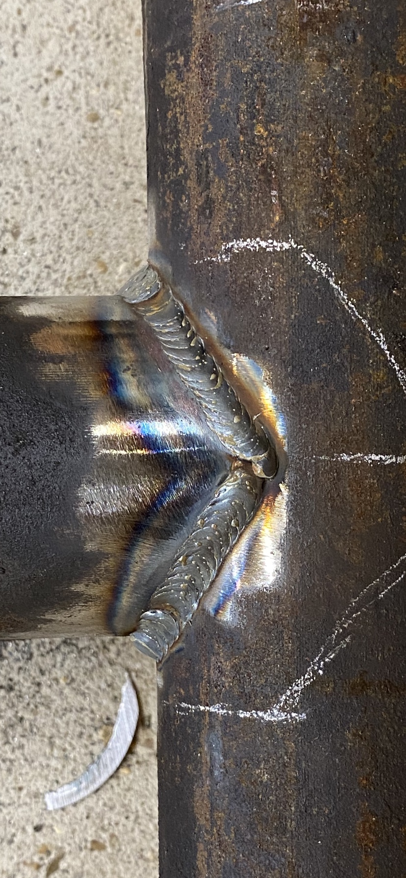

Looking at the two beads on the hook shaped piece: I would slow down wire feed speed. When I weld, I push forward over my weld. Doing that seems to preheat the area about to be welded. Also you welds look like you slowly drew a line.
Try slowing the wire speed, push over what you welded and as you push, make small circles. Like a child drawing a Spring on a piece of paper. 1/4 to 3/8 circles
   / Newbie looking for critique #28

   / Newbie looking for critique #29
With flux core wire, chipping away your slag will reveal a more accurate result. Turn the heat up all the way and the wire speed at around 75% to start. Clean grind the edges of two pieces of steel and butt them together, use a steady hand and let off the trigger if you start to burn through. You can get a decent result with a little welder if you max it out and control the weld by starting and stopping (pulse welding). Burn that roll of wire up doing practice welds and then get some good wire. Hotter is better, if you can’t get the welder to burn through the material, turn down the wire speed until you get good penetration, then adjust your hand speed and settings in small increments. Keep a steady hand.

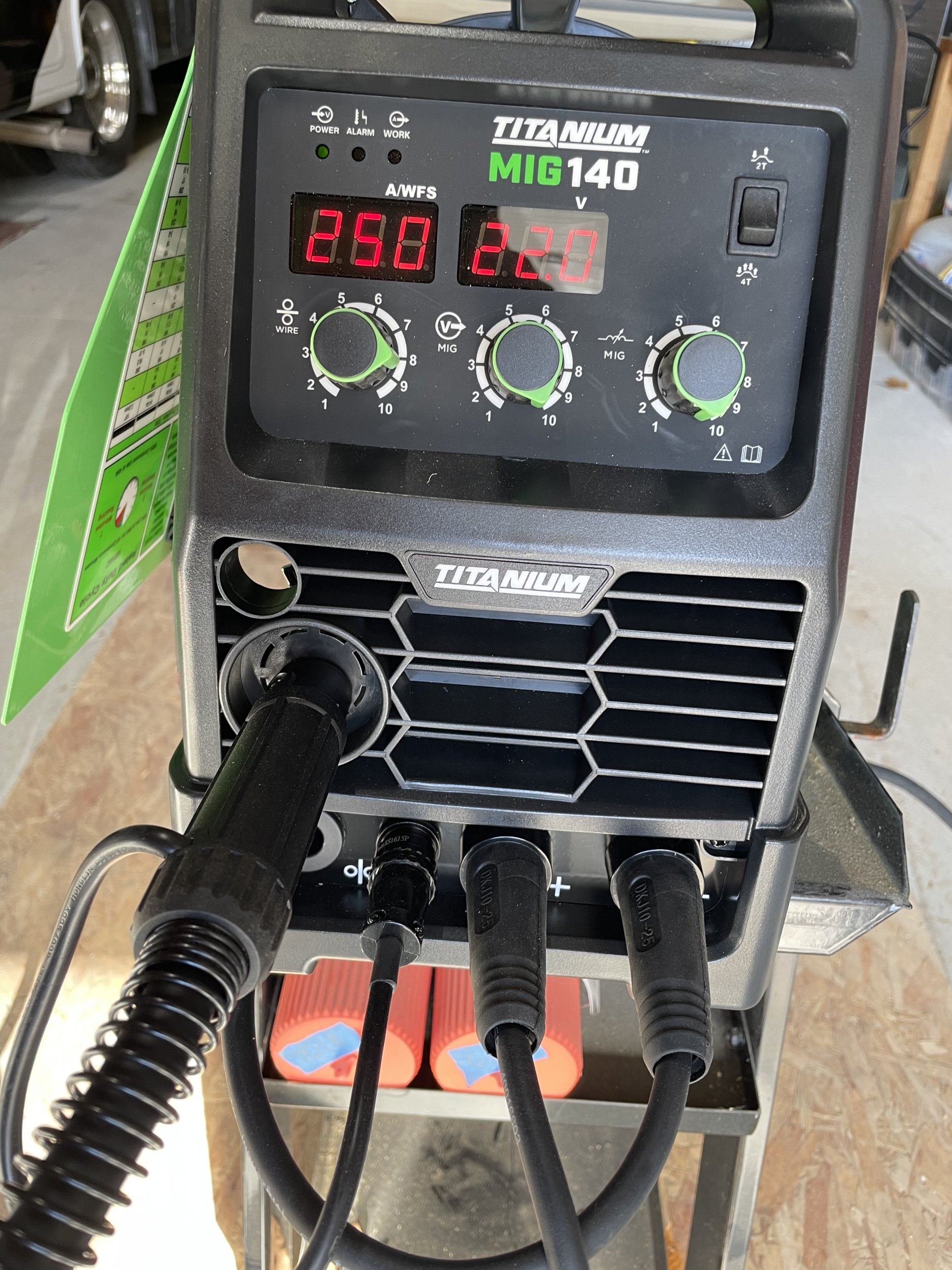

Ok, first, I could've sworn my wire was silver but instead it was gold. Bought Miller .30 flux wire today and at the settings you'll see, the results were worse. The photos below is with the newer wire.
Im open for more advise and curious what I'm screwing up

Ok, now change the polarity. That means swap the ground and hot leads.
Eric
Even though i followed the instructions? Let me go take a pic of the page

Your polarity is correct for fluxcore... But don't understand why all your dials are maxed out.... Is there a chart on door the give you presets (ball park settings) for setting vs material..
thickness?...
And with flux core wire you always drag your bead...

I did not realize you had the polarity correct. Since you were running solid wire thinking it was flux core I thought you might have also have the incorrect polarity. You would be very well served to look on YouTube for flux core wire feed welding videos. Wire feed welding is pretty easy and you should be able to pick it up quickly. If, after watching a video or two, and with your machine set correctly, you are still unable to get even a half way decent weld I suggest going to the welding supplier where you bought the wire and asking them if they have a similar machine to yours that you can run a few beads with. Then you can compare your performance on a different machine.

1. Are you "pushing" or "pulling" your weld puddle? I find that pulling (leaving the bead behind the area you are welding) works better for flux core/stick & Push or pull works on MIG. Your porosity could be slag being trapped in the weld instead of floating to the top OR lack of shielding since your weld is cooling with no flux gas pouring over it if you are trying to push the weld. (Drag the weld) 2. Try slowing down & letting the heat do the work. When I first started with wire feed, I was so concerned with wire sticking & burn through that I moved WAY too fast. Slow it down so you melt the base metal & then move on when it fills with wire. 3. PRACTICE then practice more. Cut lots of coupons from your dump yard steel, clean them up along the weld edges & try welding them together in the patterns you'll need (butt weld, tee joint, lap joint, etc.) Flux IS forgiving for contamination (rust paint oil), but clean steel welds infinitely better & lets you gauge your progress without extraneous problems. 4. I never tried the Titanium welders from HF, but their old Chicago Electric ones were pure crap. See if you can run a bead on a friend's Lincoln/Hobart/Miller & if the results are any better. Could be bad internals on the HF equipment. 5. Like others have said, turn the heat to max & see how that works. If you're burning through cool it down a tad & try again. The HF stuff i tried (CE) was WAY under powered even for it's stated power. 6. Don't know the types of projects you bought this for, but until you can get clean strong welds on the coupons don't try doing anything structural on the tractor that might hurt you or someone else if the weld comes apart under load. Get good at 1/8" then 3/16" before moving to 1/4" or thicker & multipass. If this is for sheet metal type welding, you probably want to drop down to .023 solid wire & gas (with appropriate liners/tips/etc.) as the flux core is ok (if sloppy) for structural stuff, but almost guaranteed to burn through thin sheet metal. Fitzee fab actually did a youtube on it & he couldn't do a decent job with flux core on 18 gauge.
