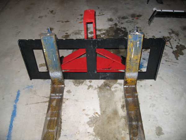

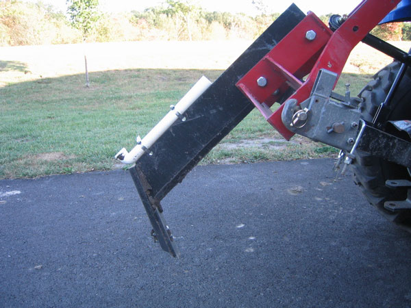

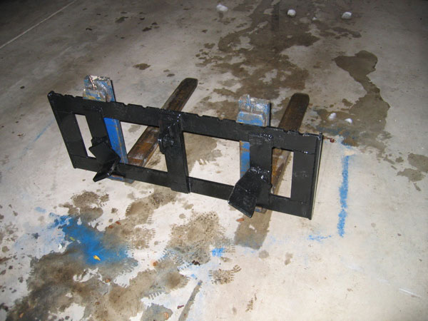

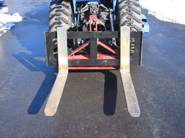

For those who are still undecided, I would strongly recommend the modular 3-in-1 unit because you can build other implements off of the main frame piece. Any of them can be used for pulling cable.
I drilled 2 holes along the back edge of my subsoiler, used 2 muffler clamps, and a cheap piece of plastic drain pipe and it makes a perfect wire puller.
Also, if you spin the frame around and mount it backwards it presents a flush area to build off of. I mounted a fork lift back stop on it by welding 3 pieces of angle iron onto the back. 2 are mounted on an angle to support the weight of the load and transfer the load weight to the red subsoiler frame, a third angle iron piece is drilled with a hole for a top link pin and locks the pallet fork frame to the subsoiler frame. Then I hung the pallet forks on that. It is all modular mounts up in a couple minutes, and each piece is light enough to lift into place. It also stacks up flush against the wall when not in use.
