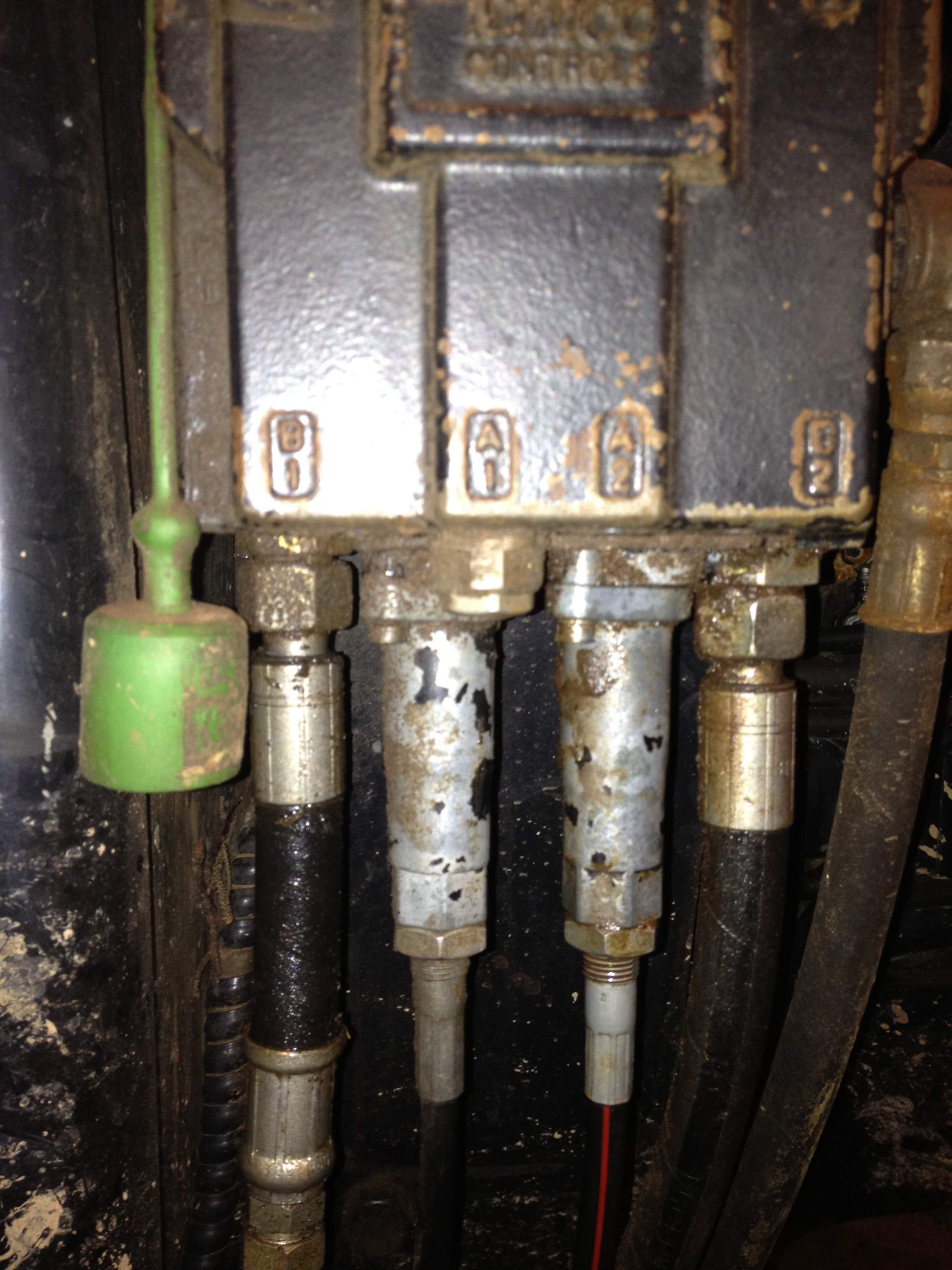

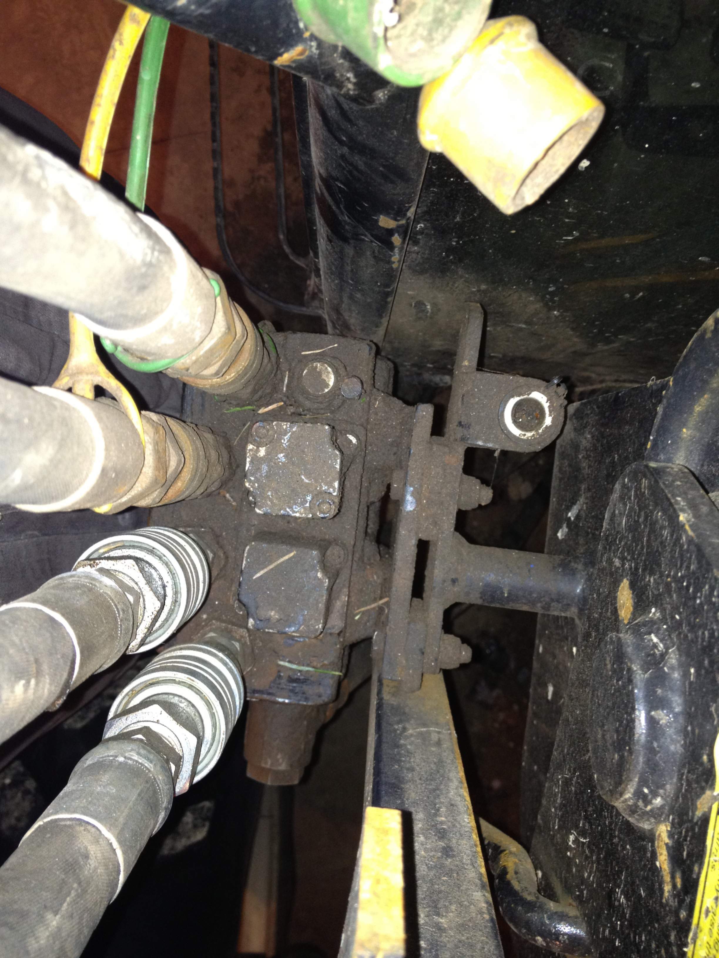

Here are some pictures...
IMG_0216.jpg[/ATTACH]
I didn't notice until now but in the view from the top there are what look like 2 caps, one over each spool. Should I remove those and check, clean, etc? Also if I want to remove the cable does it fasten directly to the spool?
Thanks!

Is it possible for there to be moisture under the caps?

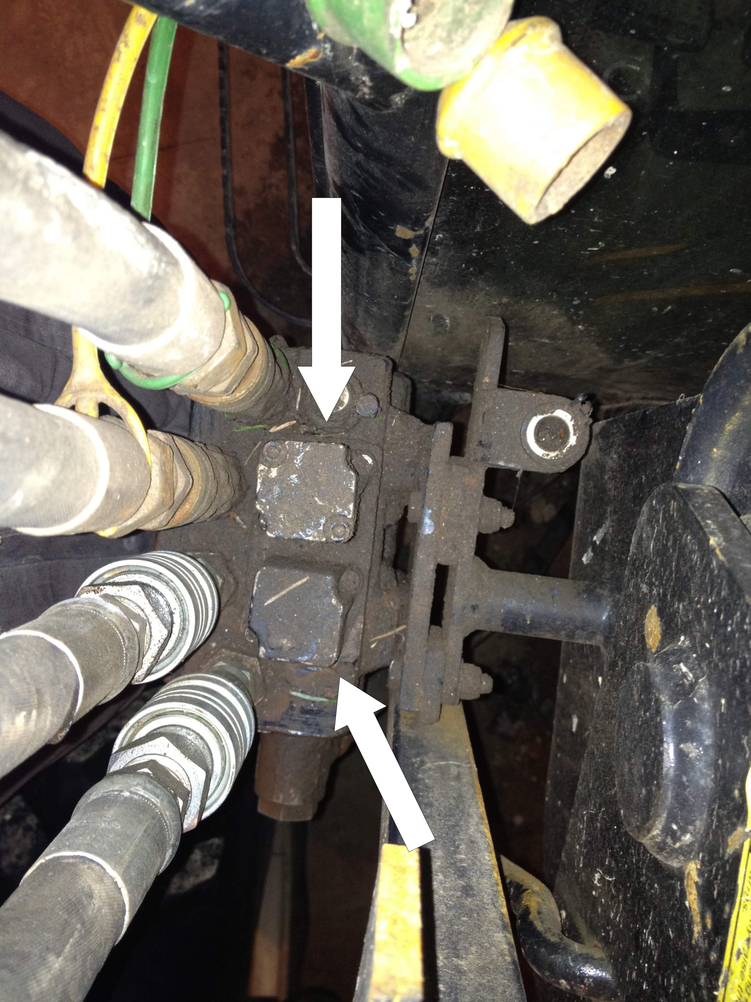

The most common problem of valve freeze up is moisture under these caps. See arrows on your photo.

If I am to remove the caps for inspection is there any pressure on them. I am assuming the springs, etc are under the caps?

I think the quickest and first thing to do is unhook the cables like J J said at the valve and make sure its not the cable freezing up before opening up the system.
   / Nimco Controls freezing
#18
Ok. So to unhook the cables is it just a matter of winding the nuts off on the bottom side of the valve?

Thanks J J for all the info. I really appreciate all the help. I have looked through all the schematics and haven't seen anything on how the cable connects to the end of the spool.
