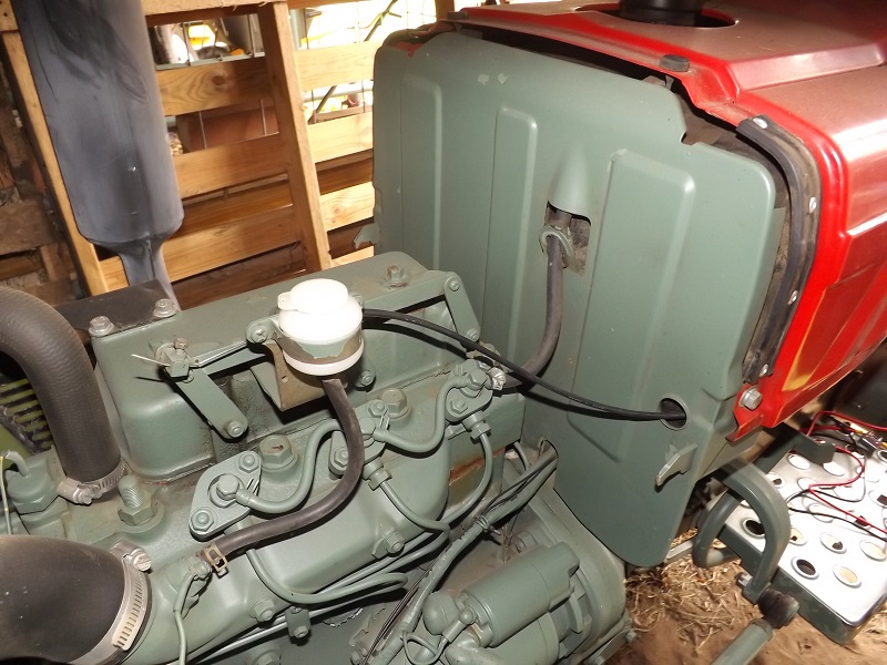

Ok, so I'm back revisiting this. I just put a new ebay's finest voltage regulator on. Still doesn't seem right. Those of you who's charging systems work what do they measure at idle after you start it up, how about 2000 rpm. I'm guessing it should be 14+V or at least mid 13s.
This one was battery voltage when I first cranked up. 12.40 volts. But after about 5 mins I was showing up to 12.6 so it went up but that's still not even a battery at 100% so something seems wrong here . When I test the pin on the connector closet to the center of the alternator, the 2 pin connector is what I'm talking about, I get 20+V. The big wire on the back just shows battery voltage. This large wire on back I would guess should be showing at least 13.5 if I'm charging as should the battery...I would think.
Thoughts?

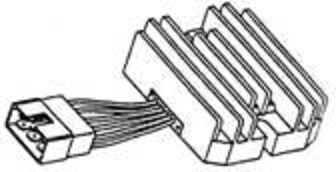

Do you have the brand or model you bought off the eBay then?
While looking at all of these VRs, many have become a 'generic' to the internals so as other tractor brands can use them. It has me guessing what's the real type to work on my machine and yours.
I'm attaching a Yanmar Service Bulletin I happen to find. This was in 3 different languages too.
So, IF the newer VR is used, then this dummy unit thing isn't needed on the tractor.

It's china made. It was like $20 off eBay. I will have to go see what the box says. But if you look on eBay and search yeanmar ym2000 voltage regulator it's one of the ones that come as up from many different sellers it rangers from like $20-25. It's a solid state electric one. My light is not on, it was I think flickering at the start of this whole ordeal, bit I forget so much I will have to go ba k to read my original post at this point. But the dash has no light on.

Box says Transpo number ih811 I guess is model number. That's on the box

No voltage regulator will put 14V in a bad battery unless the battery is very bad and not charging no matter the voltage across it.
Another bad scenario is that you have a shorted cell so your 12.6V is 5 cells at 2.5V each which is overcharged. We used to use hydrometers to test charge on each cell. When low/no maintenance chemistry appeared these fell out of favor because they required too much skill to know whether the battery was good or bad. Different electrolyte chemistry has different densities so what fails for one is perfectly good for another. But try teaching that to the counter help at the autoparts store? Nonetheless, if you still have one, use it to compare every cell. Don't worry about absolute values. If one stands out as odd then in all likelihood your battery is bad.
Yes, healthy regulator, alternator, and battery should hit 14.4V. At reasonable temperatures a fully charged lead-acid battery will be 12.6 volts under load but requires 13.6-13.8 to charge to that state.
With any luck your battery is simply low due to previous bad regulator and hasn't got to where it is going yet.

Clemsonfor, your original post back last Oct. sounded to me like it could be a bad battery. It wasn't clear to me just how you tested it.
Anyway, the first thing I do when a battery reads low is make sure the battery is good. I take it out, charge it overnight with a smart charger, and then let it either sit overnight or put a mild load on it for half an hour. Load/time takes the surface charge off the battery plates so you can determine if the battery is good.
If it is still holding over 12.5 volts the next day I figure it is a good battery, and if it holds over 12.25 I figure it has a little life left. Anything less than that might start a Yanmar with a compression release, but can also make charging voltage measurement less reliable. If the voltage is at the low end or debateable, I may decide to let it set a few more days - or put it back in the tractor and check charging voltages at various RPMs.

Are we talking about a regulator for YM2000? It's the same regulator (and alternator) as early 70's Datsun. Datsun/Nissan went to a slightly different alternator about 1973 but the same regulator continued for a few more years. It might be easier to find voltage specs for Datsun instead of Yanmar.
The regulators were originally mechanical with points and high-amperage bleed resistors, while the modern replacements are potted semiconductors.
If you have no improvement after replacing the alternator, it sounds like you mighty have a bad ground or connector somewhere. I think this is more likely than a weird battery.
Or possibly one of the multiple diodes in the alternator is bad. This happened in my Subaru, dim headlights at night but never a dead battery. I finally got it tested and learned I had been running at minimal charging current for a couple of years. As I recall the replacement alternator was $160 at Autozone, compared to the $29 or so you are looking at for your alternator.

Yes we're talking the late 70s Yanmar regular. I have the kind on it and that I replaced where it's bedded in epoxy and sealed. I have checked the late 70s nissan alternator off Rock Auto and it's under $40 more like $35. There is two sizes a larger output and smaller output.
I had your very same thought about a bad ground. I need to take the main ground off at the battery and frame and clean it up. Also try again to clean up the alternator ground.
