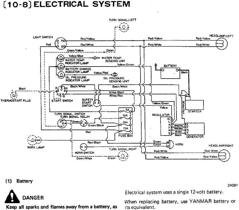

For YM186, and other 80's Yanmars with the pancake alternator and diodes external, I posted a test diagram in Post #7 of this thread. The thread also discusses the earlier pancake alternator with internal diodes.
And here is the YM186 wiring diagram, that uses that alternator. The diagram is likely applicable to similar Yanmars.

Pretty straight forward still on a YM 2000. My dash light would flicker!! Chased that for months and finally stumbled into it. Loose bad connection on my fuse panel. More corroded than I would have thought. That was more of the problem. Still ? how I found it!!...... Drove me nuts... Here is the 2000 dia. I just had out for anyone who may need it!!!!
