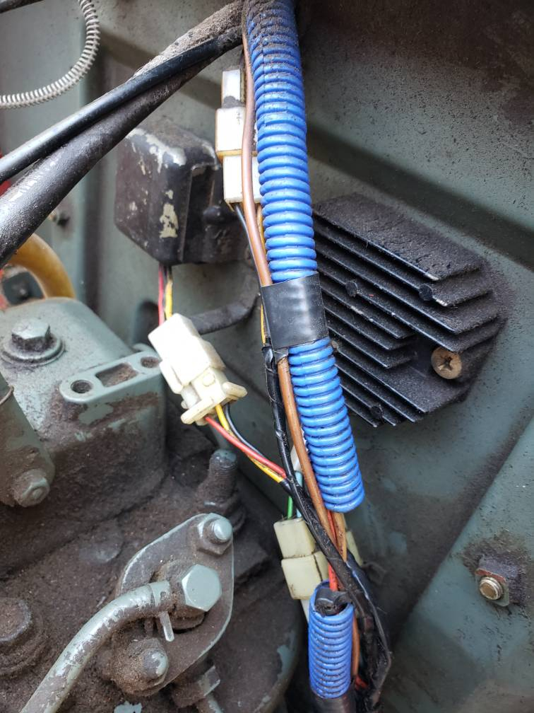

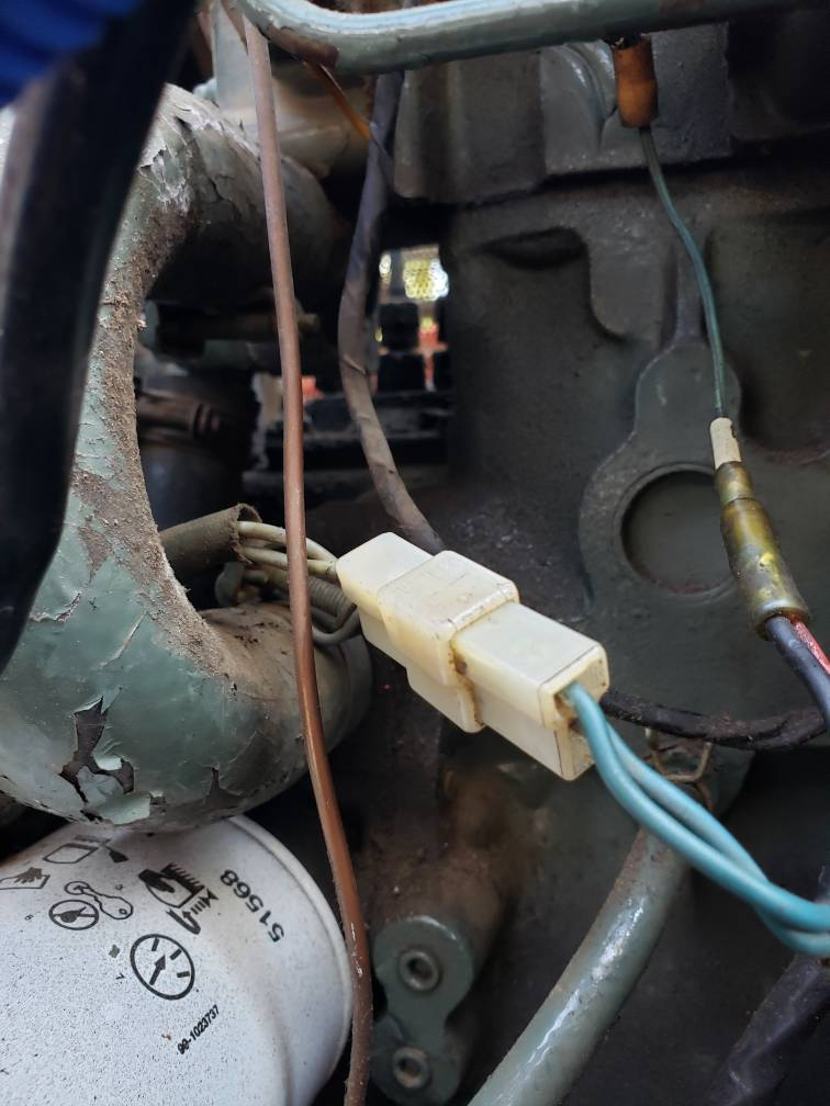

Here are pics of mine.

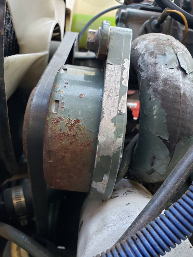

Read this thread because I have a no charging situation on the YM 2020D. This alternator does not look like what you guys have. See picture. Hoye says its a dynamo. As I trouble shoot this, should I be getting DC volts out of the two wires from the alternator/Dynamo or AC? I checked today on DC and had no voltage. Its a $150 part so want to be very sure before I purchase.

Dynamos put out ac voltage that will vary depending of rpm.
/ Not Charging #90
Looking at the above pictures, that looks to me to be an alternator, not a dynamo. I do not know this set up, but, if it was mine I would set my volt meter to AC, then put the positive lead to one of the two output wires and the other to earth [ground]. Take a reading and then check the other output wire the same way. At a guess, one might be larger than the other. Now I'm still guessing, but the one with the largest output probably goes direct to the battery. The other, I'm still guessing, is from a voltage regulator somewhere on the tractor, that might be next to a rectifier. Whilst I have my multi tester in my hand, without the engine running, I would set the meter to resistance and check there is a good reading between the alternator and the tractor chassis. Lots of guessing here but I hope it helps.
