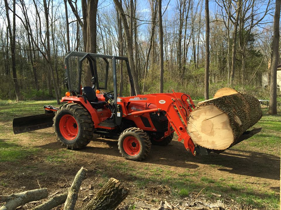

I just showed those because that's the size you were asking about. I like the way you are thinking now.
Honestly, I think you'll be disappointed with a sub-CUT. Acreage has nothing to do with tractor size. The types of jobs and your expectations about how your tractor does those jobs determines appropriate size. For example, I only have 2 acres but I have the fortunate situation of having near unlimited access to large logs that are too big to chip and too big for my friends wood processor. I can go to his house, load my trailer with his skid steer and unload with my tractor at home. the picture shows the typical size of the logs.
With this arrangement I can get a huge amount of wood in little time and almost no physical effort but a SCUT would never unload these logs. I also don't think I would enjoy moving snow with a 1500 pound SCUT and certainly could never clear all the driveways I clear in the time I have. If I only was doing one small driveway the SCUT would be fine. But I do many large driveways.
I also give hay rides at a large orchard. Trailer weighs 7000 pounds loaded with people an the orchard is hilly. The funny thing is, I never planned to do any of these things. I just started doing them after I had the first (smaller) tractor. But even that tractor was much heavier and more capable than a SCUT. The hayride is one of the big reasons I went to the larger tractor.
My point is, really think about what you expect a tractor to do. And if you expect a tractor to do big tasks, you need a big tractor and something lighter to mow with. If you expect it to do smaller tasks, maybe one machine can do both.
