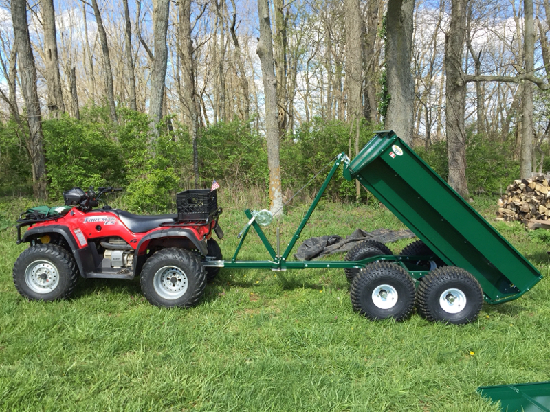

OK, picked it up yesterday, for about US$1300 before tax. Here is how far I have gotten in assembling it. <img src="http://www.tractorbynet.com/forums/attachment.php?attachmentid=476636"/> Hey, at least it made it into the bed of the pick up truck!
Ok, tonight I started the assembly of my new Woodland Mills trailer.
First, remove the cardboard box, exposing the parts all nestled in the steel crate:

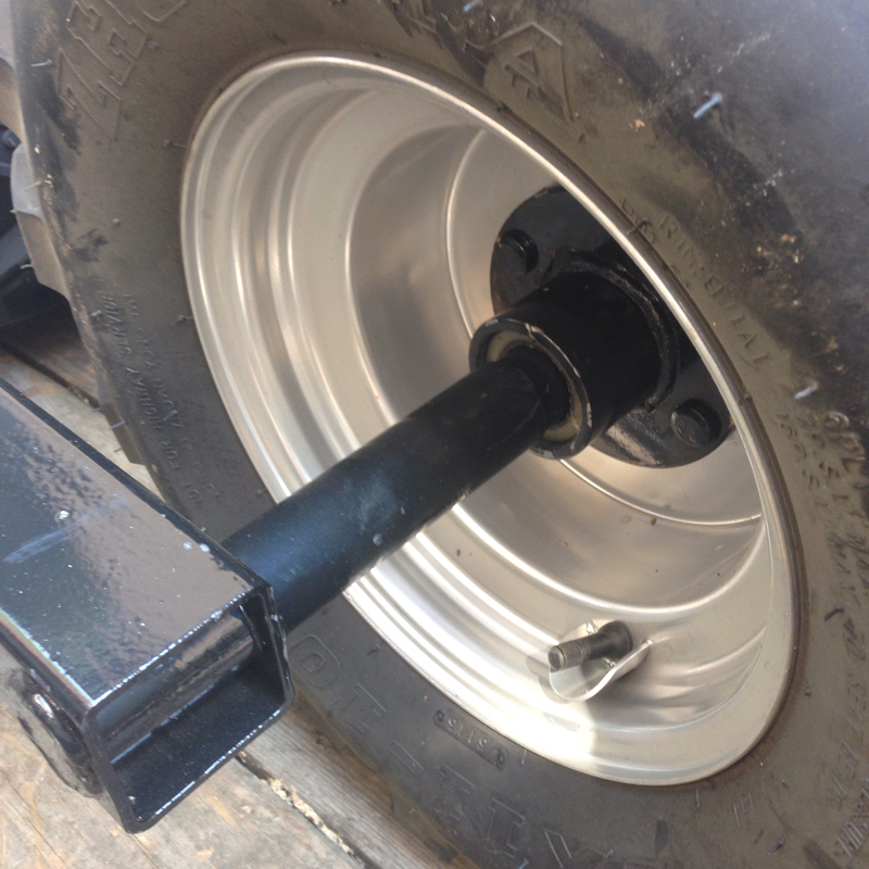

Here is a close-up. What do you think?

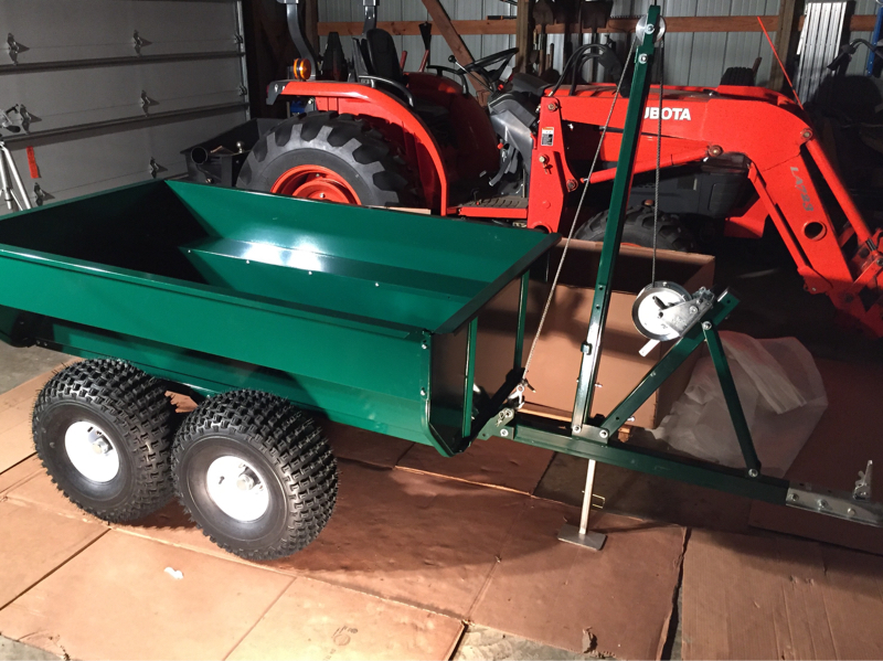

OK, it is tomorrow now. Finished most of the frame. Now I just have to get that 200 pound steel dump box down off the pick up truck and onto the trailer frame.
The fact that the stub passes through the frame is good. I've seen some where they were just butt-welded onto the frame. The frame looks stout enough to avoid getting twisted by the load (especially when you consider that it's just one of 4 wheels supporting a trailer with up to 2000# of payload.
How does it look where the walking arm attaches to the main trailer frame?
