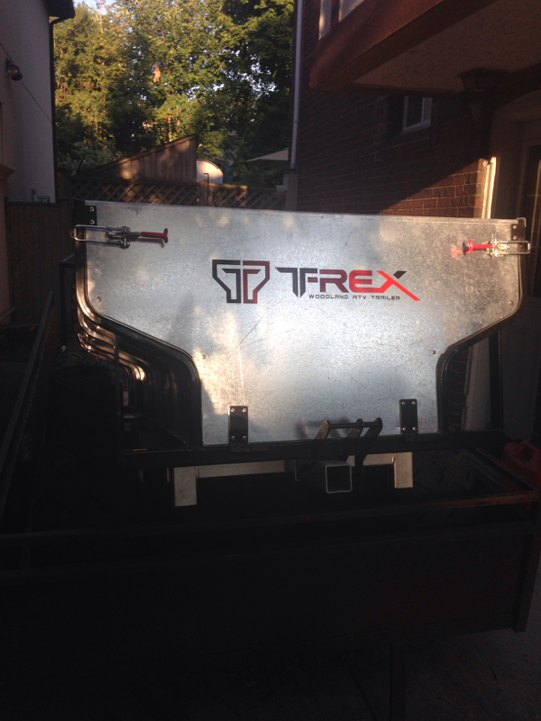

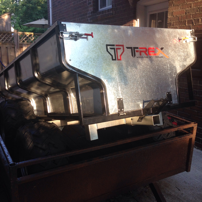

Here's how far I got with T-Rex yesterday:
More to come!

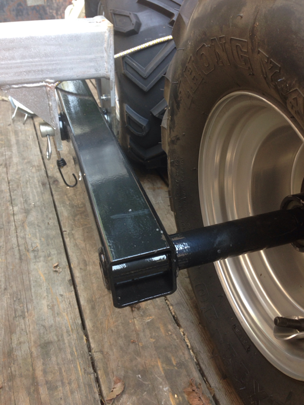

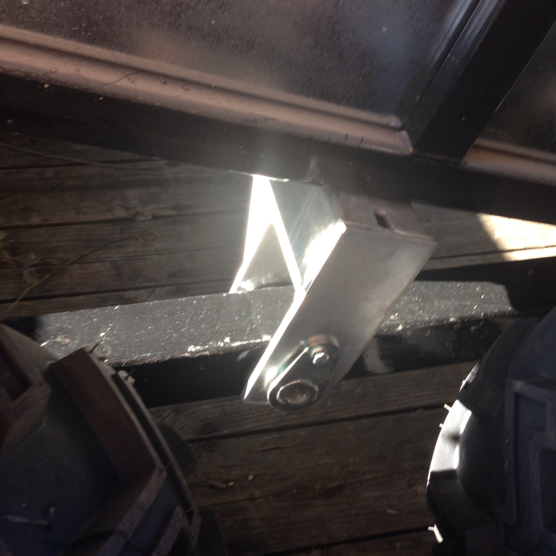

The fact that the stub passes through the frame is good. I've seen some where they were just butt-welded onto the frame. The frame looks stout enough to avoid getting twisted by the load (especially when you consider that it's just one of 4 wheels supporting a trailer with up to 2000# of payload. How does it look where the walking arm attaches to the main trailer frame?
Here is a shot of the pivot itself. That square tubing that you see is part of a big cross that forms the basis of the whole centre of the trailer frame. Very heavy duty.

Here is a shot of the pivot itself. That square tubing that you see is part of a big cross that forms the basis of the whole centre of the trailer frame. Very heavy duty. <img src="http://www.tractorbynet.com/forums/files/attachments/477201-off-road-dump-trailer-options-image-765463311-jpg"/>

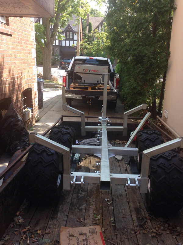

Here's another picture that I took before I put the box on. You can clearly see the big t (cross) that forms the centre of the frame assembly.
