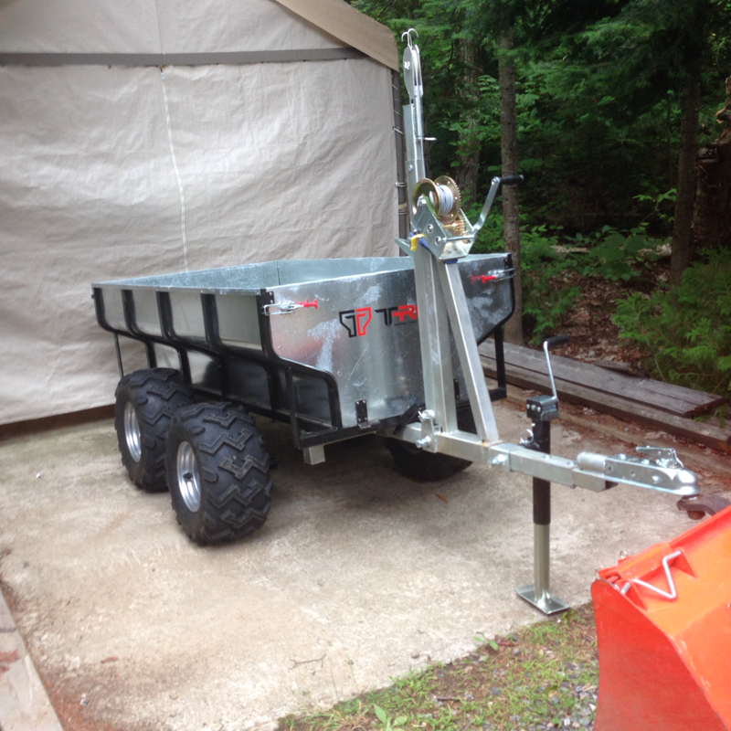

T-Rex lives! Very nice trailer, very solid, with thick galvanized steel square tubing for the undercarriage. The dump winch works as advertised, and smoothly. The tires reek of VOC's, but I'm hoping that will dissipate with time. One thing it did not come with was safety chains, so I had to spend an extra 50 bucks on those and the connectors. Also, I may decide to extend the front bar, and that is another nice feature that you can adjust the length of the trailer. (Comes in very handy when you remove the box and haul logs.)
More to come after I load and dump some dirt next weekend. Also, I can adjust where exactly the dump box sits, so that I have approximately the right amount of tongue weight when the trailer is loaded. Will have to experiment with that. And I have to add some grease to that swivel mechanism on the front tongue. Kind of a unique feature, that swivel tongue - keeps your ATV from being rolled over if by some chance you roll the trailer!

T-Rex works!
Dump mechanism works great. But, these logs were slightly shorter than the trailer box, so when they shifted back a wee bit, the tongue weight became negative.
Have to move the box just a bit farther forward. (More pics about that later.) 👍
