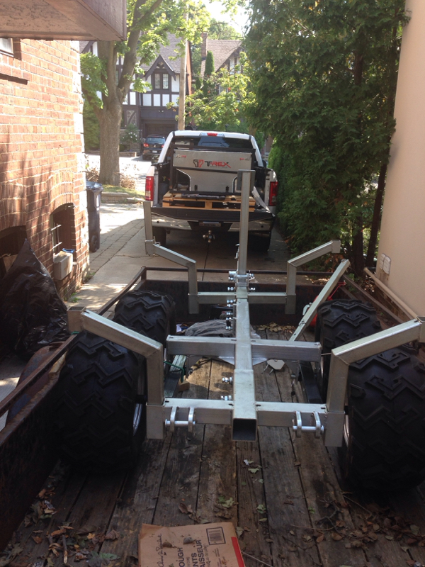

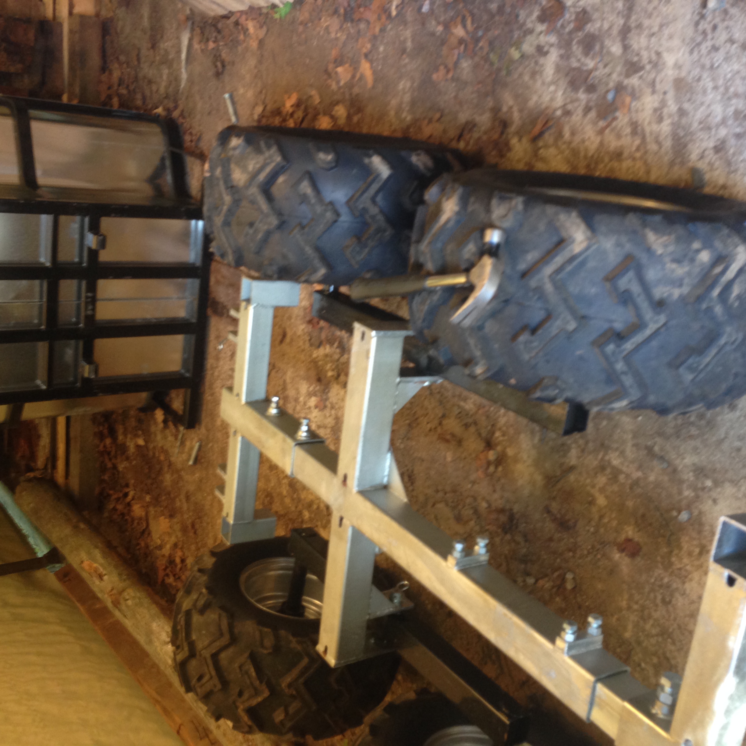

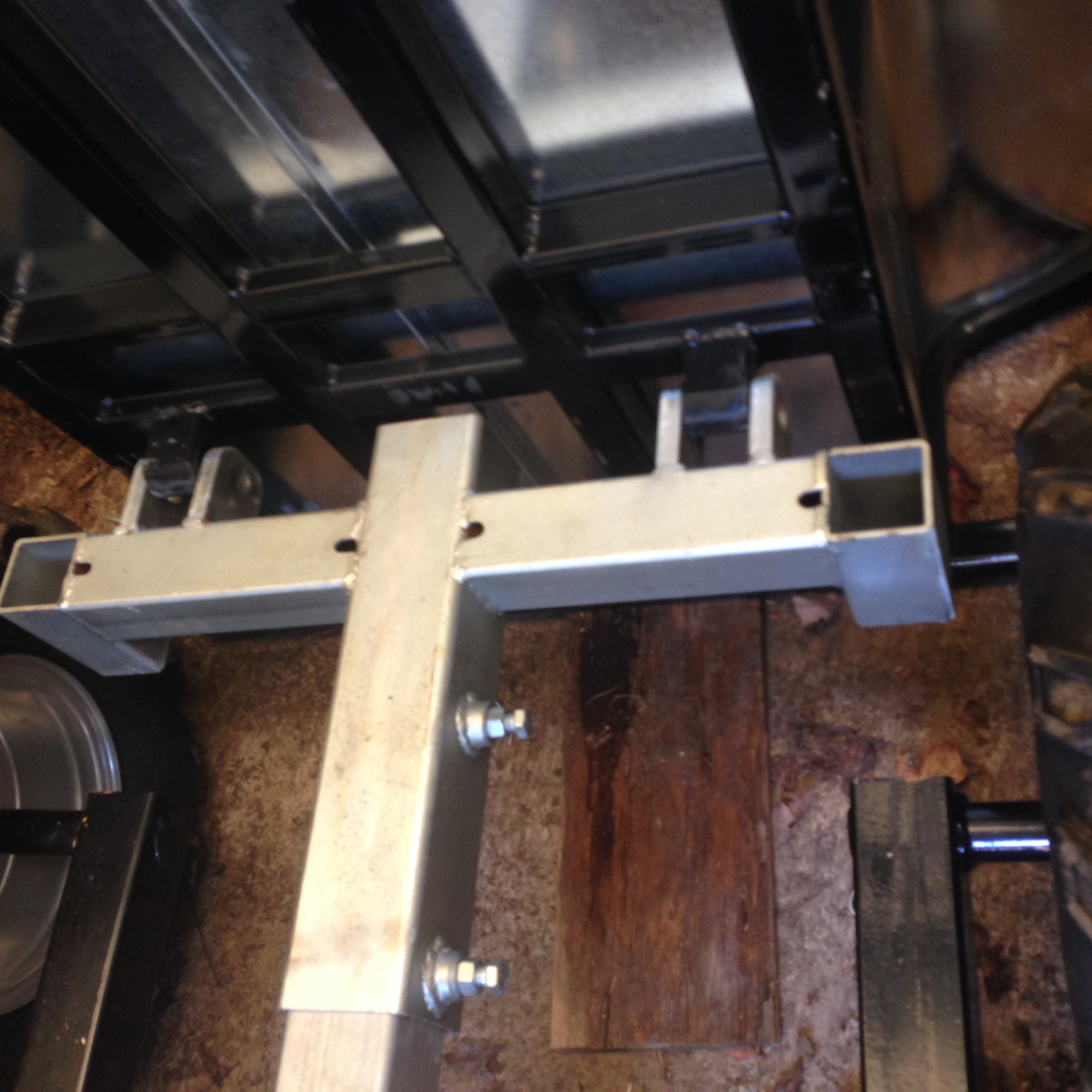

I had the dump box sitting to far back, and wasn't getting enough tonque weight, so I moved it forward. Piece of cake! You just raise the box all the way to vertical so that it sits on the ground, and then disconnect the two pivot pins and pull the trailer forward a bit. As you can see, the part that has the pivot pins on the undercarriage has two set bolts on the side, so you just loosen them and slide that part forward a bit, and then retighten. Then, using a similar procedure with their own set bolts, you slide the front crank tower and/or tongue jack forward as necessary by the same amount. (Or better still, just slide the whole inner square tube forward, which lengthens the trailer again.) Then, reconnect the box and lower it down again. Very versatile system, and you can make the trailer longer or shorter as you wish. So far, so good!
Haven't tried replacing the dump box with the logging-style side arms and tried that function out yet, but will keep you all posted. (See the first attached photo, showing the lower parts of the side arms, which I had on temporarily during assembly.) As I mentioned previously, it is unfortunate that you cannot leave these side arms attached when you install the dump box.

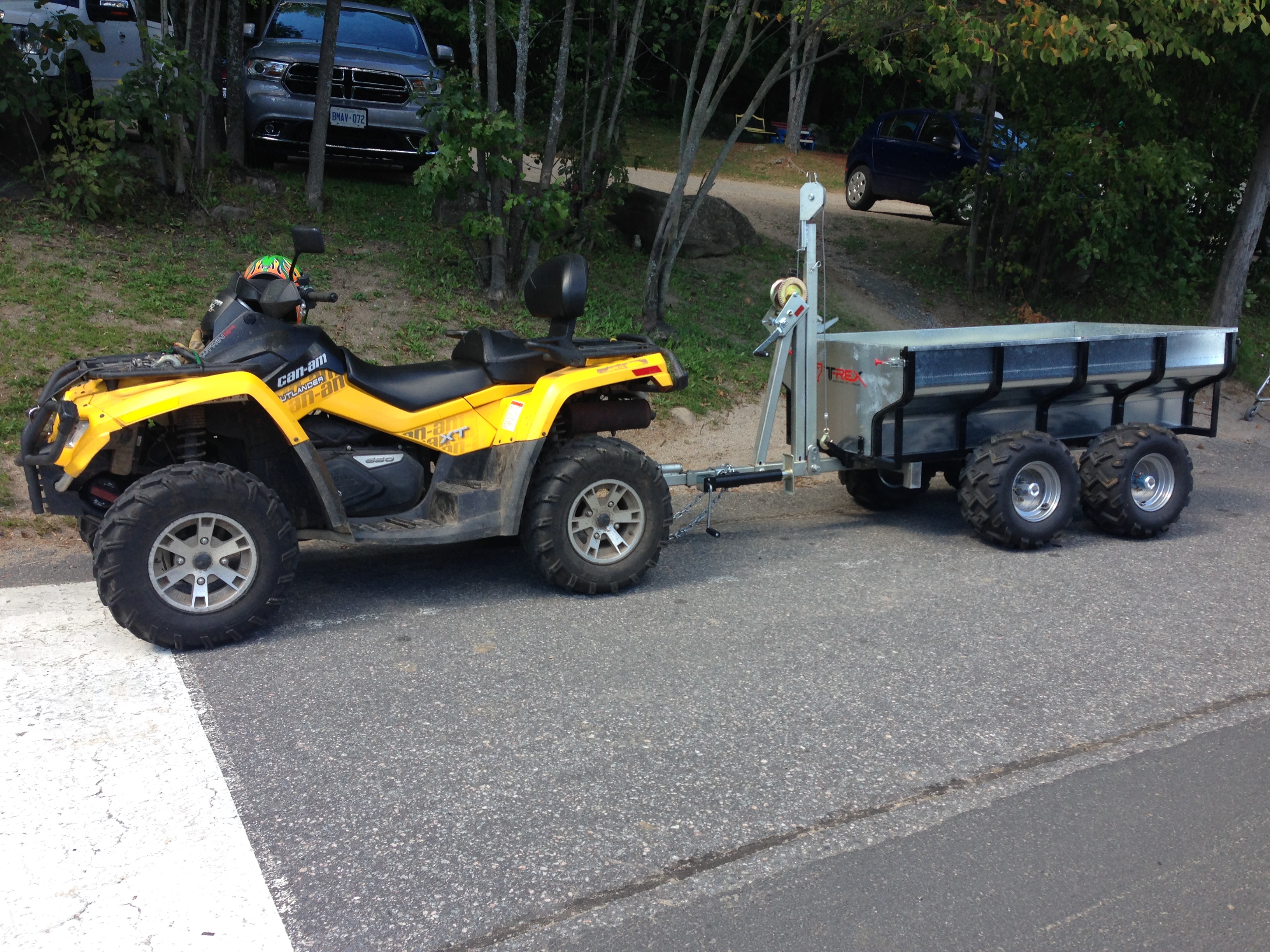

Another little update on the T-Rex: See those pins that go on the dump box pivot? One fell off somewhere, and I noticed that the other one is too small, really. (Too much play.) Will have to get some with a larger diameter, and larger clips for the ends so they don't fall off so easily.
Used it for sand on the weekend. No problem carrying it! And it seems to track along nicely behind the ATV.IMG_7260.JPG
