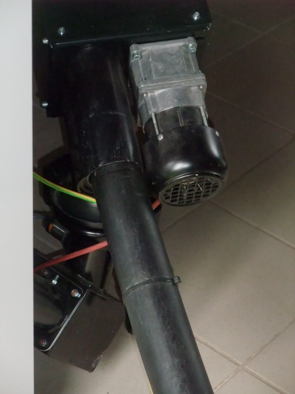

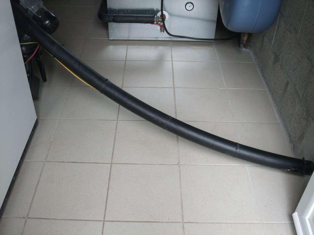

Wow, yes, very nice setup.
How does it feed pellets from storage cell to stove ?
A long metal screw in a black plastic pipe actuated by an electric motor at the back of the burner collects the pellets falling through a slit at the bottom of the silo and feeds them into the combustion chamber. The motor is turned on as soon as fuel is needed. The silo is on the right of picture one. This screw can be curved to some extent to fit your lay out.
