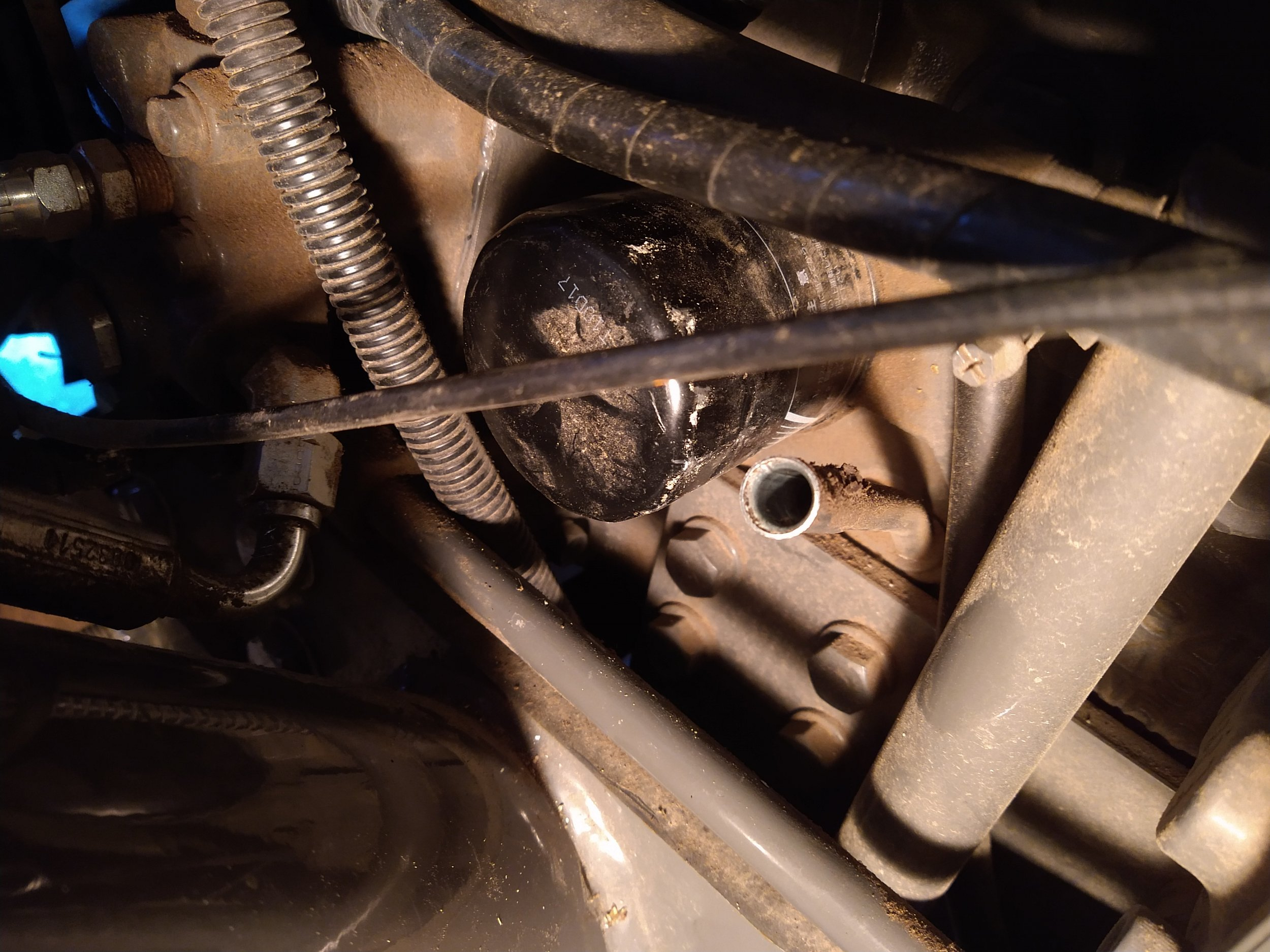

Can any one tell me a trick to get the oil filter off my 1726E? It's tucked down among other stuff so it's very hard to get a wrench on (See attached photo) (and it seems to be on very tight). I've tried several wrenches but none are able to get a good enough grip on it and allow me to exert the force needed.

I don't bother with any wrench on any oil filter that I need to remove to install a new one (exception is the cars, I use a strap wrench on them), I take a long screwdriver and a hammer and shove the screwdriver through the filter and lever it off with the impaled screwdriver.
You are tossing it anyway. jam it in and lever it off. easy-peasy.
Don't forget to check to see if the old filter gasket came off with the filter. Double gasketed filters always leak.

Strap or a chain wrench. Screwdriver thing works too but it's messy more often than not.

Anything that drives off the end of the filter like a end cap wrench, strap wrench, or that claw wrench.

My only oil filter wrench is a pair of channellocks. My right hand is the tightener. Haven't found a piece of equipment it hasn't worked on yet.

Thanks all--Several good possibilities here...

yeah screwdriver time. I use cap type wrench with extension for mine but I needed it for few other items anyways. no sense spending money drive it in and rotate it 1/2 turn should go by hand then

OP cannot get a wrench on it, too close clearance (if you bothered to read his opening comment), which obviously you did not...
Have the same issue with both my Kubota's, why I use the screwdriver method.

I've had good luck with socket type that fit filter,all you need 1/2" socket wrench maybe extension...got mine from NAPA.

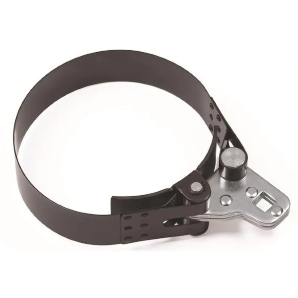

Impaling any filter with a screwdriver sounds messy. I have this metal strap wrench in several sizes. With suitable socket wrench, flex joints and extensions, this wrench has taken off every obstructed, stuck on, upside down, dirty, oily, and SOB filter I've every run across. Only needs a small space since it can ratchet the filter can in steps to turn it. Even tightens (gently) the filter when I can't get my whole hand on the filter.

Kubota has a really bad habit of installing their filters and then painting the chassis. Makes for a really hard to remove filter first time around. Normal strap wrench just crushes the filter case. The screwdriver deal came from my friendly Kubota head tech who happens to be a shooting buddy too. Like he told me, all you need is a hammer and a long blade screwdriver and you are good to go. been doing it that way for years. Haven't met a filter yet that won't come off. They may get a bit ugly in the process however.
I will say the Kubota gearcase filters are a bit tougher to puncture, they have a heavier case to withstand the hydraulic pressure. Takes a bigger hammer.

Not enough room on the tractor engine for this type.
