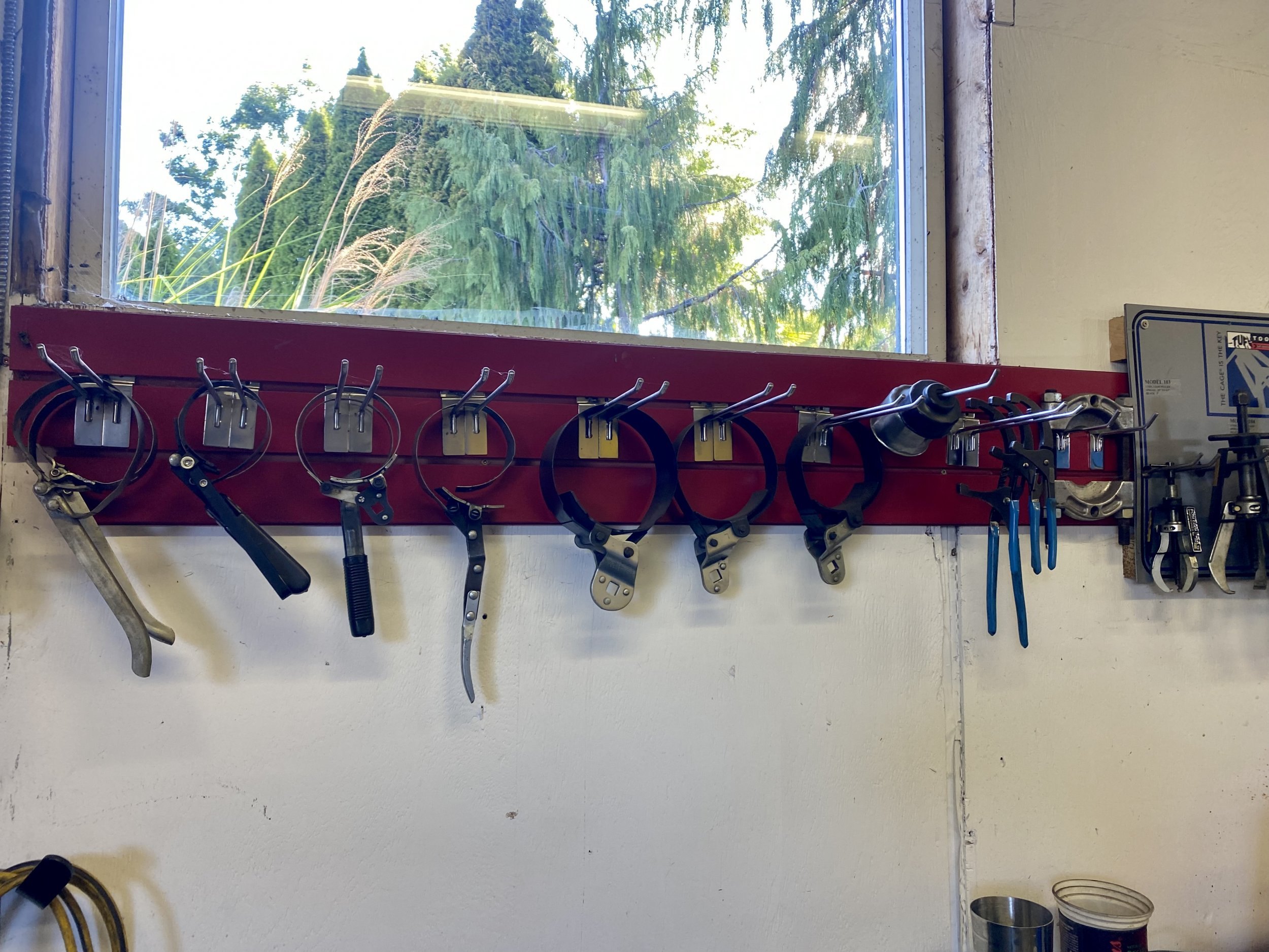

The filter wrench that is form fitted to the end of the filter, (the cap style), is the easiest, most convenient way to remove them. especially in a tight spot. It must fit precisely, to work. But, when they do they work great.
There are about 20 different ones now, and the only way to know for sure is to take a brand new filter out of the box in the store, and find a wrench that fits it. some fit better than others, so try any that seem to be the right size.
I have most of them now, so I usually have one that fits.
When this fails, I move to the more aggressive crushing type wrenches.

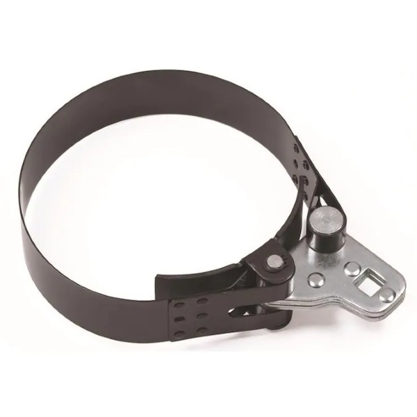

Hydraulic filters are another subject ... The large cans 6 -8 inch diameter are too much for most filter wrenches. The cans collapse BUT... Caterpillar sells a branded strap wrench that is very good. It doesn't collapse the can. Unbelievably, purchasing it at a Cat dealer (p/n 185-3630) is less expensive than elsewhere (Amazon).
Amazon.com: Caterpillar Filter Strap Wrench 185-3630: Automotive

Interesting.....I bought the Gearwrench strap wrench but have not tried it yet. I'll keep the Caterpillar one in mind. THNKS
Amazon.com: GEARWRENCH 3/8" & 1/2" Drive Heavy-Duty Oil Filter Strap Wrench, 3529D: Home Improvement
make sure you take the new filter with you to buy the wrench! i have a universal set that fits nothing i own. thank goodness i still have the 50 year old strap wrench!
