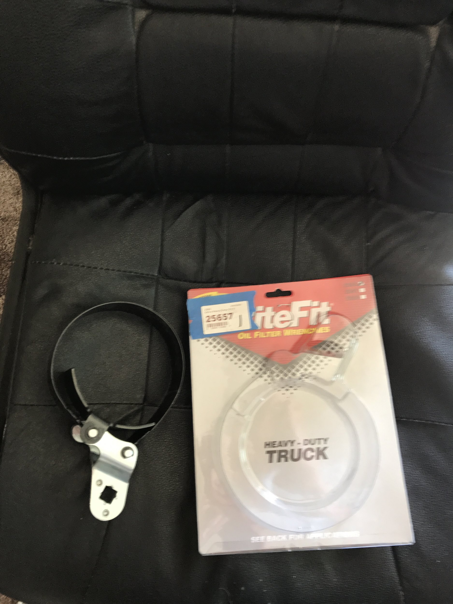

For the biggest hydraulic filter on my LS XR4155 I wound up buying this wrench at Fleet Farm and very thankful I bought it because it was pretty difficult to get loose, had to use a extendable ratchet to get it loose, I’m very confident that a screwdriver wouldn’t have worked. The wrench was about $14. Supposedly has lifetime warranty.

Hey big barn looks like you have a good selection of filter wrenches but I think you forgot one the (screwdriver) 😁
