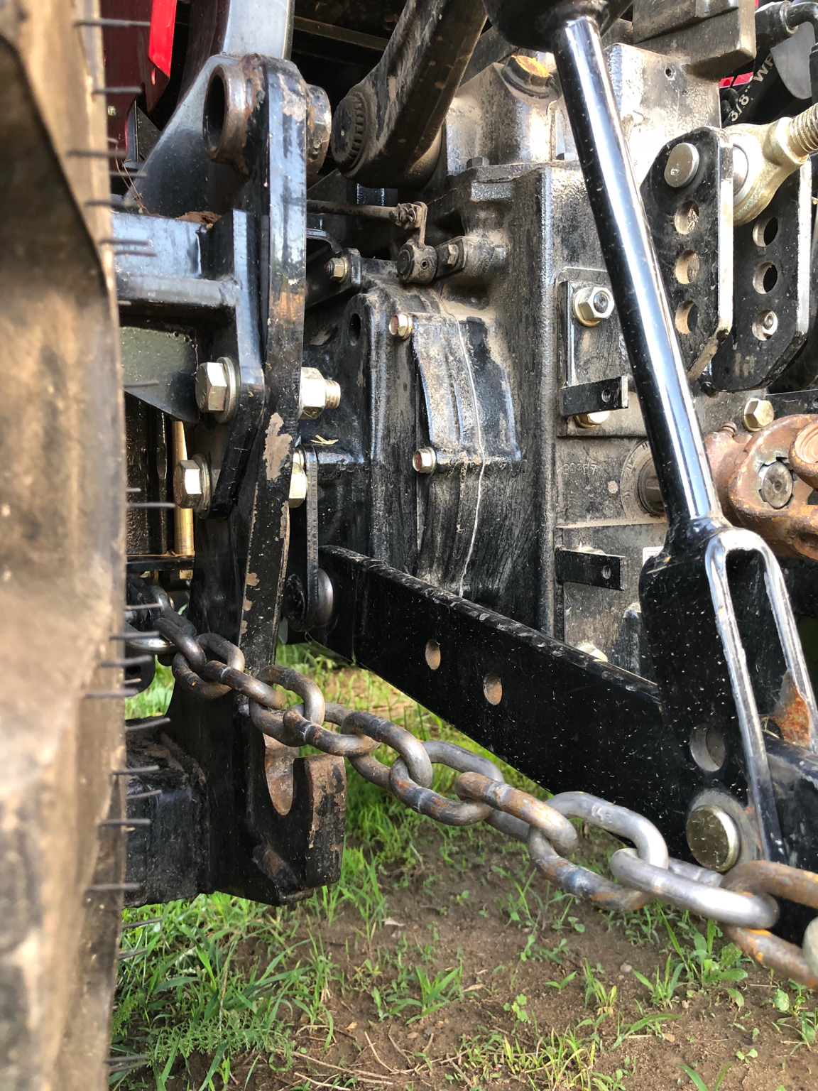

Maybe the two plates that make up the tractor portion of the 4pt have been forced inwards or outwards during your tractor use. And they do not have the same spacing that they did when you took the hoe off. They are just bolted to the axle with those big bolts, and it would not be hard to bang into something and maybe get one to move. My plates were a little too far out and I moved them in a little to give me a little more side slop to get it on/off. I am sure there is some side to side slop in the bolt holes in the 4pt part that bolts to the hoe, too. Not much, but maybe enough to help you out. I know that the ' putting the durn thing back on ' can be a pain somedays. The problem is that moving the bucket, the stick, or either of the stabilizers changes the geometry of what you are attempting to do in about a million different directions/angles. And the attitude of the person wiggling the control sticks can sometimes be a problem. Just the simple thing of lifting the hoe up in alignment with the tractor 4pt, backing the tractor up a little, and then drop'n in place sounds easy. Somedays it is..... :) If you get too frustrated, I have a couple shovels I can lend you so you can still dig.... [[[ :) ]]]
It's not a spacing issue it's a knucklehead user issue. Nothing is bent because I've done nothing with the rear of the tractor 3pt or PTO wise. Since I took the hoe off all I've done with it is push some snow around.

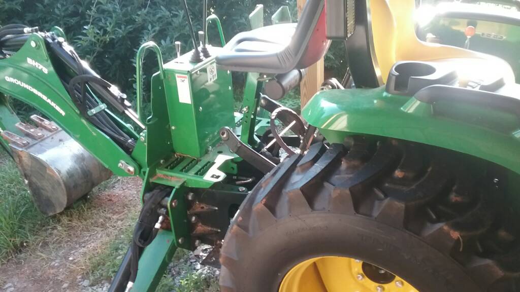

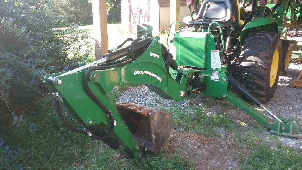

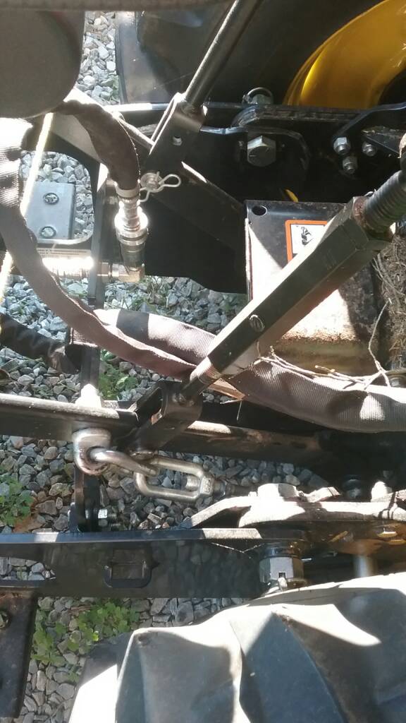

Here's my little lawn mower. I'm 65, maybe I'm missing something, but it should go on easily. I think pictures would help to figure out what's wrong. I just removed mine, then back on. Tractor now has 110 hours, hoe maybe 15. It's easier each time. As someone suggested I think something is bent, out of line, worn, etc.
I just use stabilizers and roll the lawn mower back and forth as needed. Easy. 20180606_183834.jpeg20180606_175209.jpeg20180606_183846.jpeg20180606_183912.jpeg

BTW on my tractor the hole bosses are on the tractor and the matching holes and guides are on the body of the hoe. Sounds like exactly opposite of yours.

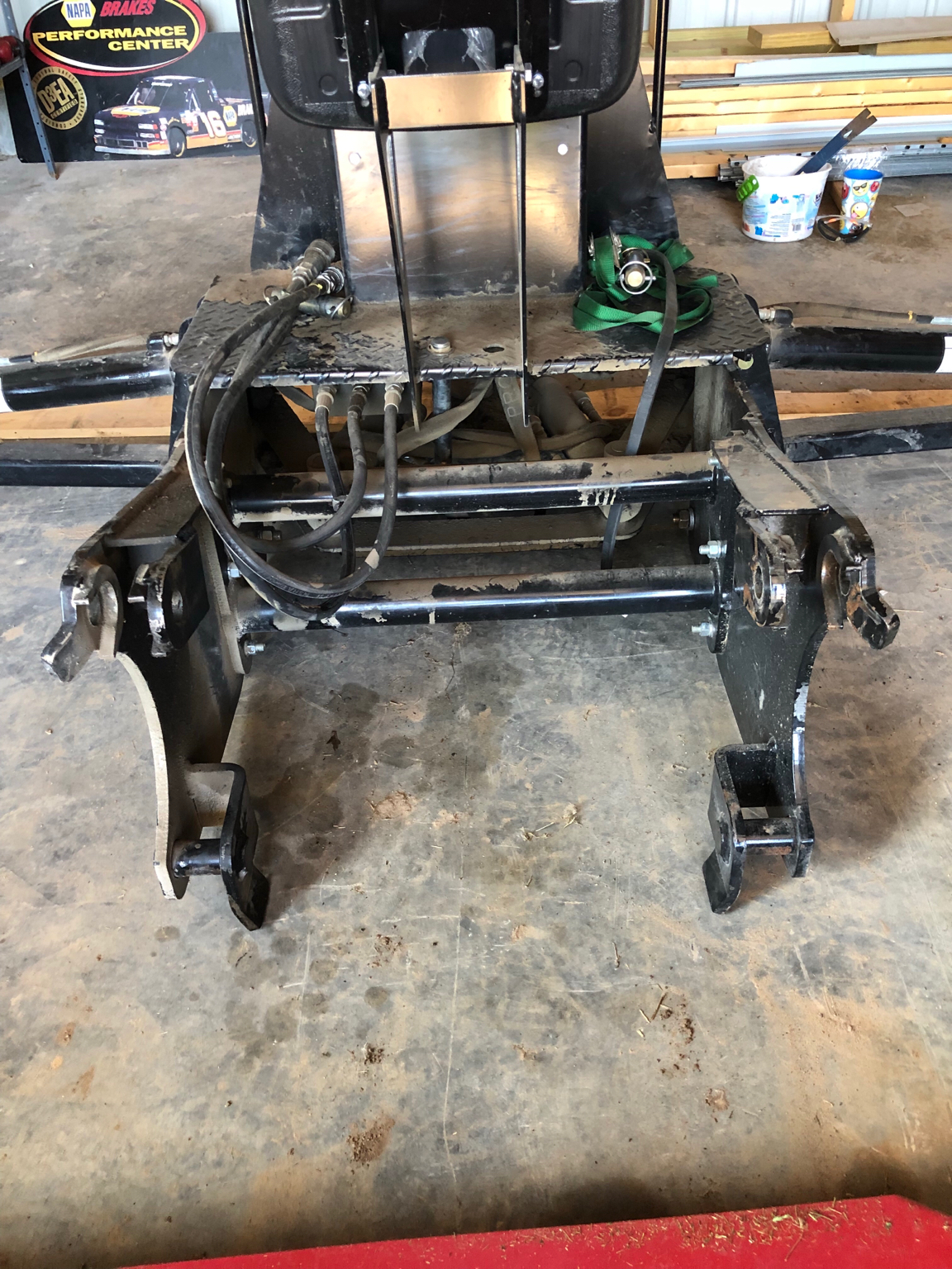

Yep yours is exactly like mine. See those C shaped guide dohickeys welded to the inside? Those hit the top of the pin bosses when I try to rotate the hoe so the pins will engage the hooks. If they were open toward the bottom instead of directly forward I would not be having the problem with the hoe on the dolly as they would tend to aid not hinder things.

notice the hook below the chain and the top boss... is that the same?
Looks the same.

Yours looks completely different. For starters my 3pt has to be removed before I even start. It's tight for space back there. I mean really tight.

I sure wished I was there to see it. Something is obviously wrong, it shouldn't be that tight clearance either. I keep a zippered canvas bag mounted under seat which holds lots of tools, pins, etc. So I easily and quickly can loosen hitch turnbuckles out of the way, then adjust for Bush hog, etc.
It should be almost effortless.

ok how tall is your dolly?
Don't know off hand but I think the casters are 6" heavy duty for the load rating bolted to a 4 X 6 crosspiece laying flat so maybe about a foot. I had to modify it once already to allow the frame of the hoe to rotate more, lower, so I could get the hoe off. The frame of the hoe pivots on the crosspiece. I think it may be a tad high yet. The casters are rated at 600lbs each. I'm using two fixed and two swivels and the hoe weighs about 1200 lbs. I could either get smaller casters if I can find smaller that will take the load or maybe back the back tires of the tractor up onto some 2 X 6s, 4 X 8s or something. I'll study on it later.

I wish I'd thought of driving the tractor up onto something to get it a bit higher earlier. But I was too tired, aggravated, and too POd to think then.
