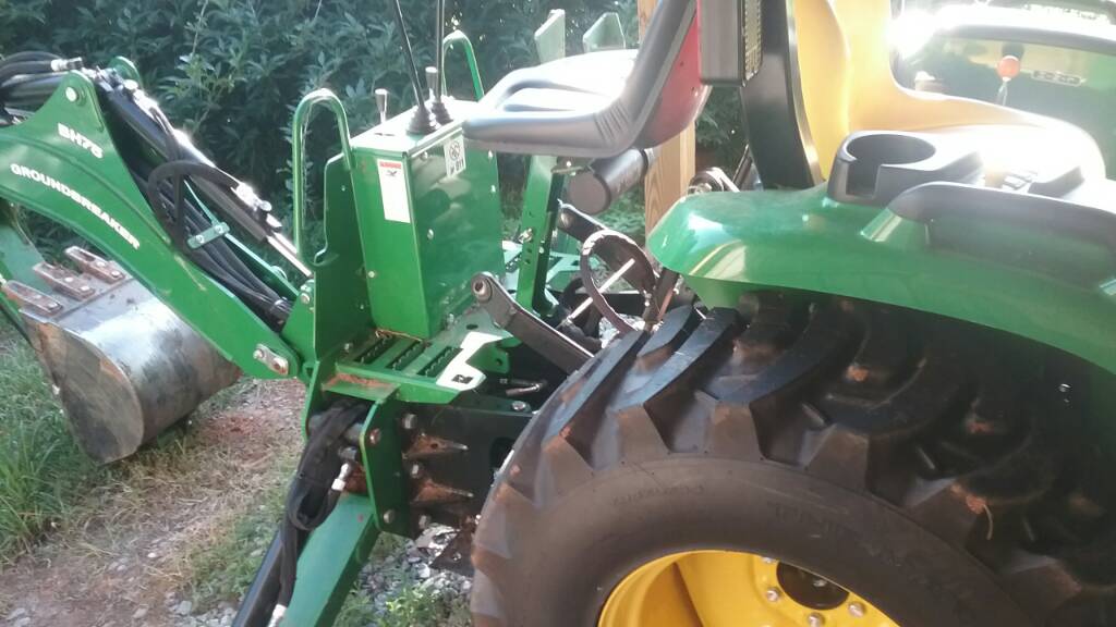

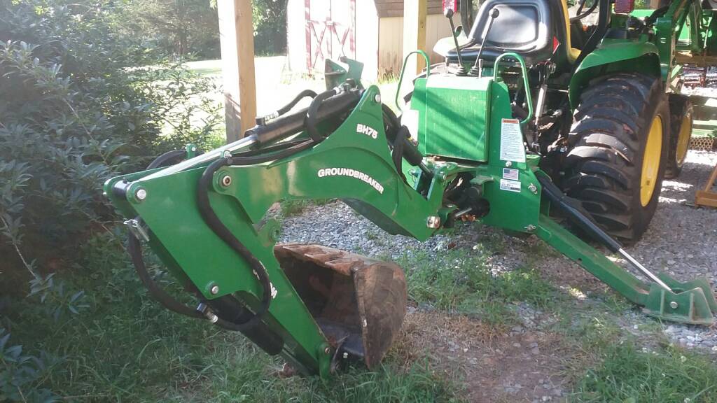

Here's my little lawn mower. I'm 65, maybe I'm missing something, but it should go on easily. I think pictures would help to figure out what's wrong. I just removed mine, then back on. Tractor now has 110 hours, hoe maybe 15. It's easier each time. As someone suggested I think something is bent, out of line, worn, etc.
I just use stabilizers and roll the lawn mower back and forth as needed. Easy. 20180606_183834.jpeg20180606_175209.jpeg20180606_183846.jpeg20180606_183912.jpeg

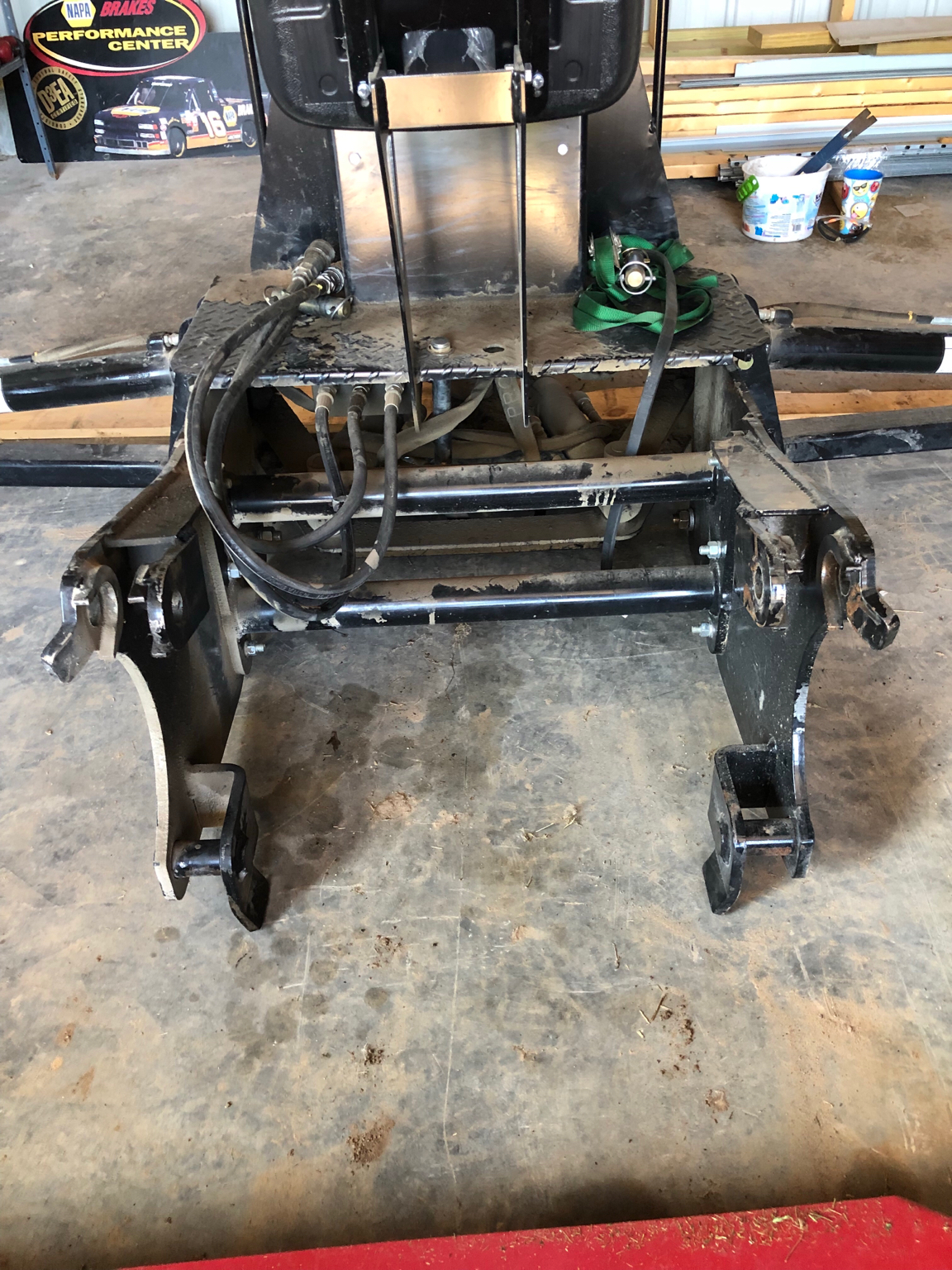

BTW on my tractor the hole bosses are on the tractor and the matching holes and guides are on the body of the hoe. Sounds like exactly opposite of yours.

Yep yours is exactly like mine. See those C shaped guide dohickeys welded to the inside? Those hit the top of the pin bosses when I try to rotate the hoe so the pins will engage the hooks. If they were open toward the bottom instead of directly forward I would not be having the problem with the hoe on the dolly as they would tend to aid not hinder things.

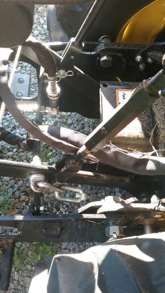

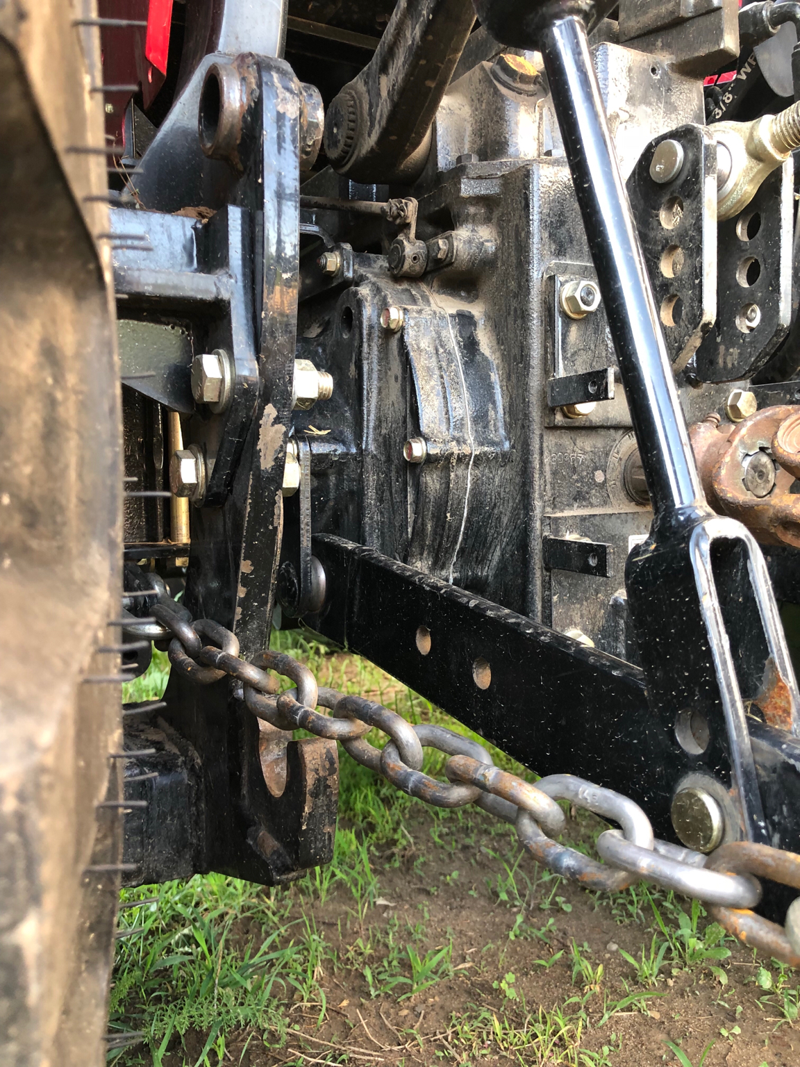

notice the hook below the chain and the top boss... is that the same?
Looks the same.
